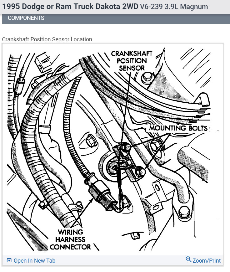

This sounds like the crankshaft angle sensor is not working right which won't leave a code.
Here is a guide to show you step by step how to fix the problem and a diagrams below to show you how on your car.

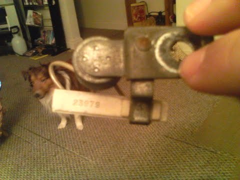

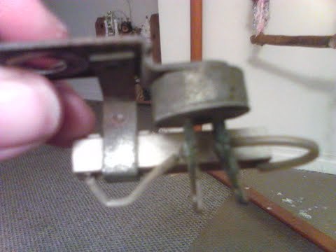

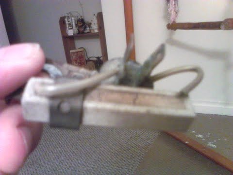

Hi guys, I'm having stalling problems with my '87 Dodge Dakota. It starts up alright (sometimes I have to give it a little gas), idles great, but the second I throw it in reverse or drive it stalls out. I idled for five minutes or so today to see if it was something with the carburetor and it idled fine but then I put it in reverse to back out and it died immediately.
For some background I just bought the truck a couple of days ago for $1k (so I'm not expecting much) but I was hoping it would last me the year. When I picked it up it started just fine no stalling issues or anything, nor had it stalled out the day before when I took it for a test drive. I drove it home 20 miles or so with the low fuel light on (45 mph to like 55mph) but also no stalling issues. However, the very next day I parked it and it started stalling out. Any ideas on what could be wrong with it? I hear low oil pressure or something is common with the 87's but I don't really know a lot about cars/trucks.

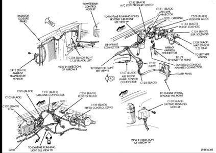

The entire system doesn't go dead, radio, heater/a-c fan still blows, windows all of them work.
The only thing that I can see that goes dead is the ignition and the speedotmeter, maybe the tach, but since the engine stops, it's going to read zero if it's working or not.
I've uploaded 4 images to my website which detail the wiring I think may be involved. I'm thinking that there is more than one wire that gets powered when the ignition is switched to ON. One goes to ignition system/gauges and other for accessories. Maybe one going to ignition system has intermittent loce of connection?
I'm going to keep trying to make it die while at the house so I can climb under the dash and see if one of the wires that's supposed to be hot isn't.

Got it fixed (I think). The speedometer sensor was apparently shorting out the 5v that's running through it, causing the PCM to shut down the ignition system.
Dodge place replaced the sensor and I drove it home and to work a couple times, hasn't died yet.
