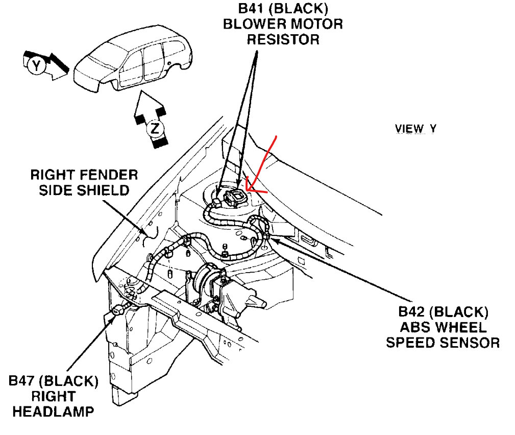

1997 dodge grand caravan SE - 182K miles - where is the location of the blower motor resistor? I have only off and high controls for the heater and I purchased the resistor because I heard it was a pretty simple fix. Thanks!

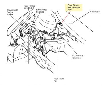

if your referring to fan speed.. Off & High. highly, highly common in dodge products.. let me know what's going on.. Here is the location of the blower motor speed resistor which is solid state. Check out the images (below). Let us know if you need anything else.

The resisto is located on the firewall. at the upper left hand(passenger side) corner, under the cowl. Above the AC lines, and strut tower. It is an easy fix, you may have to replace the plug as well, it may be burnt. This apparently is a common problem in these caravans.

check the connector too they rust and burn
