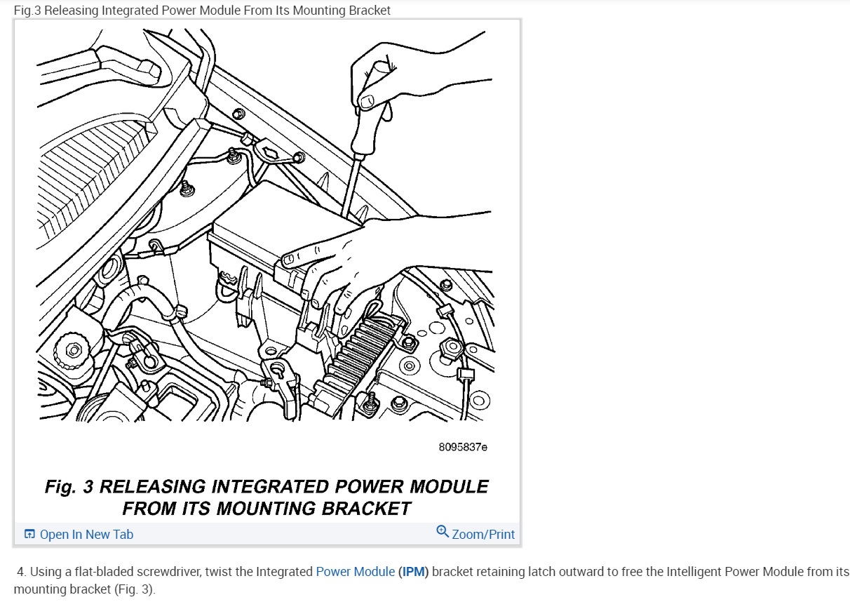

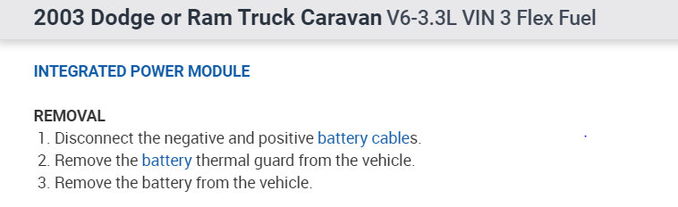

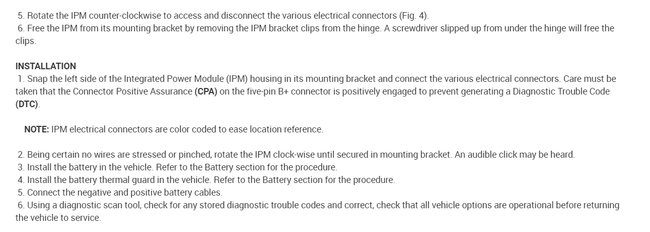

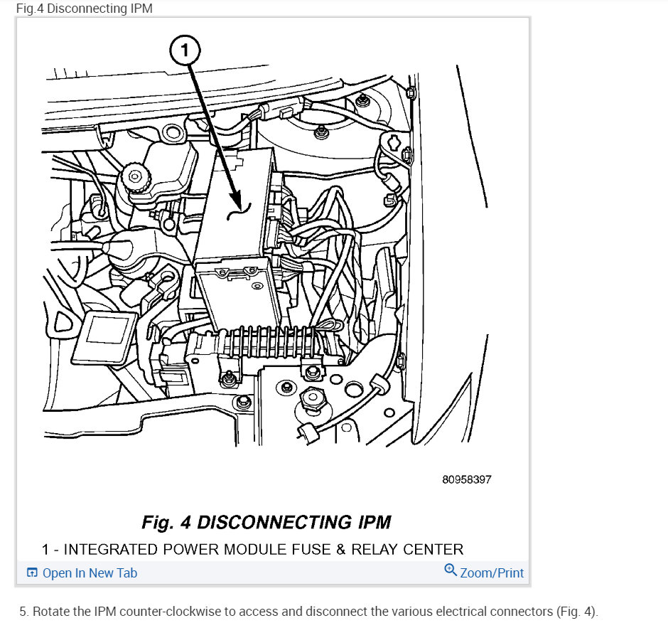

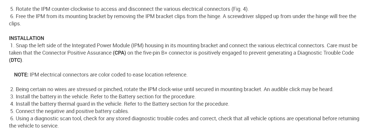

It sounds like the IPM has gone out here is how you can fix the problem.
+1
