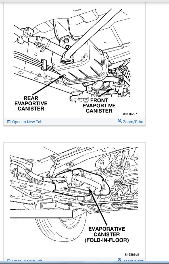

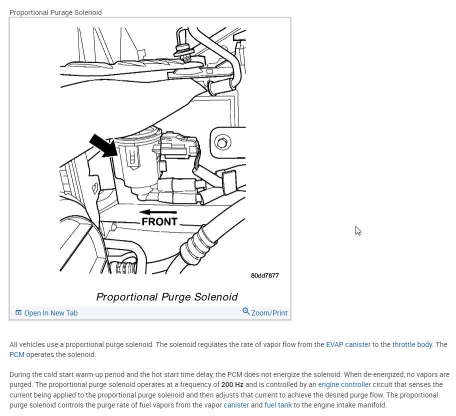

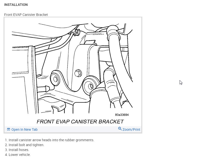

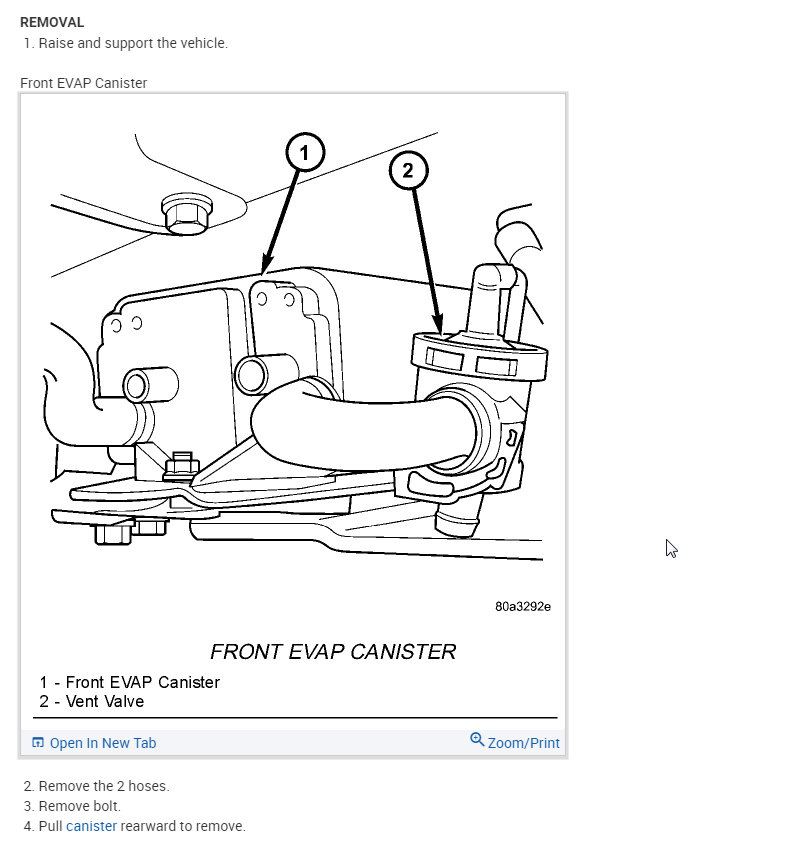

CURTIS BAUM
I think i may have a clogged fuel filter. After i get gas my car will stall most times and have to be restarted but is fine after that.
Dec 17, 2020 at 12:40 AM (Merged)

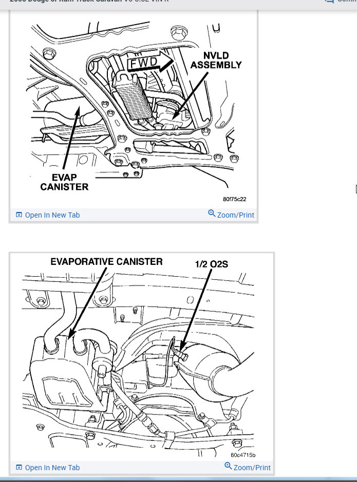

Your fuel filter is in the tank as part of the pump. Plus this is normally not a plugged filter. This is normally raw fuel in the vapor canister. You actually have two canisters but the way these work is that when you fill the tank and under normal operation there is vapor put off by the tank. That vapor is captured rather than put off into the atmosphere for emissions reasons and better fuel mileage.
When the PCM calls for it, the purge valve opens and allows this vapor stored in the canister into the engine. If there is raw fuel in there then too much vapor comes in and it stalls the engine or makes it run rough. This normally happens most after fueling because when it is filling up that is when then most amount of vapor is put off into the system then when you start the vehicle and the purge is opened it dumps all this fuel and vapor into the intake.
I would suggest removing the canister and seeing if there is raw fuel in them. If there is, replace them and the purge solenoid because once these have fuel in them the charcoal breaks down and causes the purge to stick.
Let me know what you find and we can go from there. Thanks

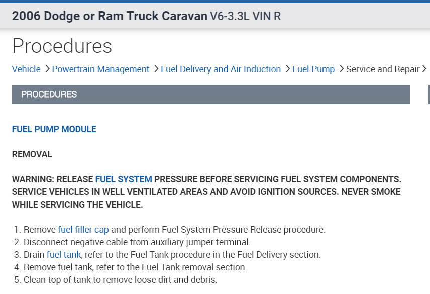

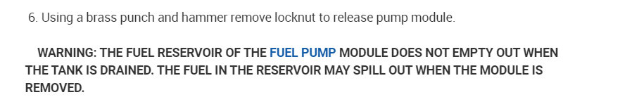

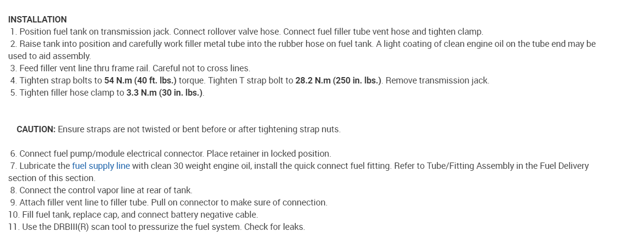

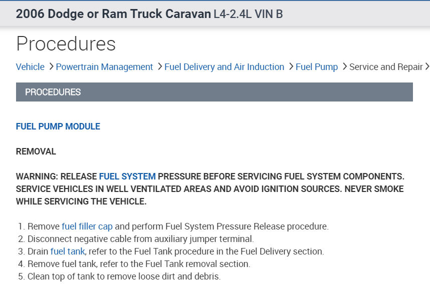

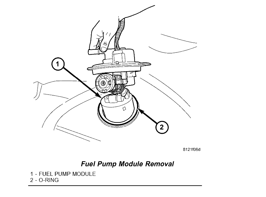

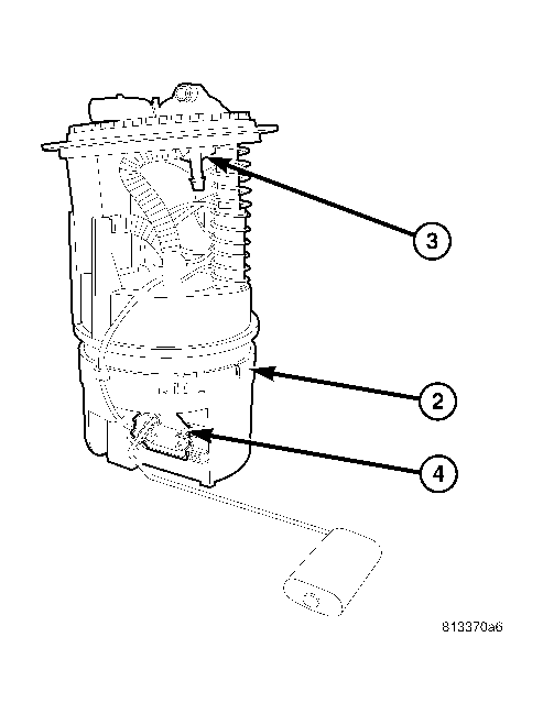

SCGRANTURISMO
  • 4,897 POSTS

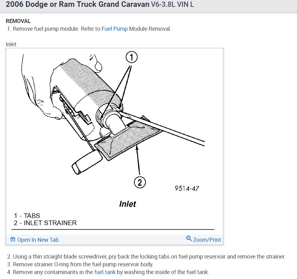

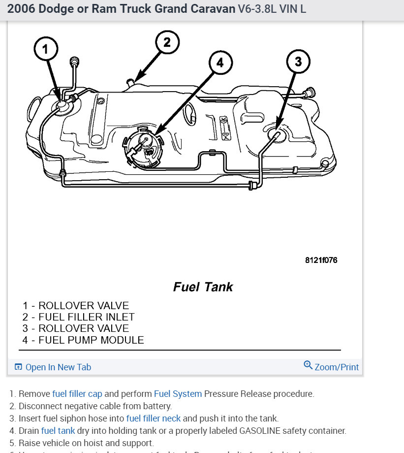

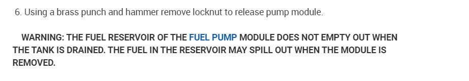

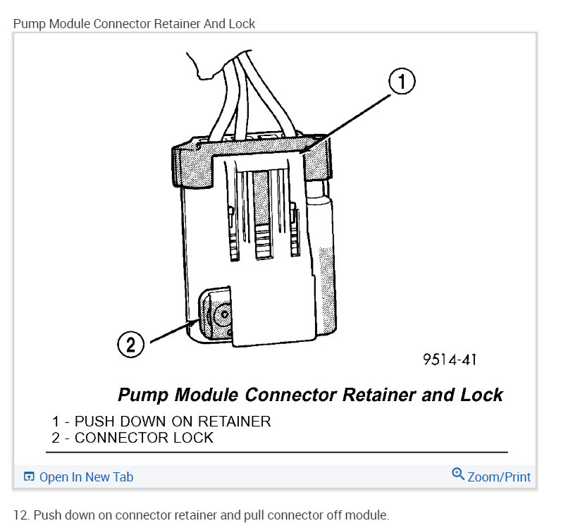

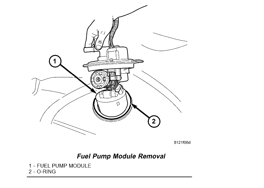

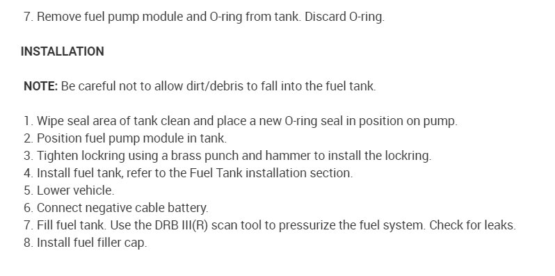

The fuel filter for your vehicle is part of the fuel pump module which is located in the fuel tank. I have included factory instructions for the removal and installation of the fuel pump module for your vehicle in the diagrams down below. Please go through this guide and get back to us with how everything turns out.
Thanks,
Alex
2CarPros

  • 110,240 POSTS
You're not going to like this. It is only replaceable as part of the fuel pump module (in the tank)

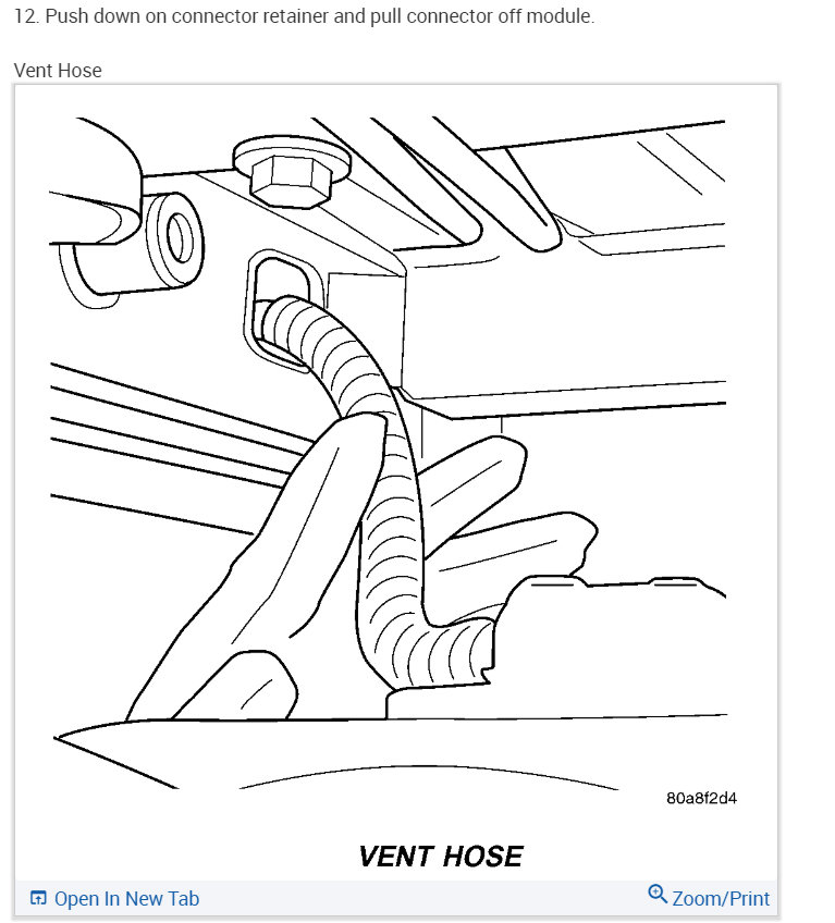

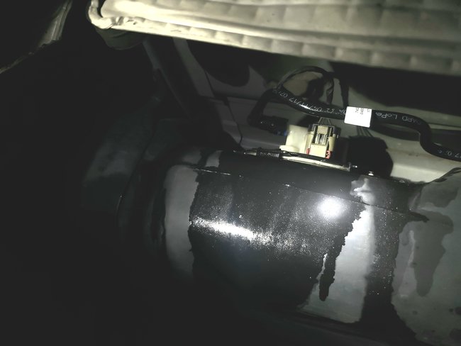

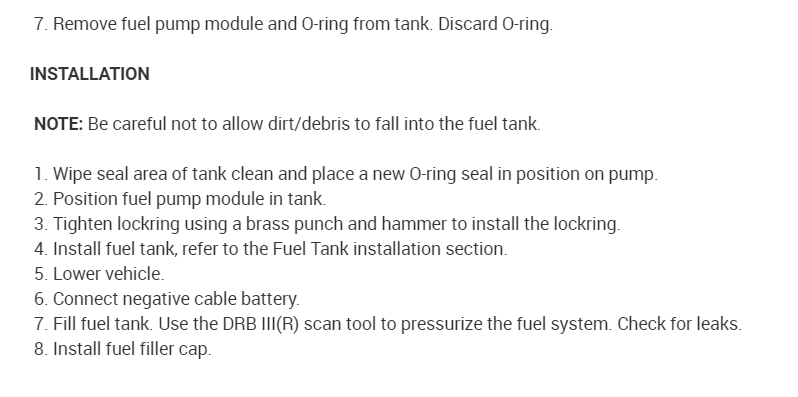

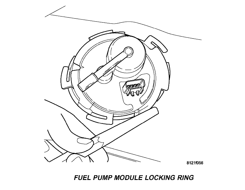

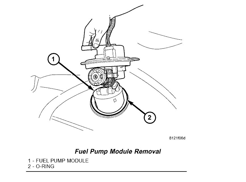

ANNILEI GONZALES
Fuel leaking from sending unit.
SCGRANTURISMO
  • 4,897 POSTS
This sounds like your vehicle's fuel pump module's o-ring gasket has failed. There is a rubber o-ring gasket that goes where the fuel pump locking ring is that seals the fuel tank where the fuel pump module goes. In the diagrams down below I have included the factory guide for the removal and installation of the fuel pump module which will incorporate how to replace the o-ring gasket. Please go through it and get back to us with how everything turns out.
Thanks,
Alex
2CarPros
ANNILEI GONZALES
Okay, I posted pictures changed hose connection thought it was that still no change. can anyone tell me anything else?
SCGRANTURISMO
  • 4,897 POSTS
Hello again,
Please double check the o-ring and make sure that it is seated properly. also ensure that the snap ring is tightened all the way down. You usually have to tap it in place with a rubber mallet and a plastic wedge. Try not to use anything metal, or if you have to use anything metal to tap it in place, do it very carefully and avoid any sparks, obviously because you are working around fuel. If it is still leaking, then the fuel pump module itself must have a crack in it allowing the fuel to get through. Also double check the fuel line connections at the the fuel pump module. Make sure that they are tight and that there are no cuts in the lines themselves. Please get back to us with what you are able to find out.

BMRFIXIT

[quote:d48d602cc1="atxt63"]I have dropped the tank but did not see any lines that matched the replacement filter. Is it inside the tank?[/quote:d48d602cc1]
The fuel filter is replaceable only as a part of the fuel pump module
if what you have has long fuel lines it is for an older model year
Dec 17, 2020 at 12:41 AM (Merged)

where is the fuel filter how do I replace it
Dec 19, 2020 at 1:17 AM (Merged)
  • 110,240 POSTS
The fuel filter is in the tank and part of the fuel pump module. To replace it, the tank needs removed. Here is a picture of the beast:
https://images.2carpros.com/forum/automotive_pictures/249084_gas_1.jpg
I hope this helps. Let me know if you have other questions. Joe
