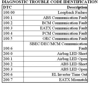

SERVICE WRITER
  • 9,123 POSTS
IT may be an instrument cluster problem, a speed sensor that sends a signal to the BCM and then to the speedometer.
Th test the cluster, do this:
turn ign off , hold trip reset button and turn key on. after five seconds remove key and continue to hold reset button for five seconds. after five seconds release button and self diagnosis will begin.
IF codes show up, match them to this chart:
https://www.2carpros.com/forum/automotive_pictures/30961_carclu_1.jpg
Then we can continue if needed.
