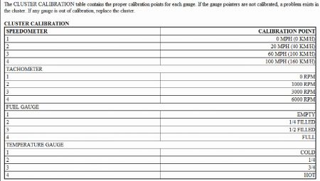

The speedometer needle on my Caravan is now below the peg. It hangs down to about the 7 oclock position. When I open the drivers door it jumps up to about 1/16 inch below the peg. When I turn the ignition switch on it moves tight up against the peg. Odometer still works. No warning lights. No other problems.
Aug 27, 2008 at 4:56 AM
MERLIN2021
  • 17,250 POSTS

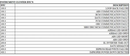

DIAGNOSIS AND TESTING DIAGNOSIS AND TESTING - SELF-DIAGNOSTICS The instrument clusters are equipped with a self diagnostic test feature to help identify electronic problems. Prior to any test, perform the Self-Diagnostic Test. The self diagnostic system displays instrument cluster stored fault codes in the odometer display, sweeps the gauges to the calibration points, and bulb checks the warning indicators. When the key is in the ON position with the engine not running, the MIL will remain illuminated for regulatory purposes. To activate the Self-Diagnostic program: 1.With the ignition switch in the OFF position, depress the TRIP ODOMETER RESET button. 2.Continue to hold the TRIP ODOMETER RESET button until Sof and a number (software version number (i.e. Sof 3.2 ) appears in the odometer window then release the button. If a fault code is present, the cluster will display it in the odometer display. When all fault codes have been displayed, the cluster will display "end" in the odometer display. Refer to the INSTRUMENT CLUSTER DTC'S table to determine what each trouble code means.
https://images.2carpros.com/forum/automotive_pictures/62217_Clustera_2.jpg
https://images.2carpros.com/forum/automotive_pictures/62217_Clusterb_3.jpg
Aug 27, 2008 at 9:21 AM
DAN5667
Ran the Trip Odometer Reset procedure. The system ran the cluster calibration and everything is back to normal.

QUICK TEST 1. As a quick diagnosis, instrument cluster will perform a function check immediately after ignition is switched to RUN/START position. Electronic display, odometer/transmission range indicator and all warning lights EXCEPT low fuel, cruise, high beam, fog lamps and turn signal will light for a brief period. 2. If cluster is not receiving CCD bus messages, cluster will appear non-functional except for the continuously illuminated air bag indicator, and NO BUS message displayed. If instrument cluster in not receiving CCD bus messages, see appropriate VEHICLE COMMUNICATIONS article. © 2008 Mitchell Repair Information Co., LLC. CAUTION: When battery is disconnected, vehicle computer and memory systems may lose memory data. Driveability problems may exist until computer systems have completed a relearn cycle. See COMPUTER RELEARN PROCEDURES article in GENERAL INFORMATION before disconnecting battery. WARNING: Disconnect negative battery cable BEFORE servicing instrument panel. When power is required for test purposes, reconnect battery for specific test purpose ONLY. After specific test is completed, disconnect negative battery cable before continuing servicing procedures. Page 1 of 1 INSTRUMENT PANEL - ANALOG -1996 Dodge Intrepid 3/15/2009 http://www.ondemand5.com/mric/common/asp/printart.aspx
Should reset by itself when you turn the key to start.
If not it needs to be scanned, but I would try removing the fuse for the cluster and leave it out for a minute and reinstall it, then retry the key. If that doesnt work, remove the neg battery cable leave off for a minute and retry.

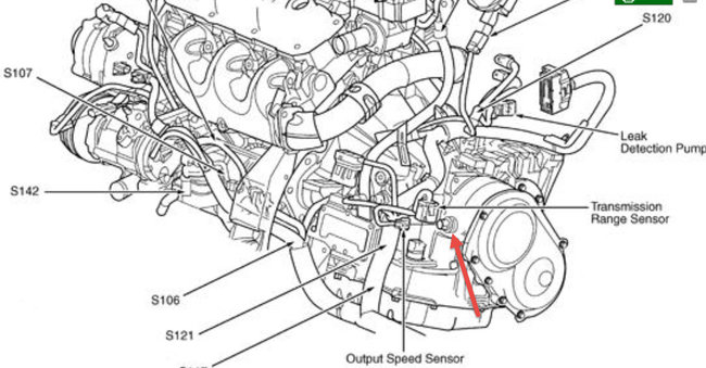

I gave you's the wrong codes it]
Definition- Code P0700 indicates a Transmission Control System(MIL Request)...
ERROR CODES READ-
P0700 Automatic Transmission Control System Malfunction...
P0720 A/T Output Speed Senor-Low Output Above 15 MPH
Feb 24, 2017 at 6:22 AM (Merged)
HMAC300
  • 48,601 POSTS
if you want you can replace the speed sensor the 700 code is a generic code for transmissions it may be aharness problem or tcm which a trans guy should check because it could be more like I said previously. pic shows where speed sensor is. also check the wires. I will be on vacation if any other questions so repost this question if you have other ones.

On my 03 caravan sxt the speedometer goes to 20 mph as soon as I put it in reverse or drive, tried the reset function and get e codes 100.2 100.6 and 400.1 what can I do to fix? Problem started when battery went dead and temp, fuel, and speedometer all went hay wire, fuel and temp back to normal.
HMAC300
  • 48,601 POSTS
check battery for condition including load test then have a pro scan for codes. you have some sort of communication fault it may be because of low battery/dirty terminal ends or there is a short in system

ROSIE FRANCO
  • 9 POSTS
I got the output speed sensor fix it doesn't jerky anymore ...but speedometer still moves back and forth...should I get the input sensor fix too
Feb 24, 2017 at 11:59 PM
  • 55,579 POSTS
If the speedometer moves a little then I would let it go. But if it bothersome then get it fixed.
