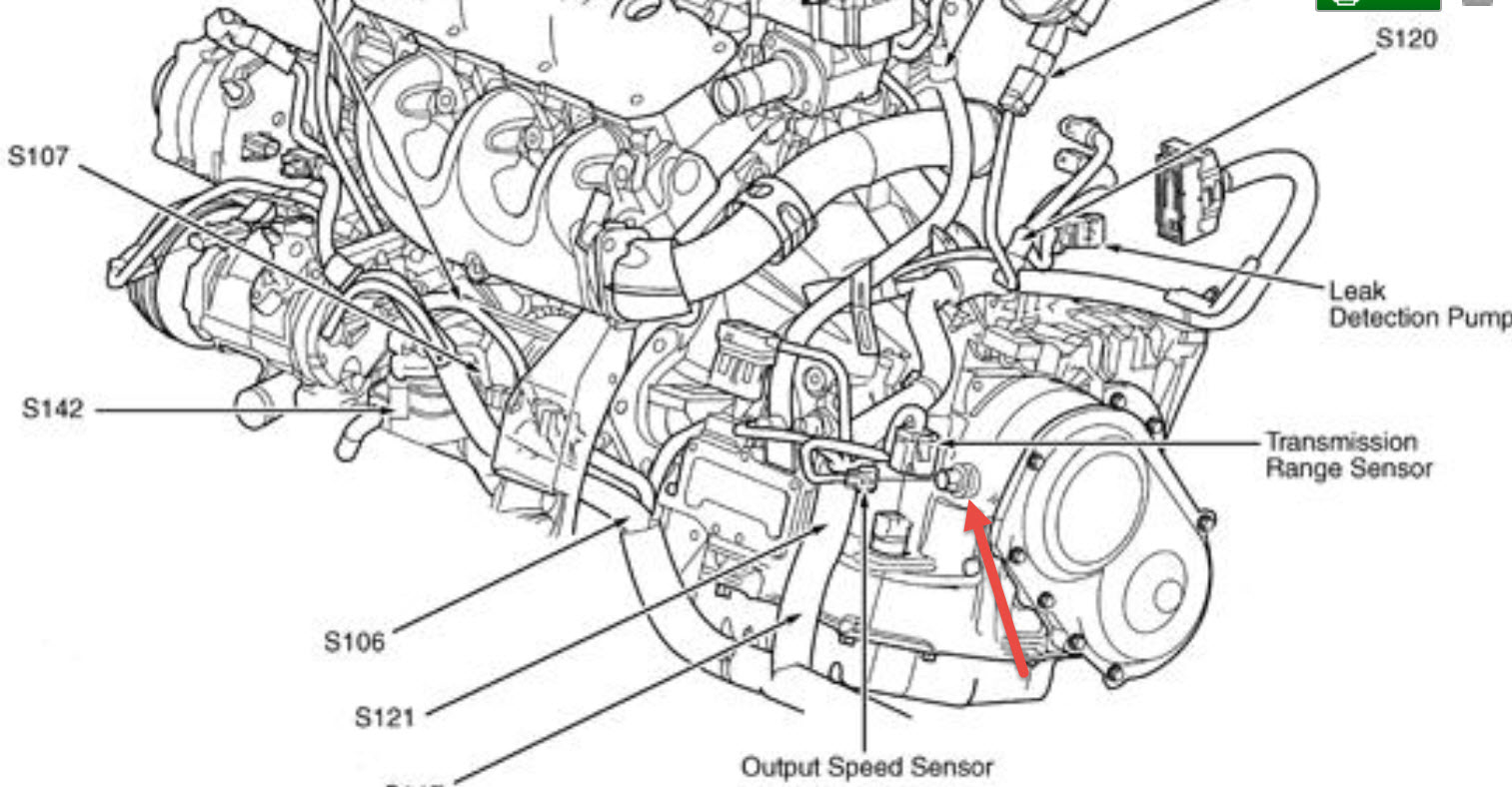

If you want you can replace the speed sensor the 700 code is a generic code for transmissions it may be aharness problem or tcm which a trans guy should check because it could be more like I said previously. Pic shows where speed sensor is. Also check the wires. I will be on vacation if any other questions so repost this question if you have other ones.

Interior problem
2003 Dodge Caravan 6 cyl Two Wheel Drive Automatic 55000 miles
Today I ran an errand and the speedometer was working fine. I parked and when I got in to head home, the speedometer no longer worked. The needle is all the way past the upper zone and is resting against the post that holds the needle below zero. Every other gauge works fine. Is this an easy fix or not? We know very little about cars and want to go to a mechanic with some idea of what needs to be done - thanks!

This sounds like a classic vehicle speed sensor problem. Please replace the sensor and get back to us.

ROSIE FRANCO
  • 9 POSTS
I got the output speed sensor fix it doesn't jerky anymore. But speedometer still moves back and forth. Should I get the input sensor fix too

KEN L
  • MASTER CERTIFIED MECHANIC
  • 48,363 POSTS
If the speedometer moves a little then I would let it go. But if it bothersome then get it fixed.
