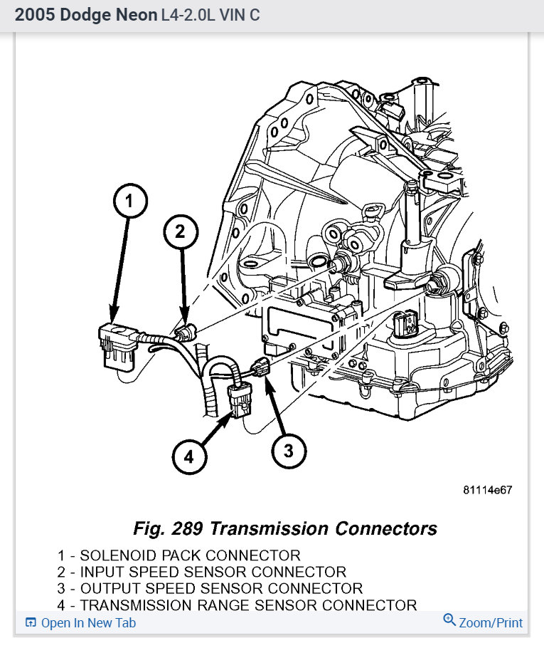

Had a weak battery and when trying to start engine, speedometer went nearly all the way around the gauge. Now speedometer does not work at all and trans does not shift correctly. I had problem with trans once before and had to change transmission brain. I don't think that is the problem now and I am leaning toward a faulty speed sensor but I am not sure if I should change input or output side
Sep 9, 2010 at 10:18 AM
  • 110,194 POSTS

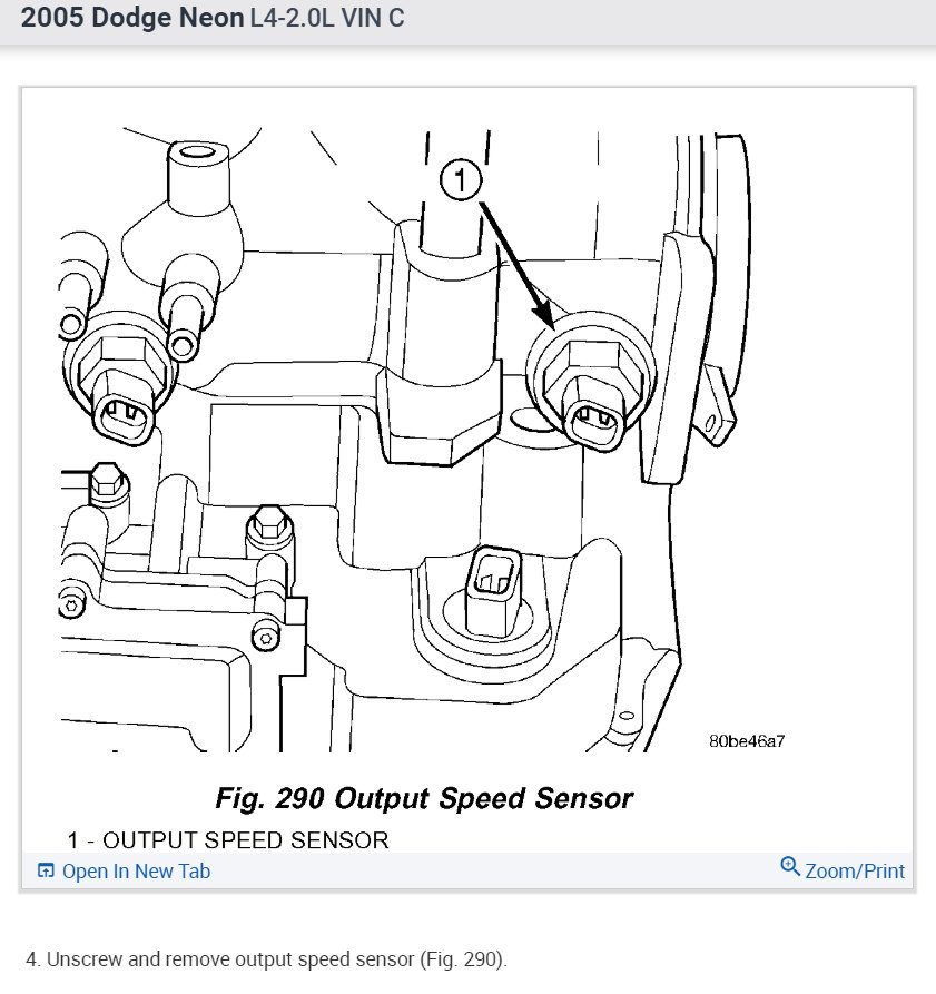

If they both are not working properly, I would say the speed sensor. Here is the location so you can change it out. Same as a Neon. Check out the diagrams (Below). Please let us know what happens.

I changed the input and output sensors on van and speedometer still dont work. where is the third located.?
glenn morris
Aug 29, 2019 at 2:11 PM (Merged)
BILLYMAC
  • 2,204 POSTS
the third which is a speed sensor is located at the output side of the transmission.right where your axles go in to the trans .you will see the sensor and plug billymac

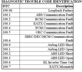

There is a self test to find this.
with the ignition off, depress the "trip odometer reset button". Hold it until Sof and a number comes up. that is the current software version. Then release the button and it will give a DTC. This code number is what I need. it will be 400.1 or 200.6 etc.
This self test may make it work again.

IT may be an instrument cluster problem, a speed sensor that sends a signal to the BCM and then to the speedometer. Th test the cluster, do this: turn ign off , hold trip reset button and turn key on. after five seconds remove key and continue to hold reset button for five seconds. after five seconds release button and self diagnosis will begin. IF codes show up, match them to this chart:
https://images.2carpros.com/forum/automotive_pictures/30961_carclu_1.jpg
Then we can continue if needed.
