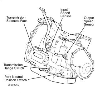

217000 km. After starting my van, spedometer stopped working, and my transmission is stuck in 2nd gear, my service light came on. (I read that this is a LIMP mode).
I took out the speed sensors, and on one with a magnet on the end were metal shards, so i cleaned that and hopping that this will solve the problem, but nothing happened. I tried to get a code and it shows code 23 (intake air temp. sensor voltage low or high) and 55 (should be end of the codes), but as far as I know my engine doesn't have intake air temperature sensor. (3.0L V6 Crysler). I did a instrumentation diagnostic (test) and all gauges all working, the speedometer also. My engine oil is still red. Im still stuck in LIMP mode.

Hi Trans has two speed sensors input and output. see figure Faulty output will take out speedo and put trans in limp-in mode. Your van has OBDII go to an Auto Zone have codes read. then post will advise. Hope this helps Thanks for donate

Replace the two sensors check wiring and ground wire

Replace your input and output speed sensors, located on top of the transmission. Both should cost you around $40.

SOLVED
Replaced the output sensor ($28 OEM) and works fine now.

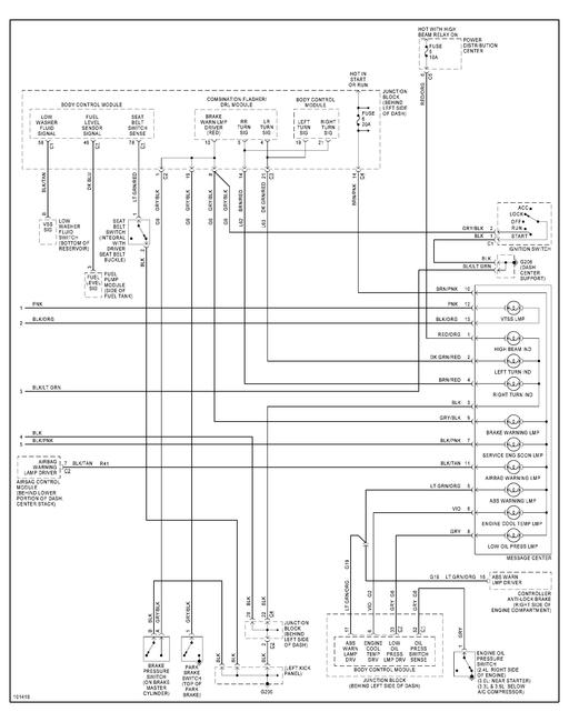

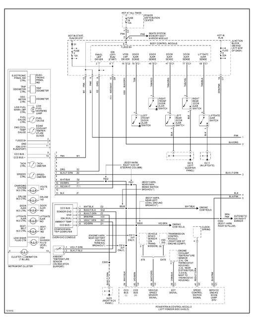

GWSHELL819
Please help dont need another ticket. Doesn't read speed until about 20 mph. Self chech showed no reading in 1. 2 moved to 50. 3 went back to zero. I just resoldered cluster because gauges weren't working. Bad solder points on back fixed but now speedo doesn't work correct. Did solder something I shouldn't have or do I need to check for more. Any pictures of cluster soldering properly ?
Aug 29, 2019 at 7:12 AM (Merged)
CJ MEDEVAC
  • 11,000 POSTS
Sounds like mr. Cluster has had it!
I just looked on ebay for you......i saw 5 right off of the bat.....ranging from $54 to $150
I did not know the "specifics" of your van so i couldn't get closer
The medic
HMAC300
  • 48,601 POSTS
they can rebuild the dash for around $150-175 then it will need reprogramming by a mechanic
GWSHELL819
Thank you much but im Trying to fix this one. It worked fine until I tried fixing the bad solder. Short on money just need a diagram to figure out what I did wrong or still need to do.
CJ MEDEVAC
  • 11,000 POSTS
I fear you may have heat damaged some sorta cyber device in it
There were 2 other choices on "caravan" in "mitchell i"......not to mention the grand caravan stuff..........engine size did not enter in with my search
................i picked plain jane "caravan" when i grabbed you these diagrams
This is "instruments 1 of 2" and also "instruments 2 of 2"
Good luck, lemme know how it goes
The medic
Aug 29, 2019 at 7:13 AM (Merged)
MAXIMILIAM
  • 436 POSTS
Thank you for the diagram it should help. Any place I could find a picture of the instrument cluster board ? (Actual picture. ) that would be most helpful. Thank you again.
