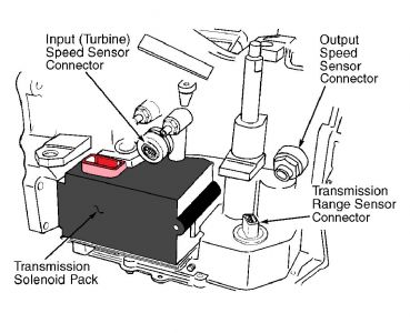

You need to scan for codes I would say you need new cluster panel It will not effect the shifting as for the tranny not shifting 95% its the solenoid pack on the side of the tranny
https://images.2carpros.com/forum/automotive_pictures/99387_caravan_tranny_4.jpg

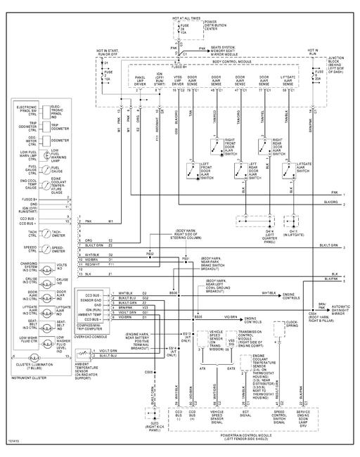

Cluster problem is a very common on them caravans and most common to fail is the connector pins and solder on the circuit board
to determine if its a speed sensor or cluster issue need a help of a scanner tool where you can plug it in and what the speed on the cluster when it s start acting up if speed on the scanner doing the same
you have problem in the speed sensors replace them both
if speed steady on the scanner and not on the cluster ,problem inside the cluster

In 95 3 main computers were tied to gether on communication wires. Body, engine, and transmission.PCM, TCM, BCM, each has self diagnostics. The speedo gets it's signal from the vehicle speed sensor, the tach gets it's signal from the two sensors on the transmission(input and output) the voltmeter is driven by battery charging voltage by the body computer which drives the instrument cluster. If your having problems with any one of the three this could occur. What does the dealer say about the DRBIII they use to read all these systems. There may be a code for a bad TCM or BCM. They have bulletins regarding cluster ground problems also. Have you ever taken it in to the dealer so they can see if any fault codes are present? I think you may have a problem with the instrument cluster itself. A bad circuit board or ground or poweer wire in the connector behind the cluster. This was a common complaint. If I see any bulletins regarding this I'll let you know. Bulletin 08-07-94 Rev. B deals with the plug wires interfering with the input sensor wires causing bad signals, a bulletin 08-77-94 is for vehicle speed sensor problems causing speedometer flucuations the new part number was 4707386. The TCM had problems also bullrtin 08-15-99 is for reprogramming the TCM, which gives tachometer information that is used for shifting and by the BCM for the cluster.

The 1988 model, (like mine), was the last year they still used a speedometer cable. '89 and newer models used the Hall Effect three-wire speed sensor with no speedometer cable on the three-speed transmission, and two separate speed sensors with the four-speed transmission. If your four-speed is shifting fine, the speed sensors are working.
The first thing you need to observe is if the odometer is working. If it is, that limits the problem to the instrument cluster. If it is not, the problem could be in the Transmission Computer or the instrument cluster.
The next step is to use a scanner to see if the Transmission Computer is updating the current mileage, then see if the instrument cluster is updating.
