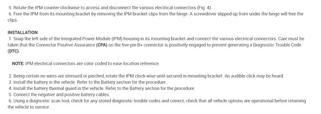

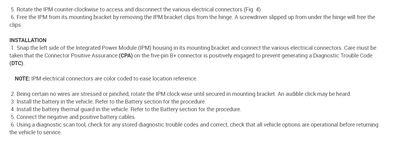

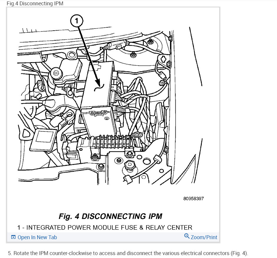

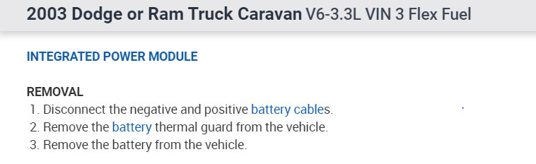

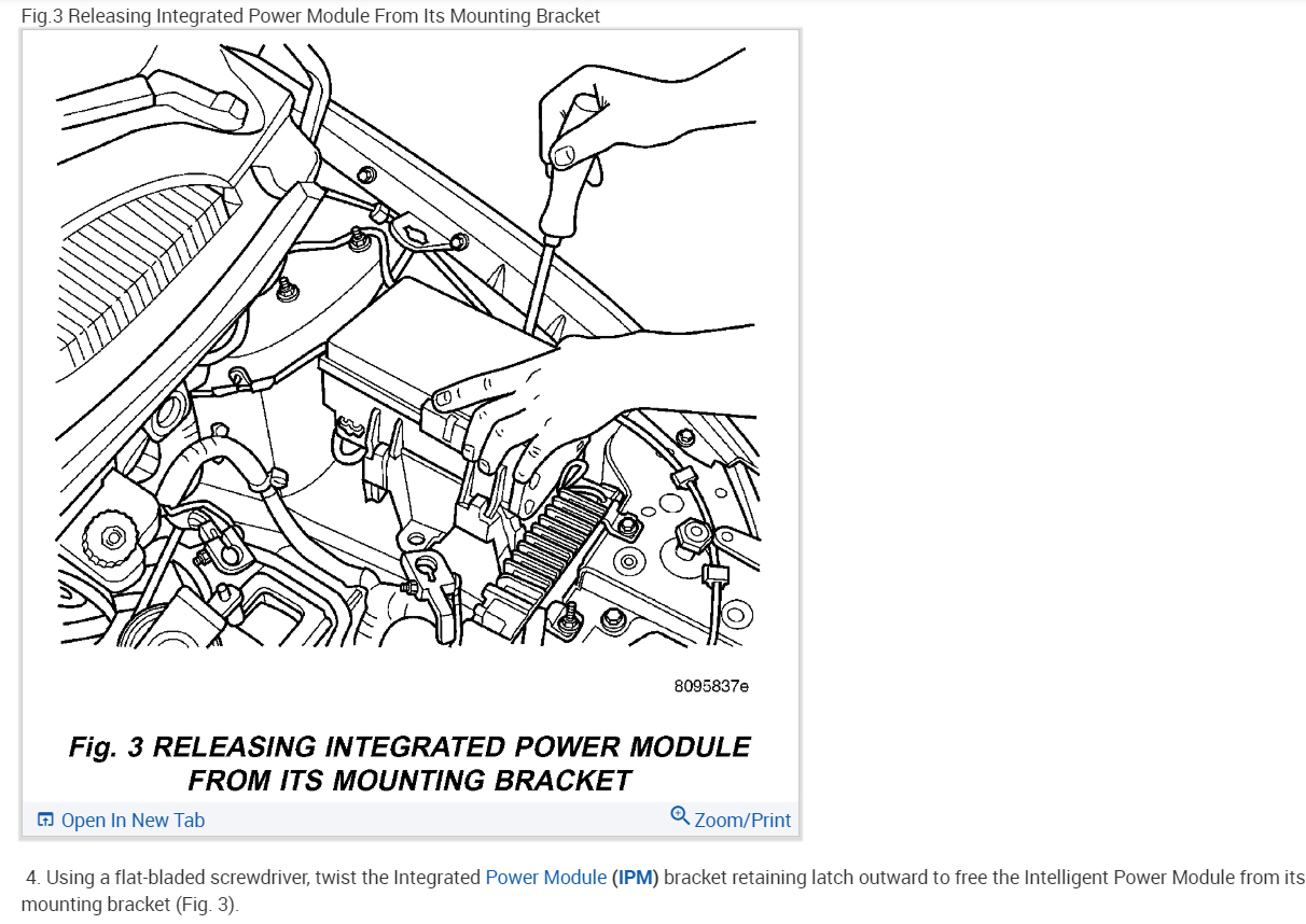

first the blower motor stopped working, then windshield wiper blades wont turn off when in off position (acts like its on a low setting) then right side power window goes down, but not back up... then speedomoter and odometer stops working (but not the other gauges) and when taking apart the right side door to get window back up... motor appears to not work even when connecting to power source... BUT.. suddenly after putting the door back together, NOW you can hear the motor. OH yeah, at same time speedometer and odometer stops working, also noticed front heater/fan/defrost doesn't work.... but the back fan and heater does.. ???
Dec 1, 2009 at 12:15 PM
CH112063
  • 1,320 POSTS
This is typical when the TIPM goes out which is common here is how you can replace it which is easy because it self initializes. Check out the diagrams (Below). Please let us know what happens.
