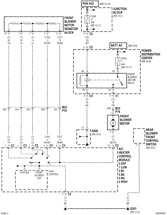

70% of the time the A/C fan in our van works without hesitation. Over the last two months it has been glitchy. We will start the van and there will be no blower fan in any mode we try. The fan kicks in as soon as we reach about 45 miles per hour, and is fine for days after that, turning on and off with no problem. Is there a capacitor on the fan motor that may be going that would make the fan not kick in until it is spinning already by the flow of outside air, or is there another obvious problem I am overlooking? Thank you for your time.

It could be a couple things. First you need to check for power to the motor when it doesn't work. If you're getting power, replace the motor. If no power, move to the blower motor resister. Check for power out there. If power in and none out, replace the resister. If no power to the resister, move back to the switch and check for power in and out. Replace the switch if there is power in and not out. If no power to the switch, you need to trace the power supply to find a bad wire or connection.
This guide will help show you how to runt he test to see what's wrong.
https://www.2carpros.com/articles/blower-fan-motor-works-on-high-speed-only

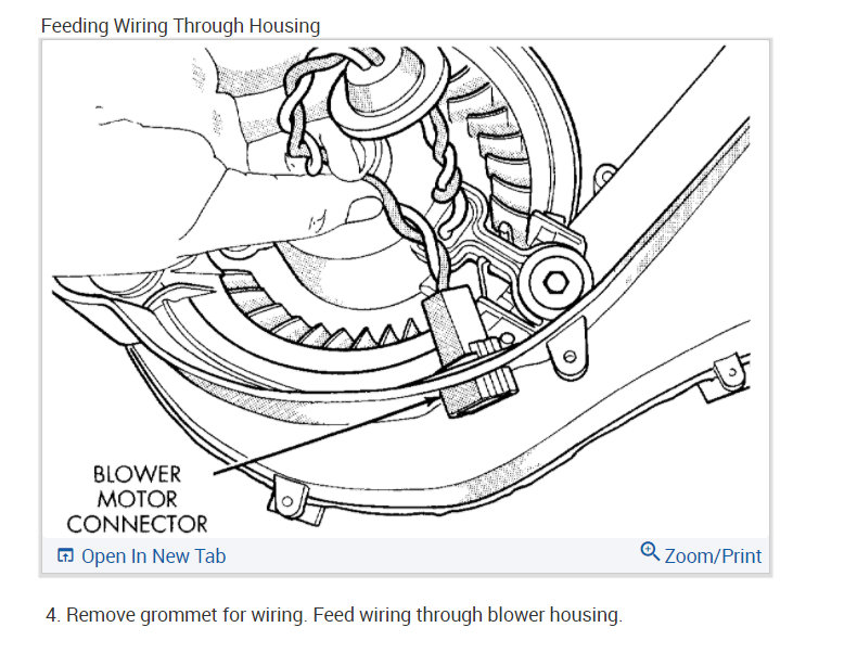

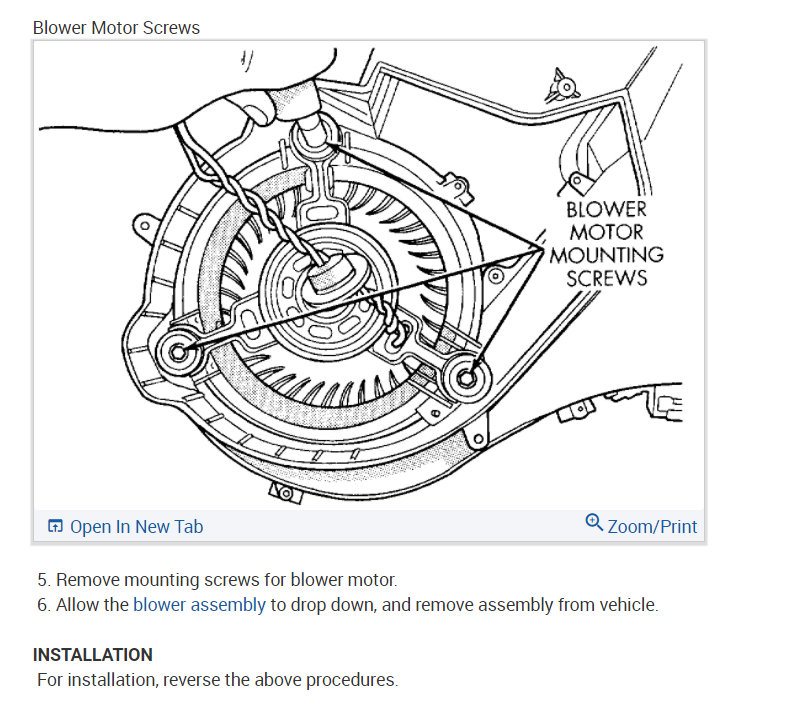

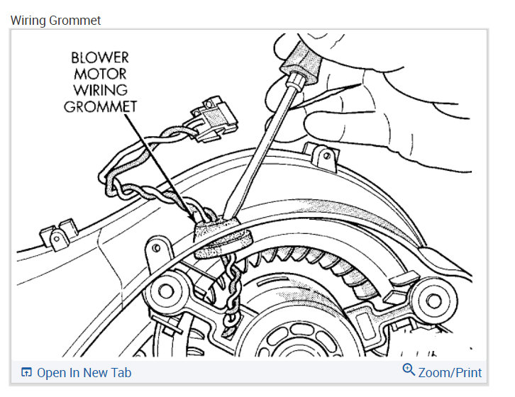

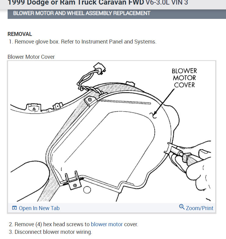

Here is the blower motor location so you can replace it. Check out the diagrams (Below). Please let us know what you find.

i replaced the switch control panrl and the resistor but still have no blower. the compressor is working

The system was straight wired I rewired and put the correct control unitl or relay as per ingo .I have no power to the blower resistor also the control panal buttons are flashing even after running the recalibration mode .I am a retired mechanis and received answers all around the problem no real info just people wanting me to replace things no info on the problem.
Nov 3, 2020 at 1:54 AM (Merged)
here is a wiring diagram. where are you loosing power??
I know you have been everywhere but it is very difficult to diag something you cannot see or touch
JLELANDTHOMAS
Hey Thanks for the clear diagram .I found that behind the control panel was another wire they had by passed .Thanks to the clearer diagram I was able to trace it out .It seems when we don't do these things every day anymore we loose track of it .But I am back on track with this one
