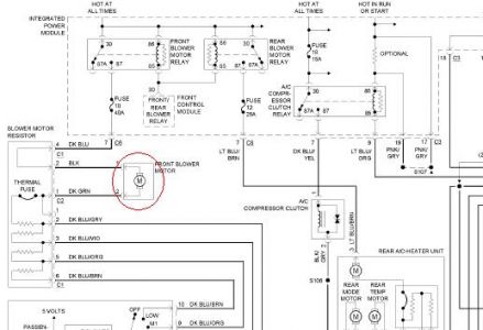

JDL
  • 16,098 POSTS
https://images.2carpros.com/forum/automotive_pictures/170934_blower_motor_2.jpg
Hello, I came across the above info, hope it is readable.
