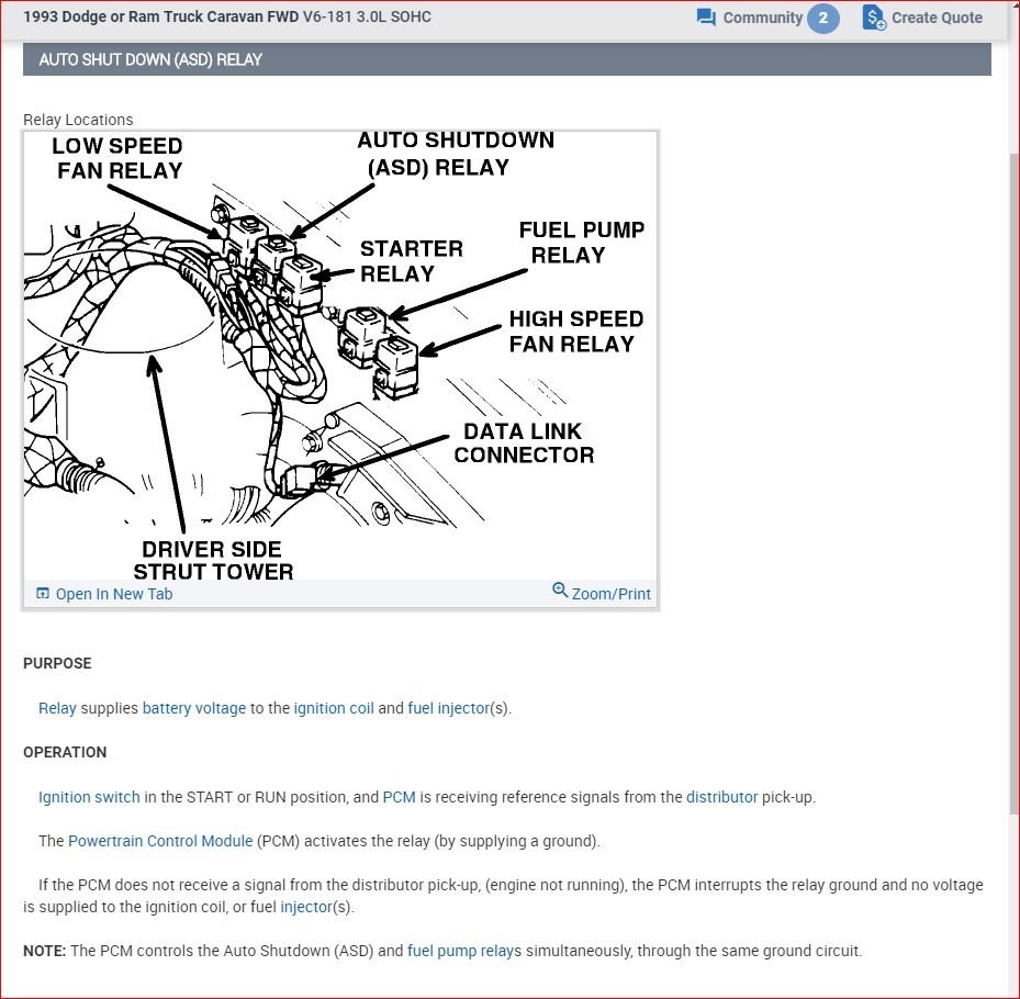

Just quit running, and I tested and found that no current to the coil and no fuel pressure. I replaced the sbec computer, nothing change. Can any body help me?
Monday, September 21st, 2020 AT 6:53 PM (Merged)
Hi Marin,
Have you checked the Auto Shut Down relay? This relay is controlled by the PCM and will cut power to the injectors and ignition coil if the PCM sees an issue. However, the relay itself can fail and you will lose power to the fuel system and ignition system.
Here is a little more detail about it. Please let me know if this is not it and we can go from there. Thanks

I have replaced the auto shut down relay in my van and it does the same. Just cranks normal but does not start. I am thinking, but not sure if replacing the pick up coil in the distributor would solve the problem?

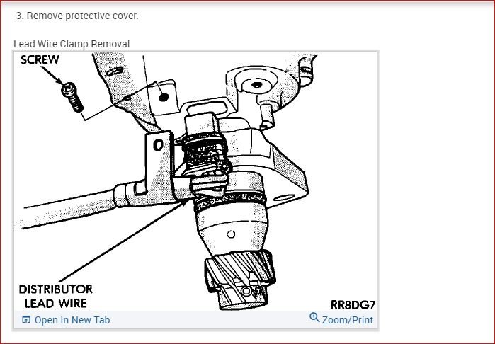

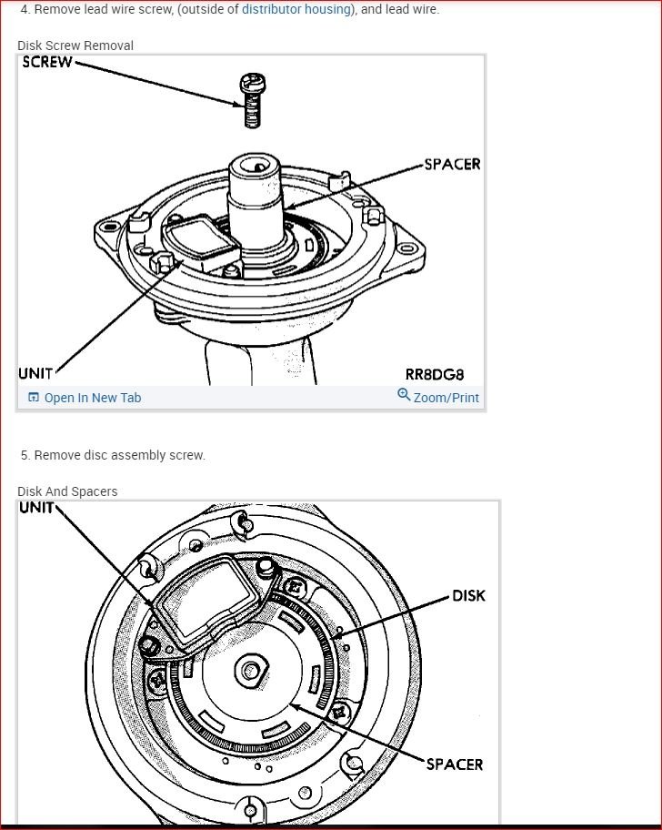

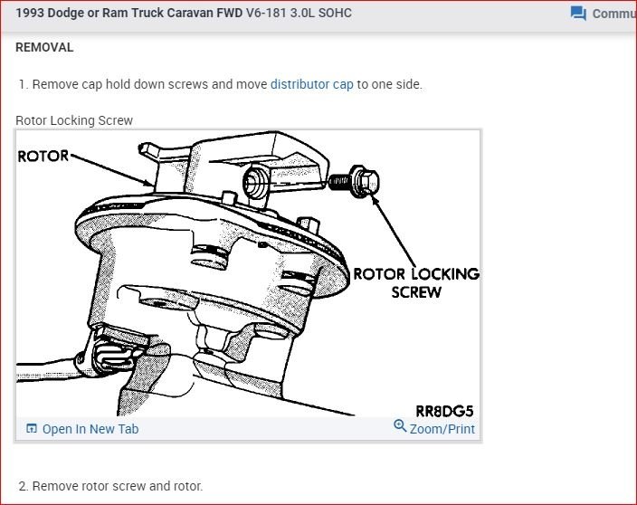

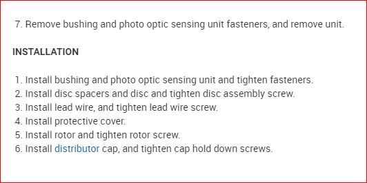

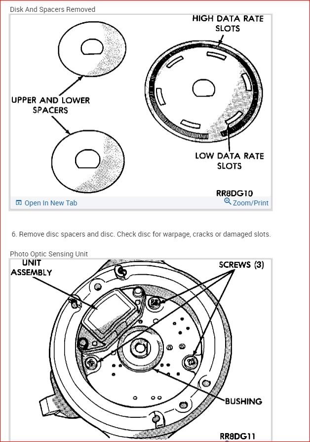

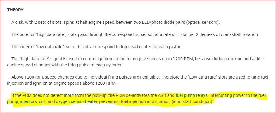

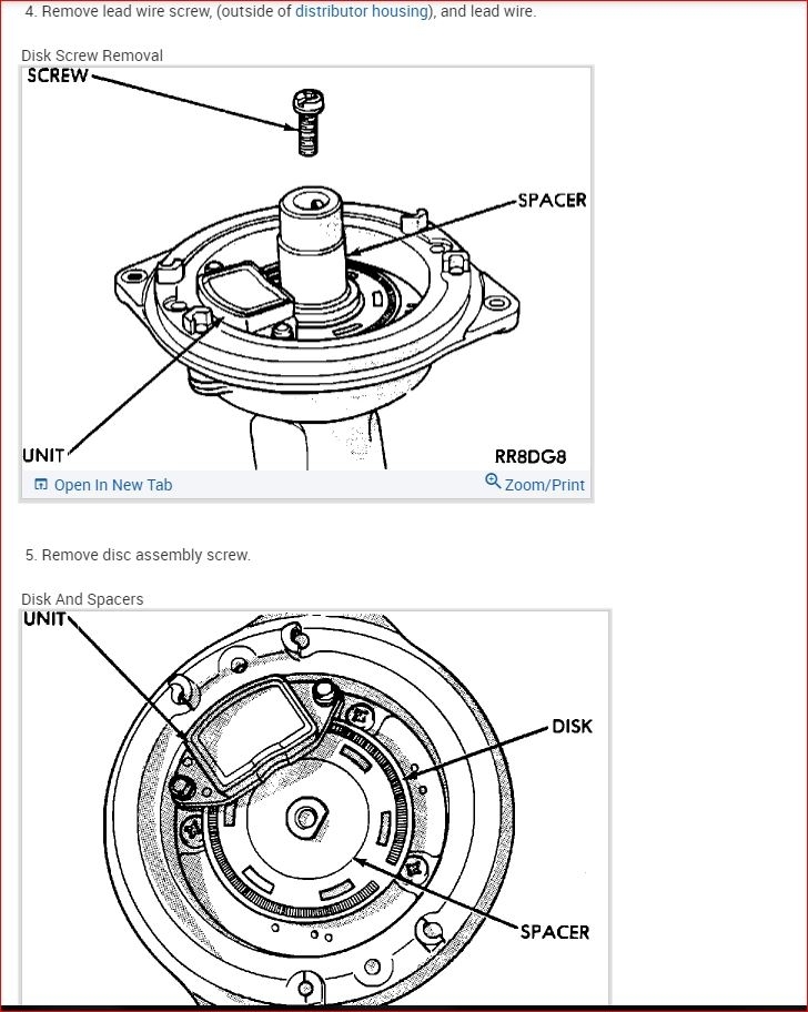

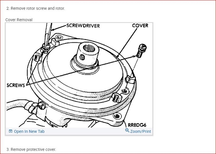

Okay. I am not sure why I didn't pick up on this earlier when you mentioned it. The pickup in the distributor is used to determine crankshaft position. If the PCM is not getting this signal it will shut down the ASD, fuel pump relay, and ignition.
I am pretty confident that this is your issue. Here is the procedure to replace it in case you need it.
Please let me know how this turns out. Please notice the highlighted portion of the first attachment that will pretty much confirm this.
Sorry, I am not sure why I overlooked this earlier.

I dont have any voltage to the distribuitor, with my light tester connected to batt. Ground, looking for any current, nothing.
At all.

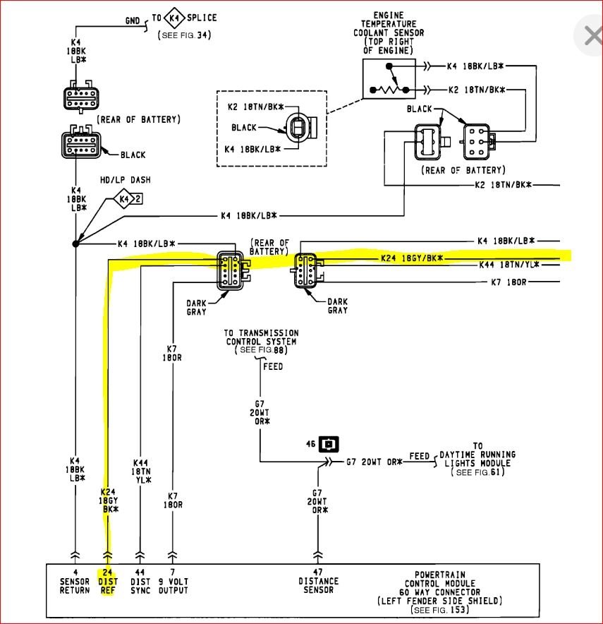

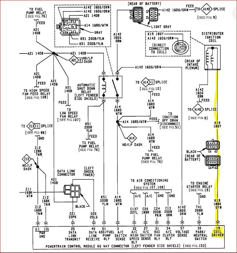

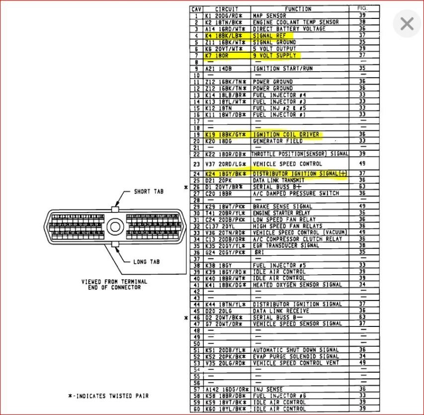

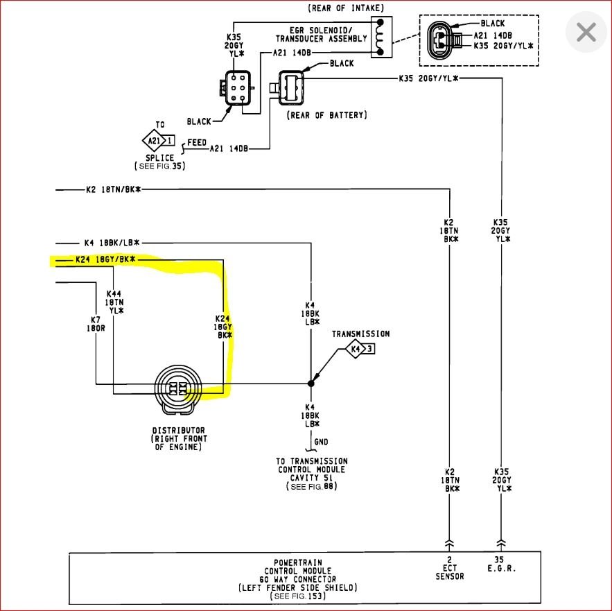

If you have no voltage on any of the circuits then have you checked the inline connector from the PCM to the distributor/coil? Each of these circuits run through the inline connector that is at the rear of the battery.
I highlighted a few of the circuits. Specifically the coil driver circuit (this delivers the voltage for the primary side of the coil), the 9 volt supply circuit for the distributor, and the signal return which is what the PCM needs to fire the injectors and coil.
Take the connector apart and see if there is any water intrusion or burn marks that indicate a short circuit.
Worst case, I would measure voltage coming out of the PCM for the 9 volt supply and driver circuit and see if you have voltage coming out. I suspect you will and if so, just cut the wire and run your own wire directly to the distributor. Do this for each wire and that will ensure you have power and return.
Let me know what you find.

I set my multi-meter in volts(v) and the reading is -12.3 volts black and gray wire to the coil, and -12.3 in the green and orange wire to the coil, then I connect back the coil and tested the connector to the distributor, the four wires give me a reading - 0.1 volts. So I am not very familiar with the multi-meter, I may not read correct, that's what I try my best. Thanks amigo for be patient with me.
Is there a way that you can get a quick video showing how you have the meter hooked up because I think I am missing something? If you have power to the coil, which it sounds like you do, then you just don't have the signal to deliver the spark which would be the distributor. It is actually the pick up inside the distributor but I would expect you to at least have your supply power which is why I want to see how you have it hooked up.
