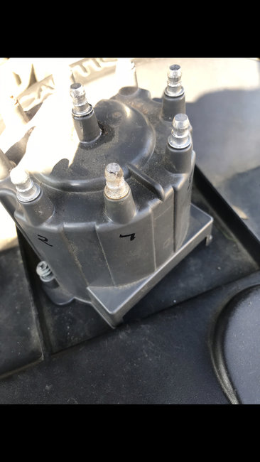

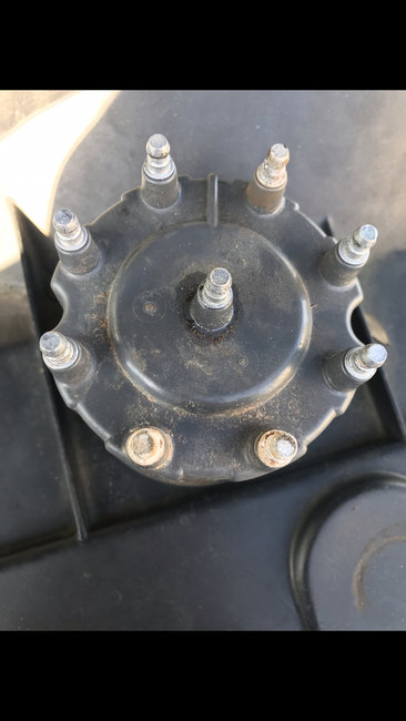

Hi, on my truck listed above K1500, the guy that did the motor on my truck put the distributor in wrong. I cannot figure out which plug goes to which cylinder. Is there a way to figure it out. Also, I was having bad problems with the distributor and rotor. The rotor was burnt and the distributor pegs were fouled badly. I will post pictures later. When I was cranking the truck there was a little fire that started that came out of the throttle body. I assume from the wire not being in the right place. I had sprayed the throttle body with carburetor cleaner before changing the cap and rotor out. The other thing was he did not tighten down the distributor so when I put pressure on it it moved so I know the timing is off now. I am past the warranty now. I do not know why he did not set the distributor in right or tighten it down. Do you know where I can find the right picture so I can see what one should be at? so I can start there and try and figure this problem out. Thanks.

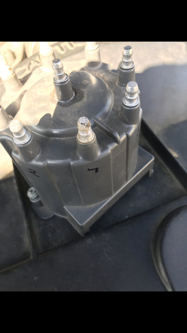

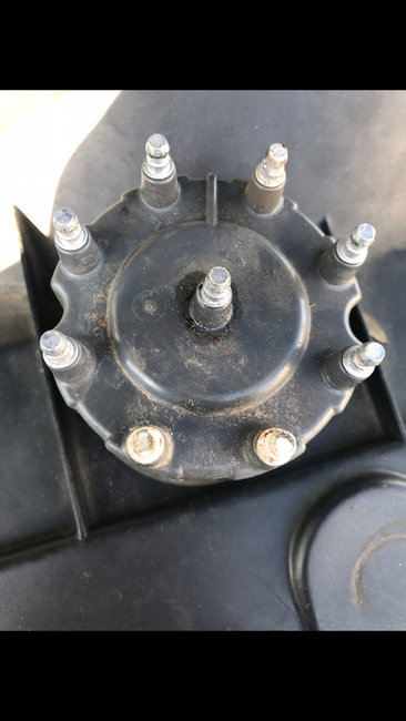

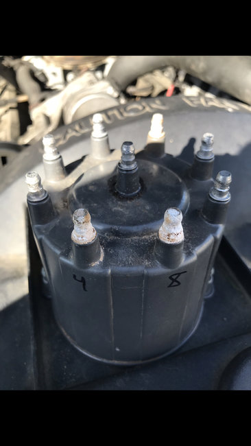

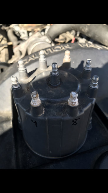

Well finally figured it out a few days ago. Eight is where one should be and goes around that way. Not sure why it was installed that way. Here is the picture of the old cap.
Apr 25, 2018 at 11:53 PM
PATENTED_REPAIR_PRO
  • 1,853 POSTS
Someone had the number one piston up on TDC exhaust stroke when they pointed the rotor toward number one on the cap, that is why it was 180 degrees off. The number one piston was supposed to be at TDC on the compression stroke.
