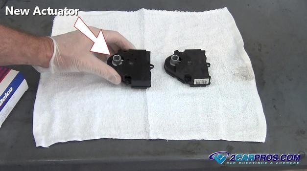

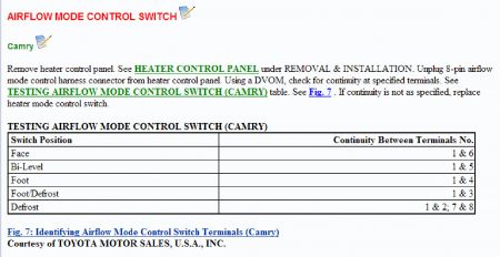

when i switch to defrost the air continues to blow out the air conditioner/heater vents not on the windshield, switching the controls (face, feet etc) does not change to direction of the air flow.
Oct 12, 2016 at 12:57 AM
  • 55,423 POSTS
It sounds like you have a mode door actuator that is not working here is a guide that will help you.
https://www.2carpros.com/articles/air-vents-stay-in-the-defrost-position
Please let us know what you find so it will help others.
Best, Ken
Oct 14, 2016 at 5:00 PM
SATURNTECH9
  • 30,869 POSTS
That would be a issue with the mode door actuator.

Look under the dash in the middle for a cable going to a mode door.Then operate the mode door knob while watching it.It doesn't just a OT about the AC on that car on our repair information we use.But looks like it might be cable operated.

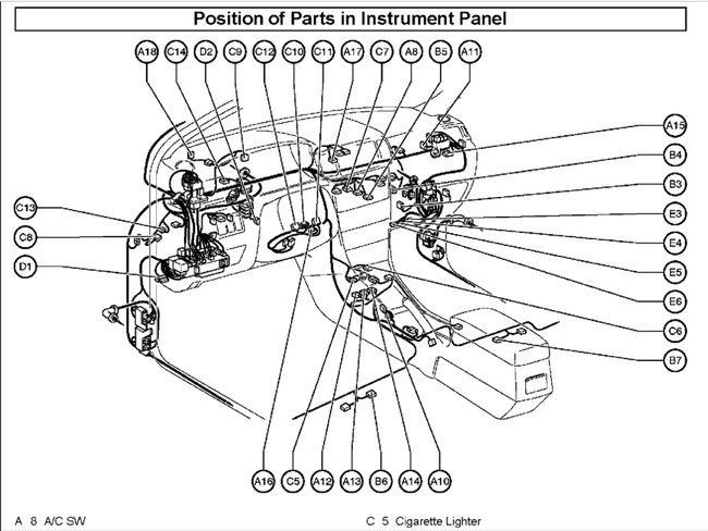

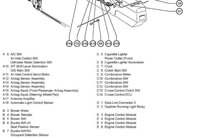

yes and no, the mechanic couldnt find the actuator, however they did switch the heater manually so that at least I have defrost on the windows until they can find where the actuator actually is located.
Dec 21, 2016 at 9:33 PM
  • 55,423 POSTS
Hey LJCALLES,
I found this location diagram for you maybe you can print it and give it to the garage so they can see where the actuator is.

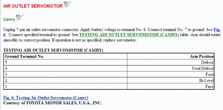

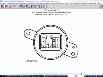

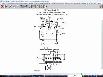

Look far a leaking servo, tht's the vacuum motor. does any of them reopen after they have moved? It sounded like you said it took 2-3 minutes, then the cold set in? Also when it turns cold check the water inlet to see if it has cooled...if there is a valve in the waterline it may be closing the water flow off!
Jan 3, 2020 at 8:21 AM (Merged)
MERLIN2021
  • 17,250 POSTS
Here are some test proceedures to follow!
https://images.2carpros.com/forum/automotive_pictures/62217_Heat1_1.jpg
https://images.2carpros.com/forum/automotive_pictures/62217_Heate1r_1.jpg
https://images.2carpros.com/forum/automotive_pictures/62217_Heat2_1.jpg
https://images.2carpros.com/forum/automotive_pictures/62217_Heater_1.jpg
