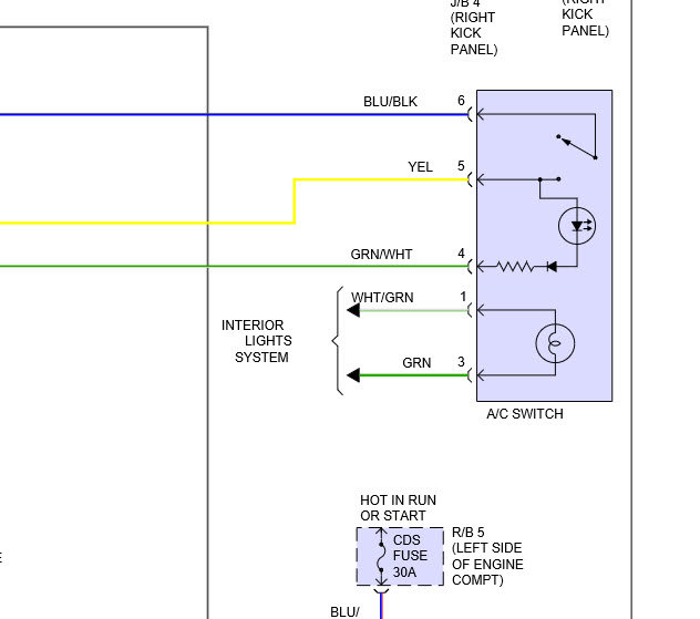

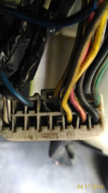

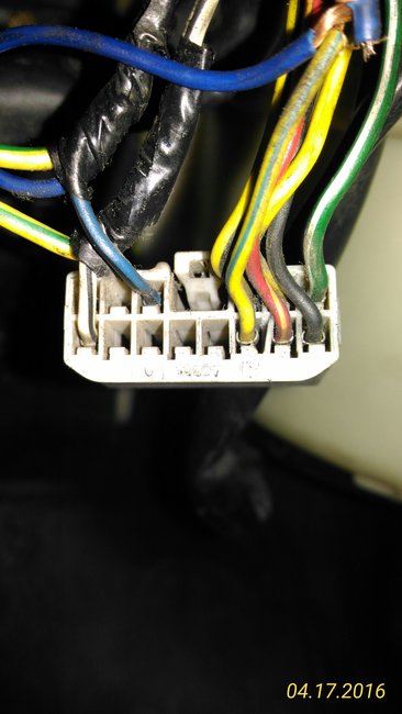

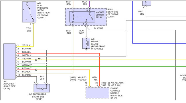

color coding or wiring diagramming of the sub wiring harness from air conditioner amp to the the thermistor and main connector of the car? The old one was removed and not replace by a knew one. Thanks

yellow and white and light green go to switch.
Apr 25, 2016 at 11:00 PM
BONZKIE28
  • 13 POSTS
thanks for the diagram,1.6L and 1.8L have the same diagram?

that was only lifted to may car sir the primary socket terminal,of the ac amp.,the sub wiring harness was messing.

the harness pic I sent is for a 1.6 what you asked for or listed. here is switch

Sir good day.has been a long time to log in.,sir was already put a wiring harness ang ac amp.but when i turn on an ac switch the ac compresor didnot kick on.i been follow the wiring diagram that you given to me.the idle up is finction already .but new problem is the ac compresor not kick on.sir aside from low and hi switch ,they have another switch ?

Sir can i ask the actual amage of the ac switch?thanks
May 11, 2016 at 3:19 PM
  • 55,433 POSTS
It should be 5 to 10 amp

good day sir,i already put an ac amp. to my car.the idle of my car has been raise up every time i on the ac,,thanks for the diagram that you send to me,its help me..by the way sir i will ask you again ,what is the purpose of the coolant that flow inside the idle air control valve housing?
