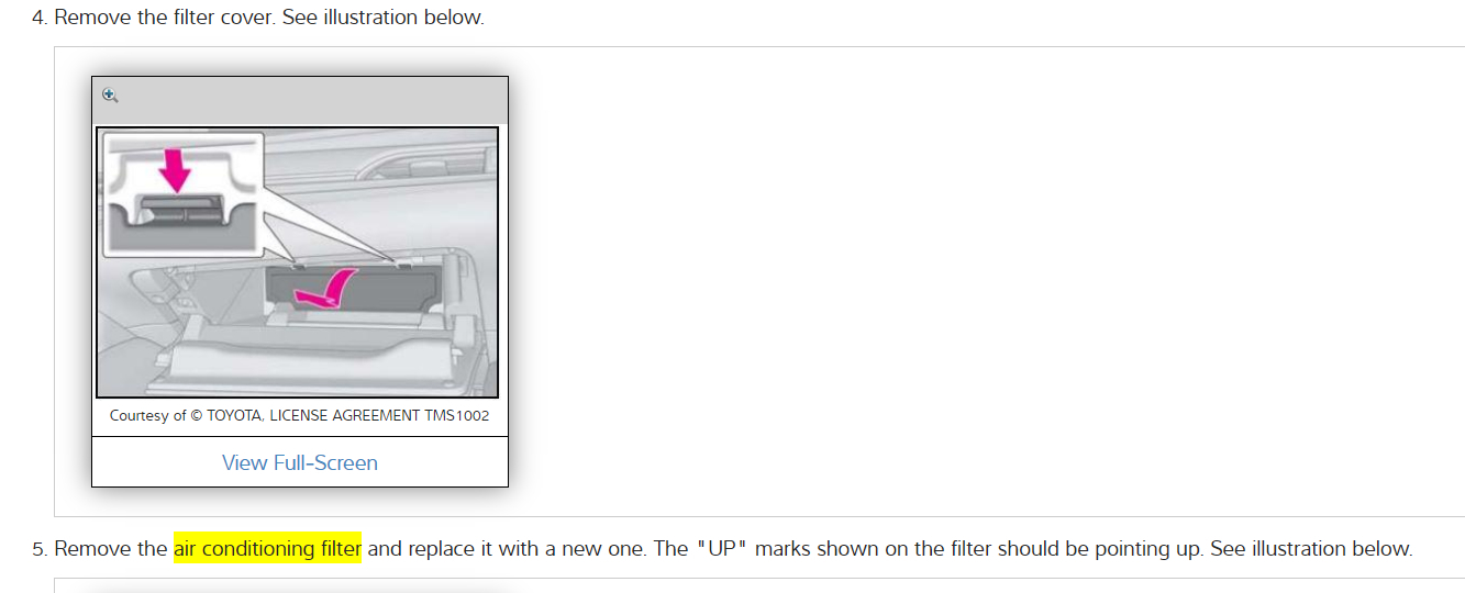

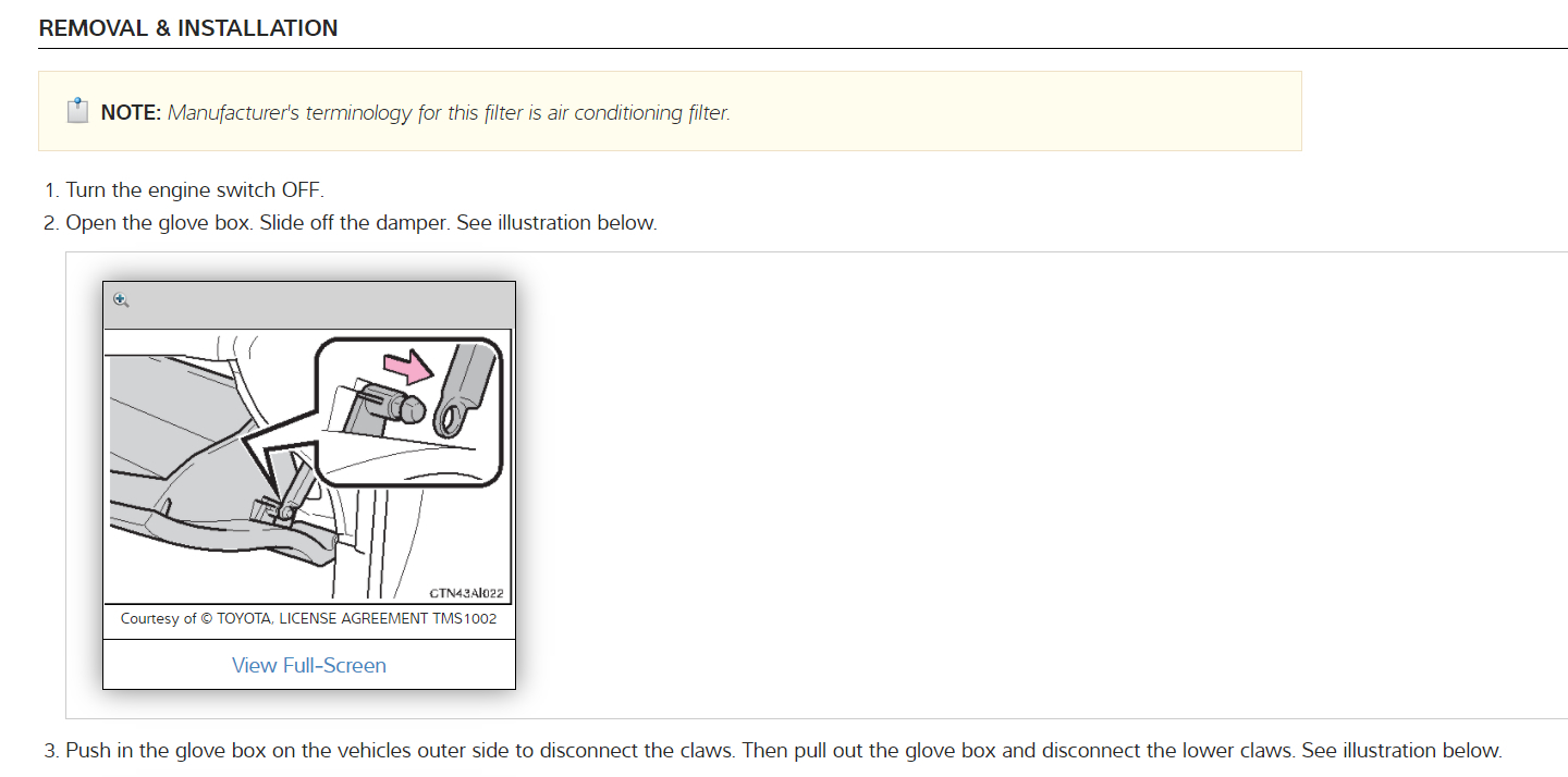

First, I am not certain if I chose the right category, as I am not sure WHERE the cabin air filter IS. Second, assuming it is somewhere INSIDE the cabin, can you tell me how I might be able to replace it, instead of paying a "technician" a hundred bucks to do it for me? Thanks so much, Rob Lowrie
Jul 14, 2010 at 4:53 AM
BLUELIGHTNIN6
  • 16,542 POSTS

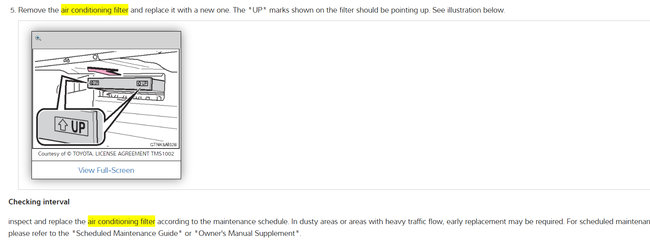

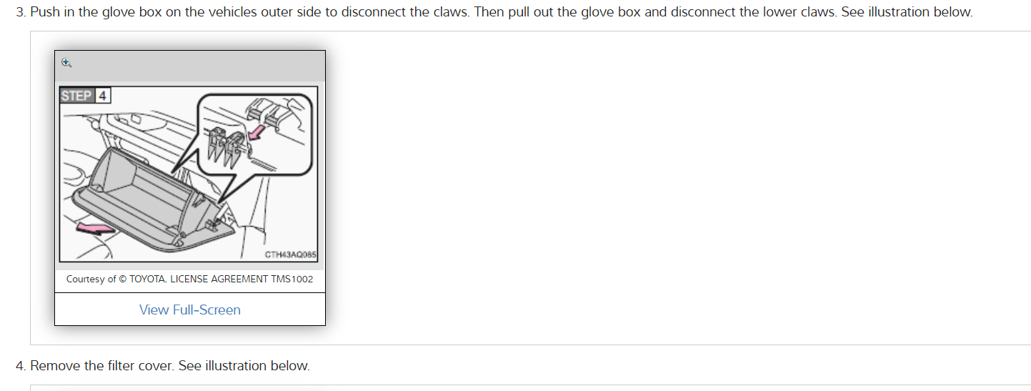

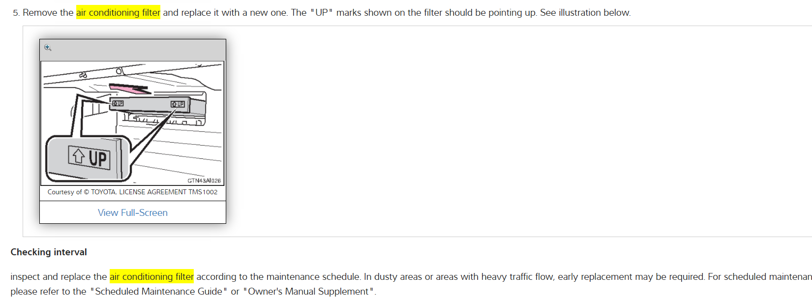

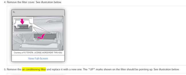

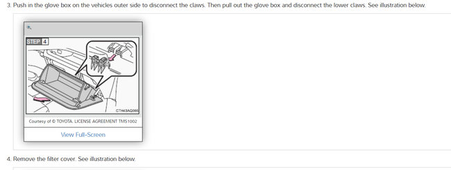

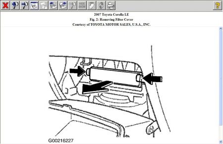

it is located behind the bottom glove box . No tools are needed on the 2009. Locate the strut on the right outside of the glove box, squeeze the keeper together and slide the strut off, move the glove box to one side to release the side stops, and the pull the glove box off the bottom hinges (it just snaps on and off). You will see a black cover over the filter. Pull the right hand tab over to release the cover and remove it. Replace the filter and reverse the procedure. Here are the instructions in the diagrams below to show you how to replace the cabin air filter. Check out the diagrams (Below). Please let us know if you need anything else to get the problem fixed.

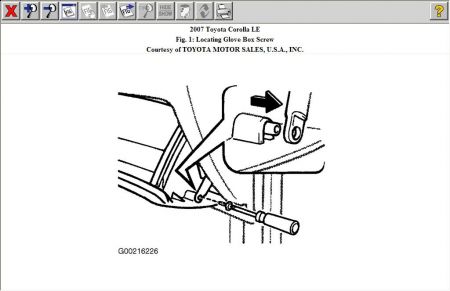

Can you tell me where the Cabin Filter is and how to get it off?
Thanx!!
tooleey
Aug 15, 2020 at 3:50 AM (Merged)
  • 75,992 POSTS
Its behind the glove box
https://images.2carpros.com/forum/automotive_pictures/12900_air1_1.jpg
https://images.2carpros.com/forum/automotive_pictures/12900_air2_1.jpg

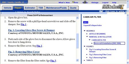

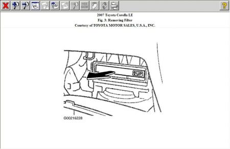

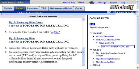

Where is the cabin air filter located on my 2007 Toyota Corolla? How do I change it?
  • 75,992 POSTS
Its behind the glove box-
https://images.2carpros.com/forum/automotive_pictures/12900_filter1_1.jpg
https://images.2carpros.com/forum/automotive_pictures/12900_filter2_1.jpg
https://images.2carpros.com/forum/automotive_pictures/12900_filter3_1.jpg
