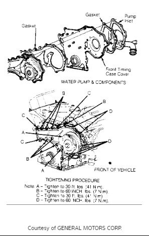

I replaced my original water pump and not the original serpentine belt. This was a pain in the butt to say the least. Plus, a very dirty job being that it was original water pump. Upon completion there was still a leak coming from somewhere and without being able to put it up in the air I decided to take it to the dealer to get diagnosed, they told me that the water pump bolts weren't completely tight to specs therefore it was leaking. Then they said it would be $450.00 to tighten them up and fill with antifreeze. $450.00 to tighten the bolts and some antifreeze sounds extremely ridiculous compared to the amount of work involved getting it to the bolts just needing to be tightened more. What would a dealer charge in Sacramento, CA. for the whole job if it's $450.00 just to tighten the bolts down to specs. Getting it out was the hardest part and cleaning everything and installing the new one! Tightening the bolts and nuts was nothing in the whole process of things. Can I get some opinions, thanks?

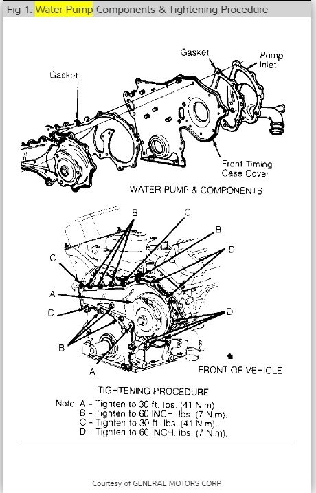

They are from what it sounds like to me charging you to do the whole water pump job. I would buy a torque wrench and do it yourself. Then you will have that tool for the next project. I have included a tightening sequence with corresponding torque specs.

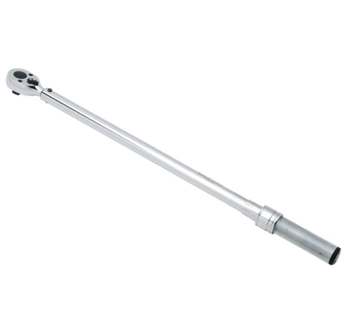

When you are shopping for a torque wrench get one around $100.00 or more. Get a good one to make sure it is accurate and will stay accurate. Also get a click type not the beam type. The picture I included is a click type torque wrench.
