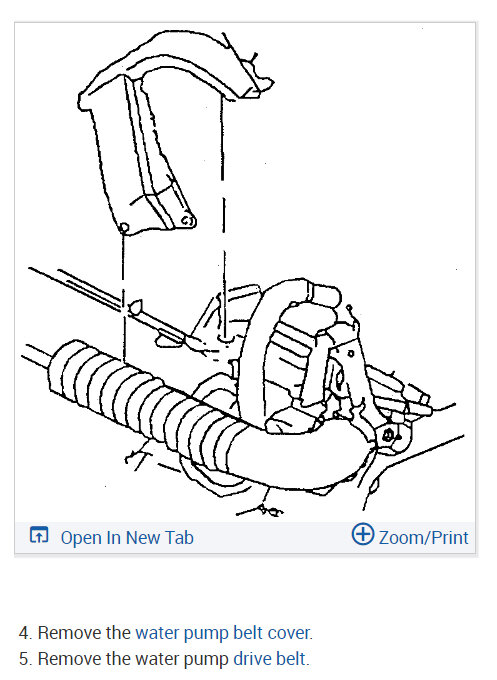

I need to know how to remove the water pump from a cadillac diville northstar?

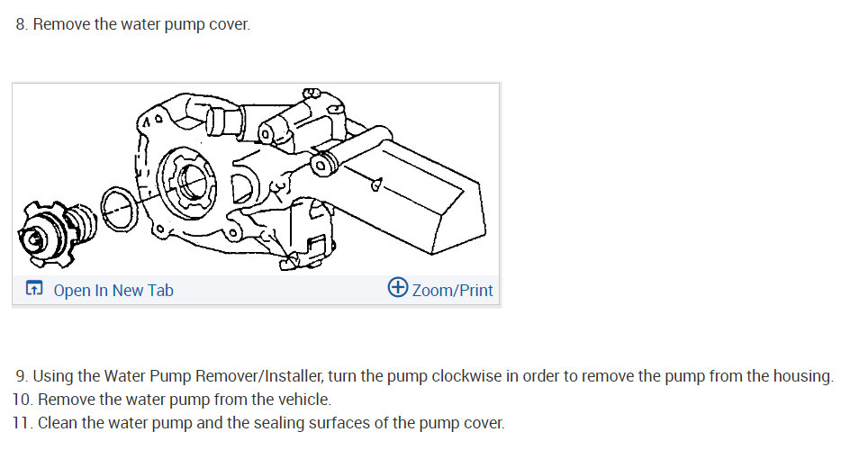

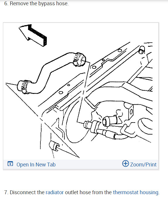

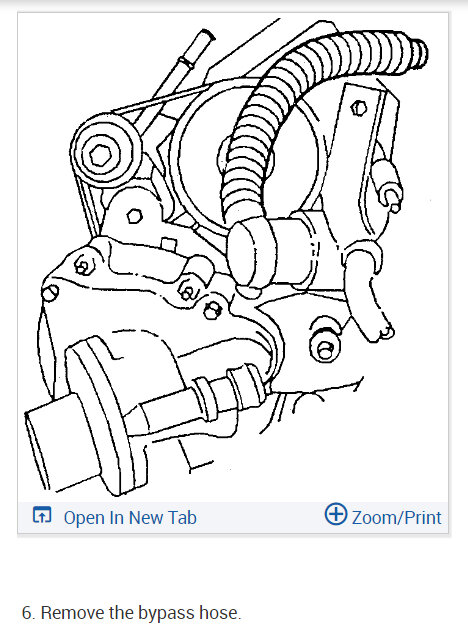

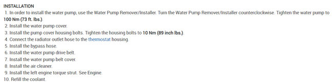

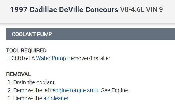

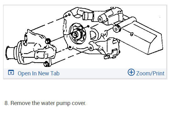

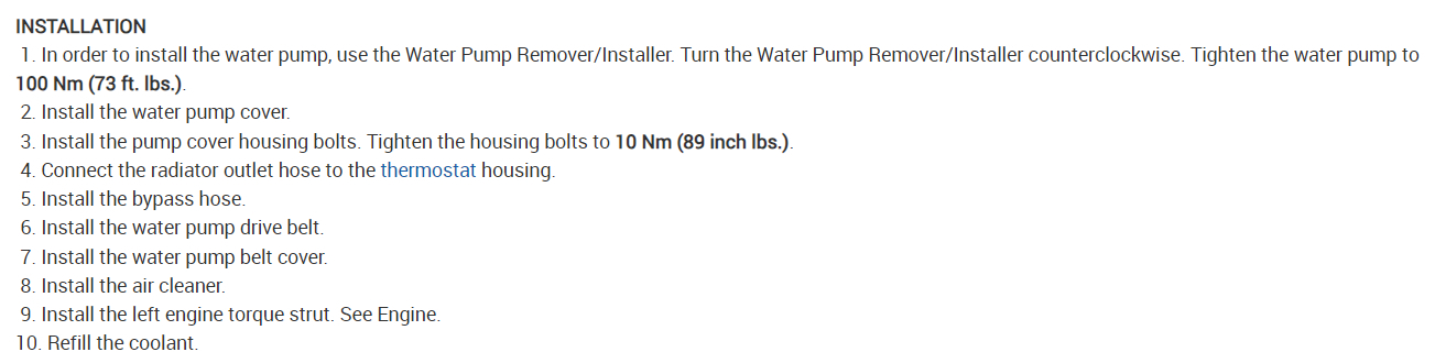

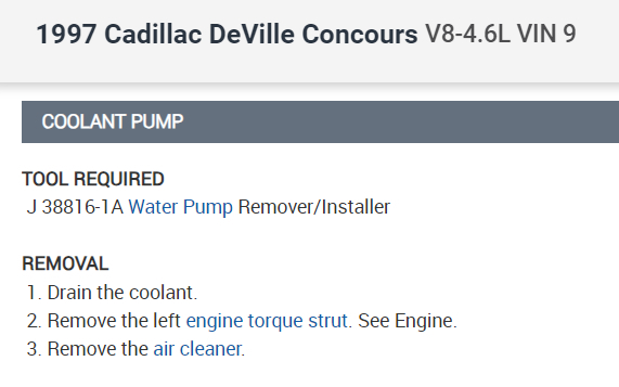

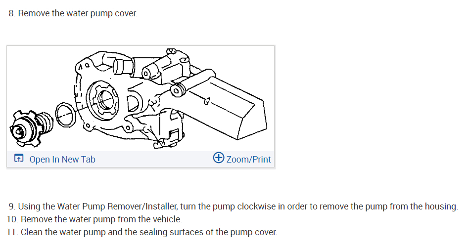

On the 4.6 Northstar motor the water pump is located on the driver's side. The process is pretty straight forward, but you must buy the special tool. This is like a large huge socket with notched teeth that grab the "ears" of the pump. I was able to buy the tool at local auto parts store for around $20+. Here is how the job is done in the images below.
