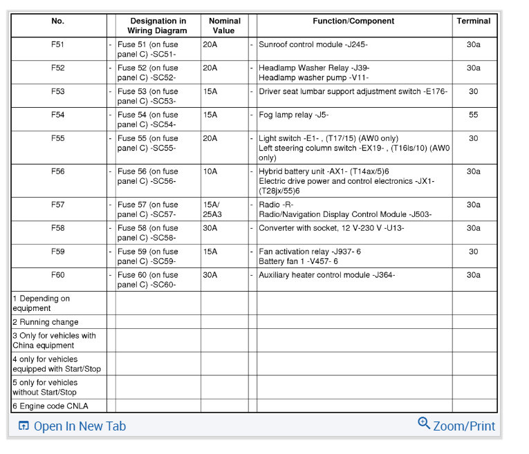

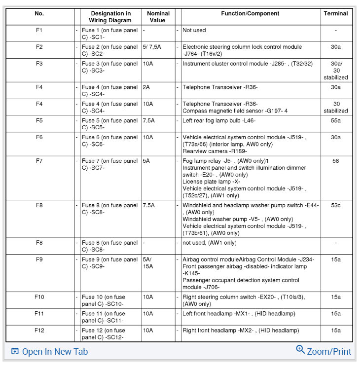

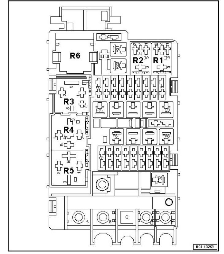

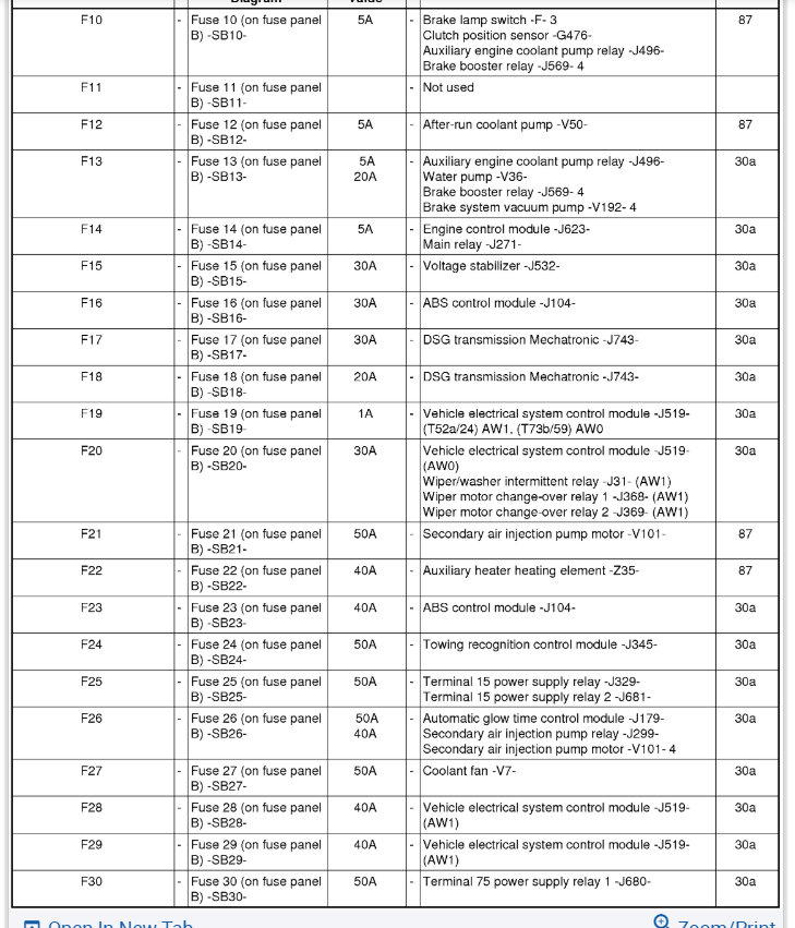

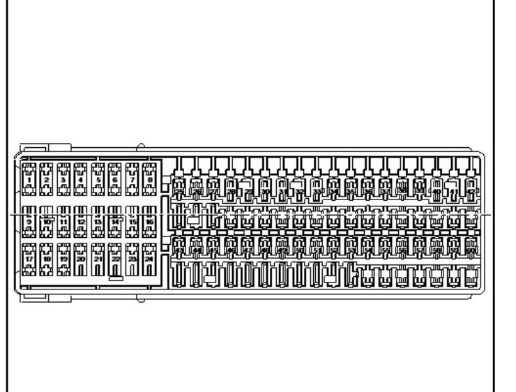

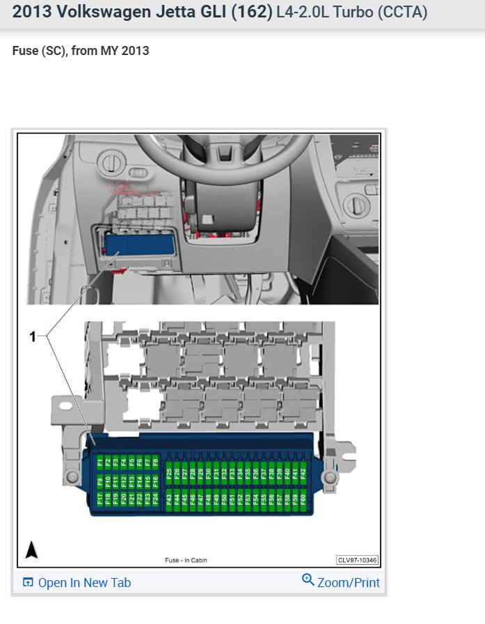

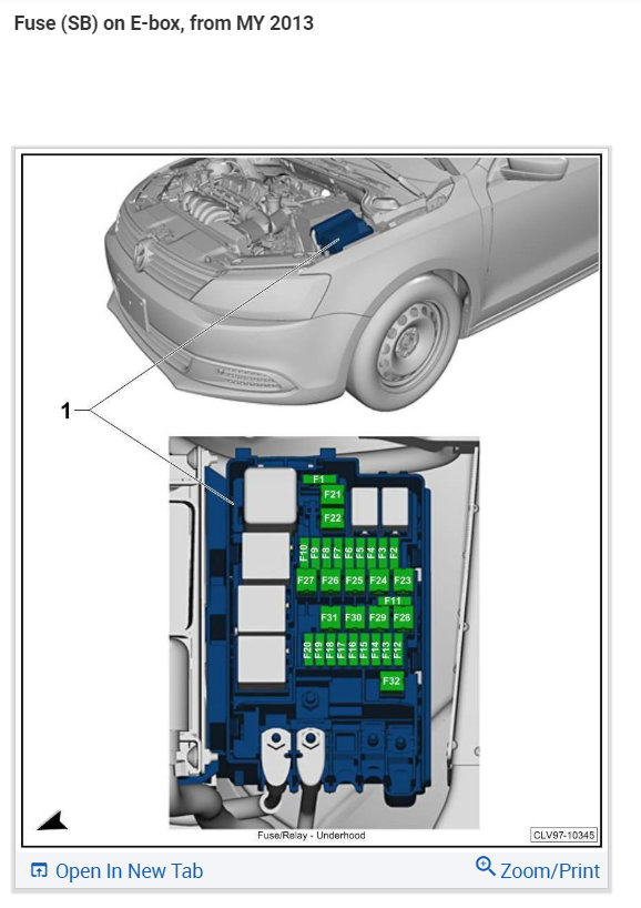

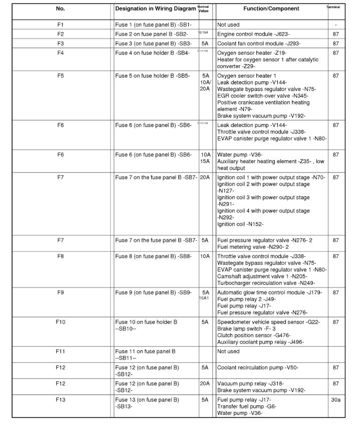

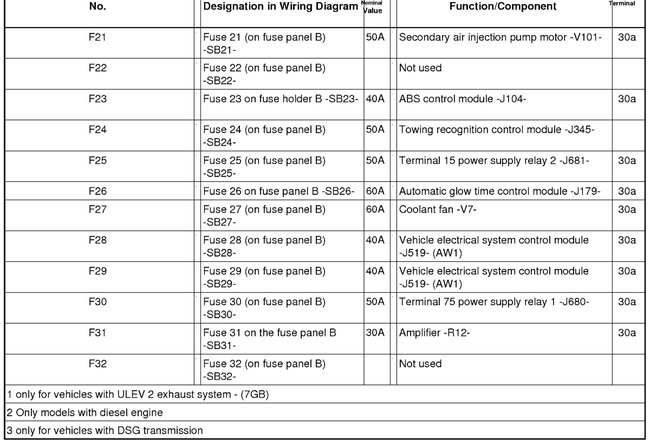

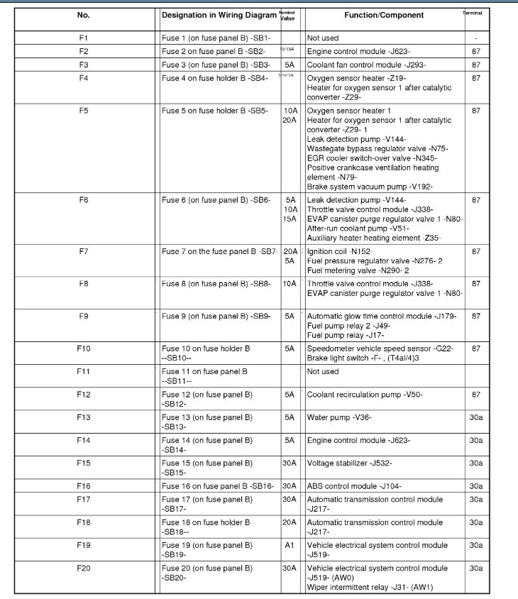

where can I tell which fuse is for what.In the fuse box? There is nothing saying what fuse is for the radio, or the tail lights or the instrument cluster.
May 27, 2016 at 1:14 PM
MHPAUTOS
  • 31,937 POSTS

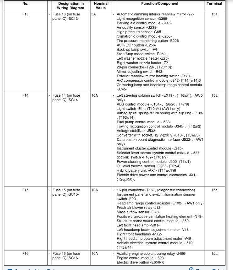

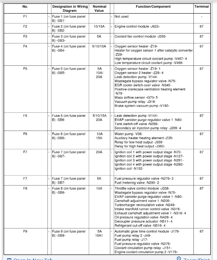

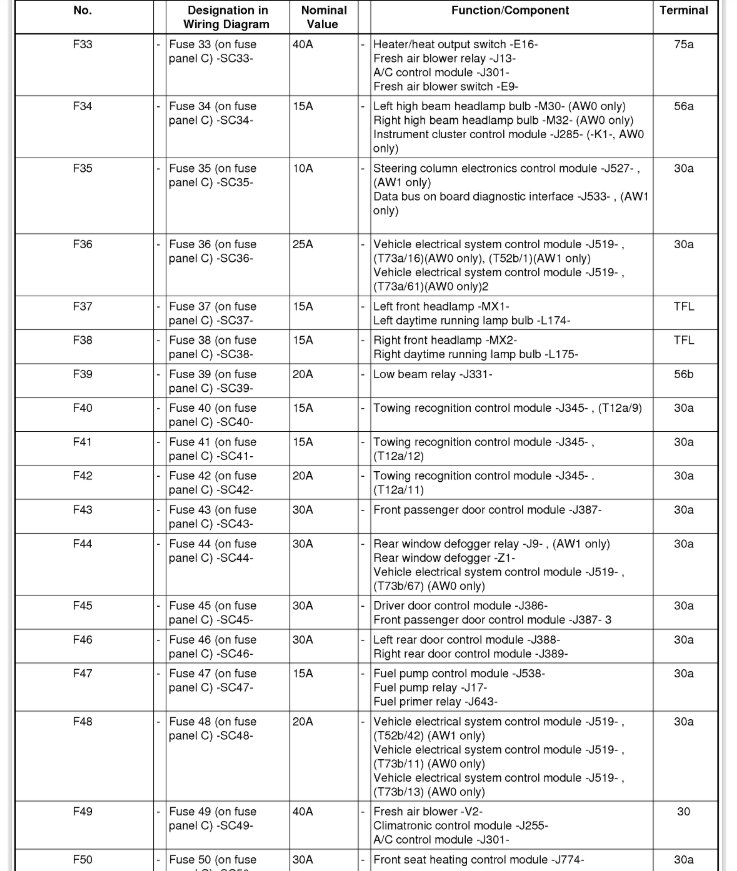

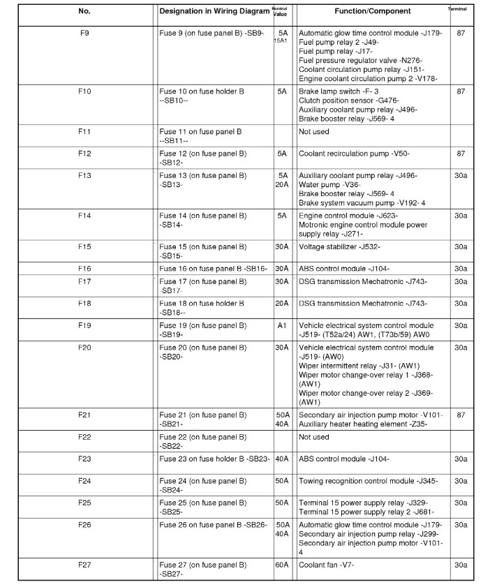

We need to check fuse #23, 10, 14 and 16 in the fuse panel inside the car and under the hood here is a guid to help you with the fuse locations and the wiring diagrams so you can see how the system works below.
Check out the diagrams (Below). Please let us know what you find. We are interested to see what it is.

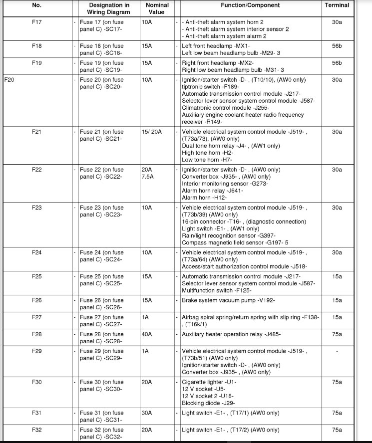

Having a problem with the tail lights in the rear driverside.
#23 5a fues keeps blowing.

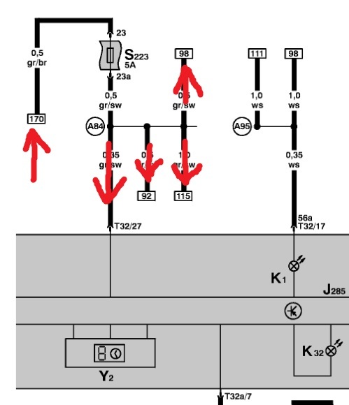

EXOVCDS
  • 1,882 POSTS
Are you sure the problem is in the back?
Did you check the front left side marker in the bumper?
How's the amber bulb in the front headlight assembly?
Thomas
Apr 13, 2020 at 4:13 AM (Merged)

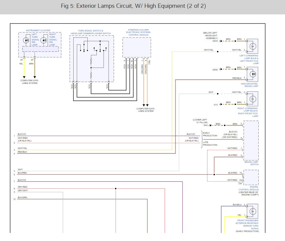

EXOVCDS
  • 1,882 POSTS
- #92 goes to front left side marker
- #115 goes to left tail light
- #98 goes to left park light (front)
Thomas
EXOVCDS
  • 1,882 POSTS
Forgot image... sorry.
Still getting used to new website layout...
Thomas
J.STIEG
  • 361 POSTS
Thomas,
can you post that diagram again, only without the red arrows. Thanks
J.STIEG
  • 361 POSTS
Never mind, I think they are all GR/SW. thanks

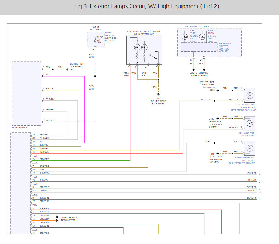

J.STIEG
  • 361 POSTS
The #23 fues ONLY blows when the HEADLIGHT SWITCH is on, but with all lights unplugged in every corner.
I have the test light bulb looped in series on #23, and all lights UNPLUGGED. I now turn the headlight switch on, but TEST LIGHT comes on.
Right now I am trying to get the test light off,,,,, with headlight switch on,,,,,, and of course every light unplugged.
Trying to find a place to unplugg at firewall to see if problem is in the front or back, Any ideas?
J.STIEG
  • 361 POSTS
There are 10 wires going to the headlight switch. I need to know what they are, and test them for shorts.
If I unplug headlight switch connector the test light on fues #23 goes out.

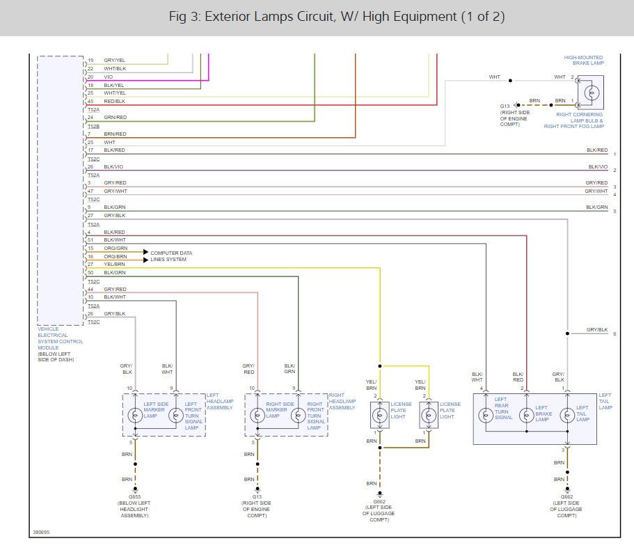

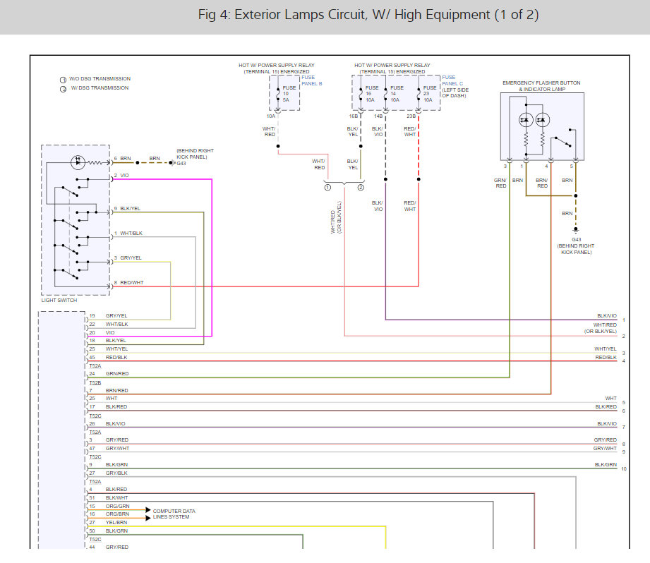

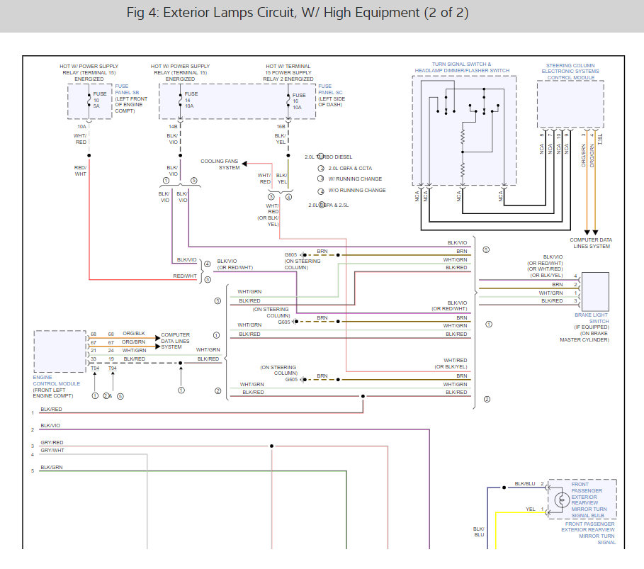

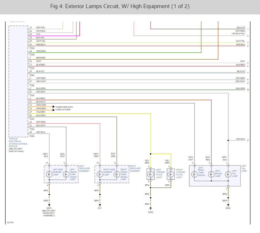

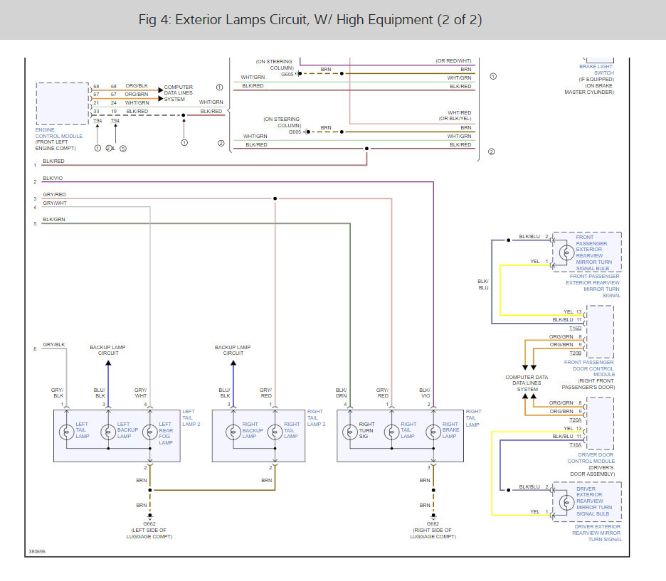

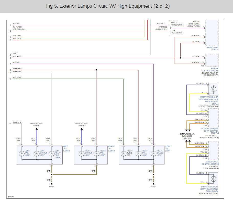

KHLOW2008
  • 41,812 POSTS
See if this diagram is of any help.
J.STIEG
  • 361 POSTS
thanks KHLow2008 for the diagrams! I found the problem using the diagrams.
It was a left front small amber running light shorted out.

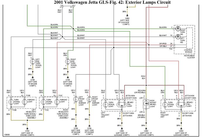

My left tail light went out the other day, so I went to advanced auto parts and purchased a replacement. The replacement light bulb was installed successfully, but once i turned the lights on - it still was not working. The brake lights work fine, just not the left tail light. I am not sure if this is a fuse issue or some type of socket or wiring issue. Ive tried to find fuse diagrams online to see if I could find the fuse for the tail lights to check to see if this was a fuse issue - but there is no information out there. Does anyone know if this is a fuse issue or if this is a different problem Thanks.
  • 110,248 POSTS
It could be a fuse or the bulb connection, here is the wiring diagrams so you can see how the system works with a guide to help test the bulb for power to see if it is a socket problem and a guide to help check the fuses, the fuse locations are in the diagrams below.
and
https://www.2carpros.com/articles/no-tail-lights-exterior-running-lights-tail-lights-out
