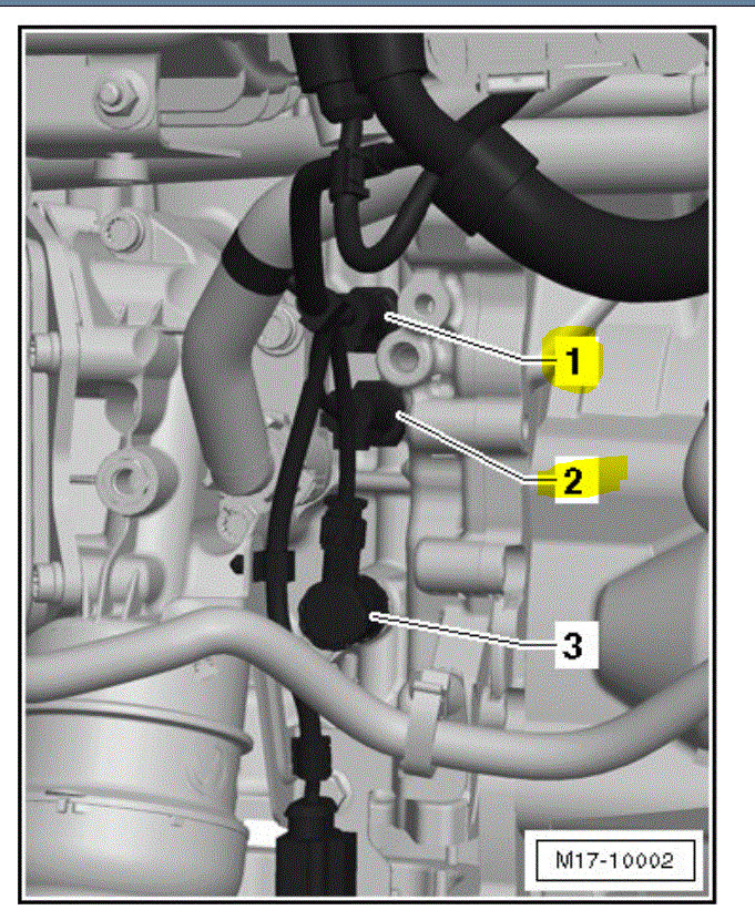

I need to replace my oil pressure sensor and I cannot find its location. I have tried looking online with no luck. If anyone can tell me where it is and the procedure to replace it, I would really appreciate it. It is a pzev engine.
Feb 3, 2022 at 11:41 PM
  • 110,248 POSTS

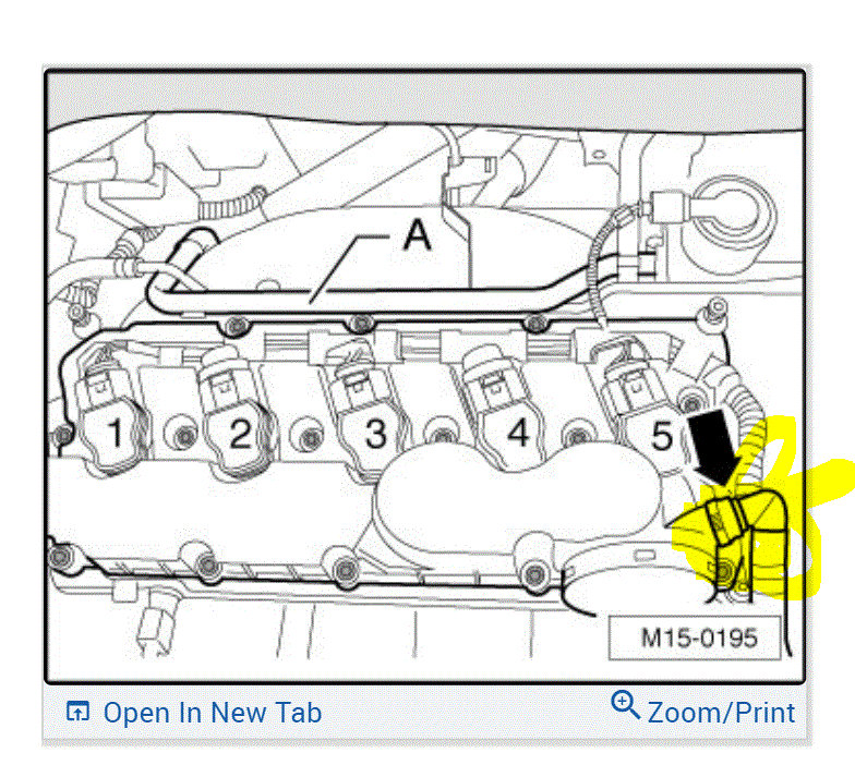

It's behind the alternator, below the intake, at the rear of the engine. See pic 1. In pic 2, I highlighted two connectors. Number 1 is the oil pressure switch and number 2 are the reduced oil pressure sensor. Number 1 will be blue, and number 2 is brown.
As far as replacement, simply disconnect the electrical connector and the sensor (using a deep well socket) will screw out.

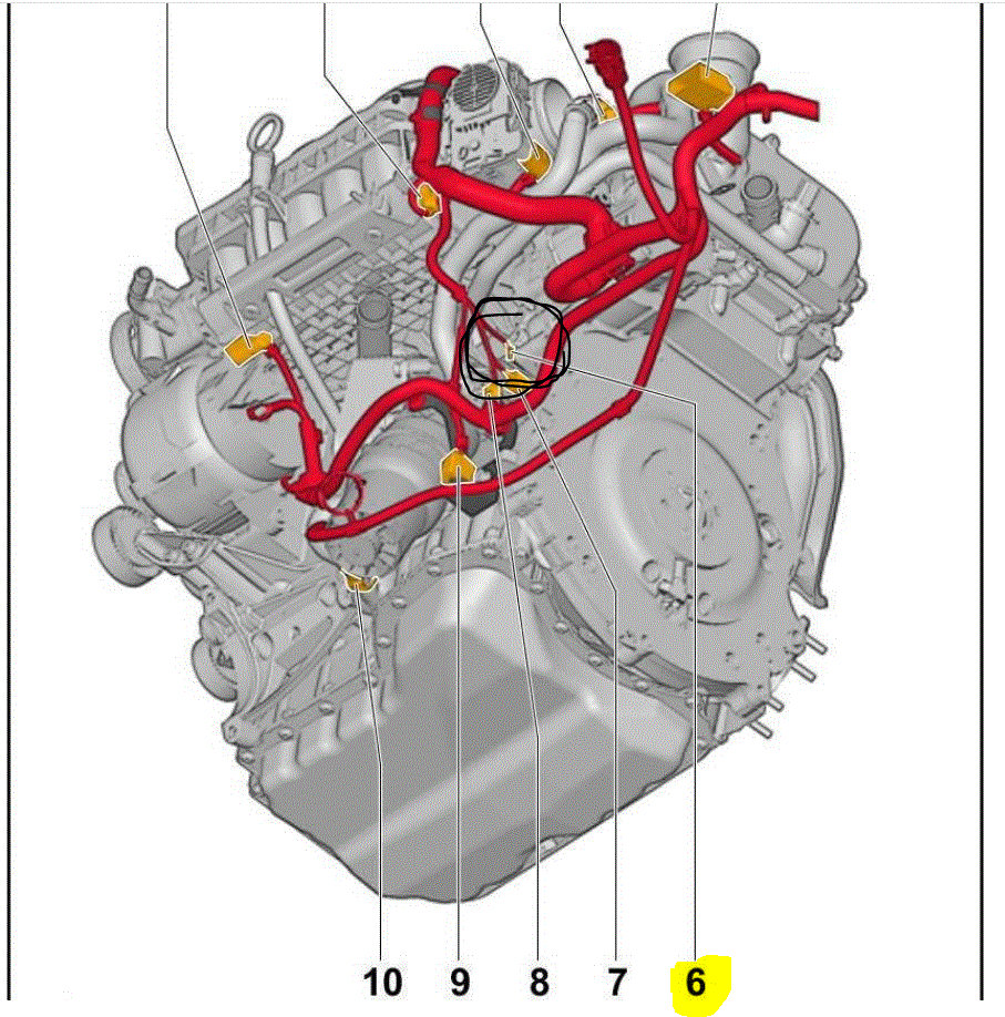

I added pic 3 so you could get a better view of what the sensor looks like.
Let me know if this helps.

Is it easier to access from underneath the car or above? And will I need to remove anything to access the sensor?
Feb 4, 2022 at 7:26 PM
  • 110,248 POSTS
If you have a lift to place the vehicle on, you will need to remove the splash shield from under the vehicle, but it should be easier.
