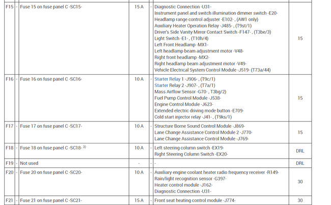

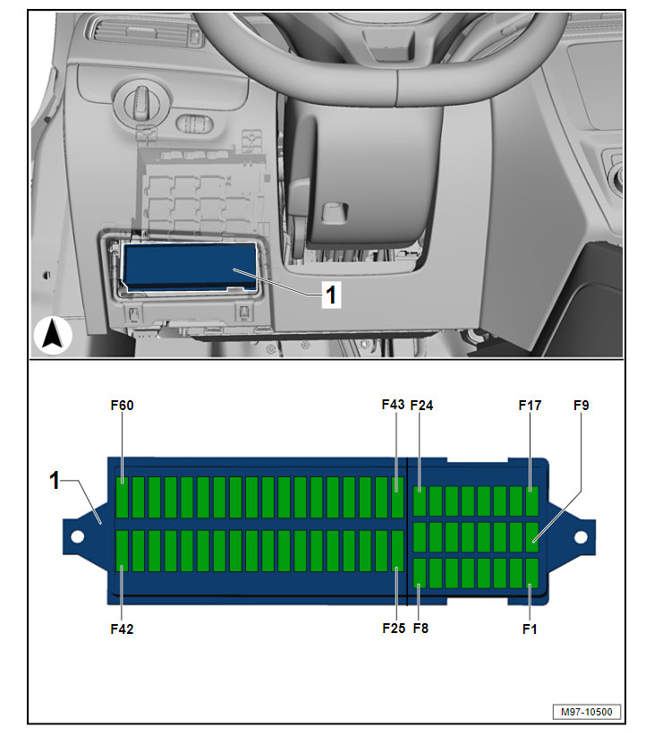

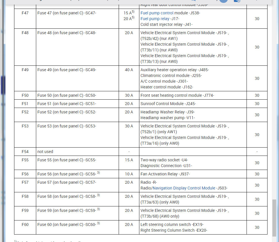

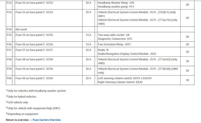

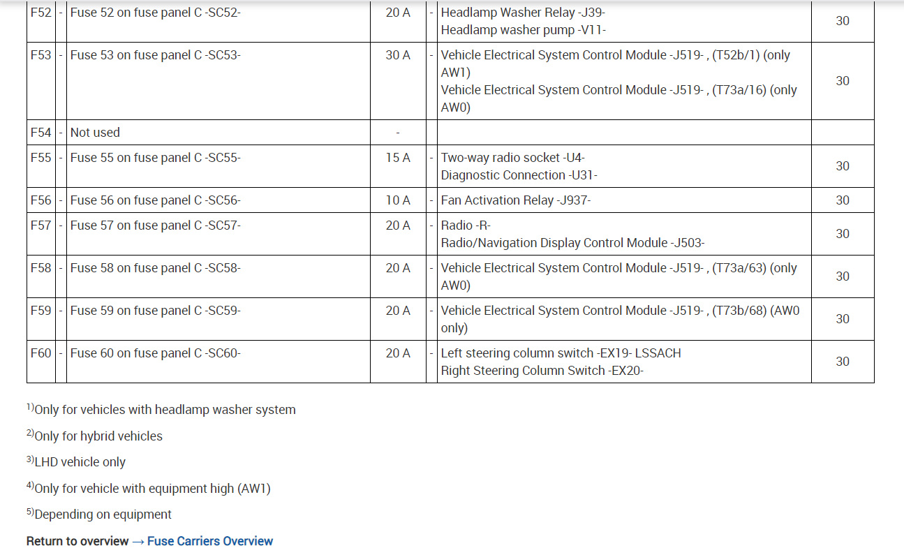

I mistakenly removed a wrong fuse and now I’m not sure where it belongs, as I’ve forgotten where I took it out from. (Stupid, I know.) Would anyone have a fuse box diagram or even a picture of where the fuses should and shouldn’t be for my model? It’s a TSI if that makes a difference. Is there suppose to be any fuses from numbers 53-55?
May 9, 2021 at 9:30 AM

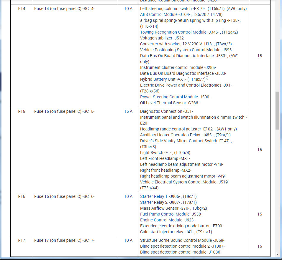

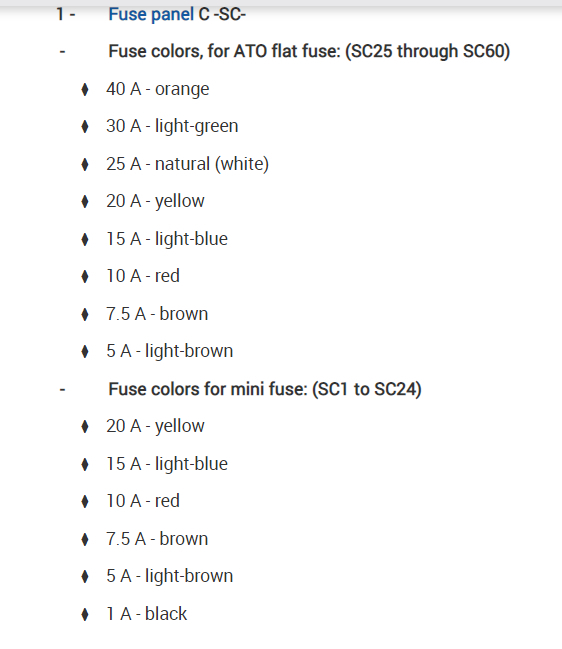

I attached the info below. It looks like you have a 30A in 53, nothing in 54, and a 15A in 55.

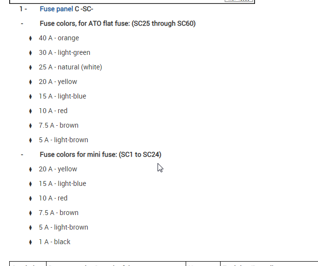

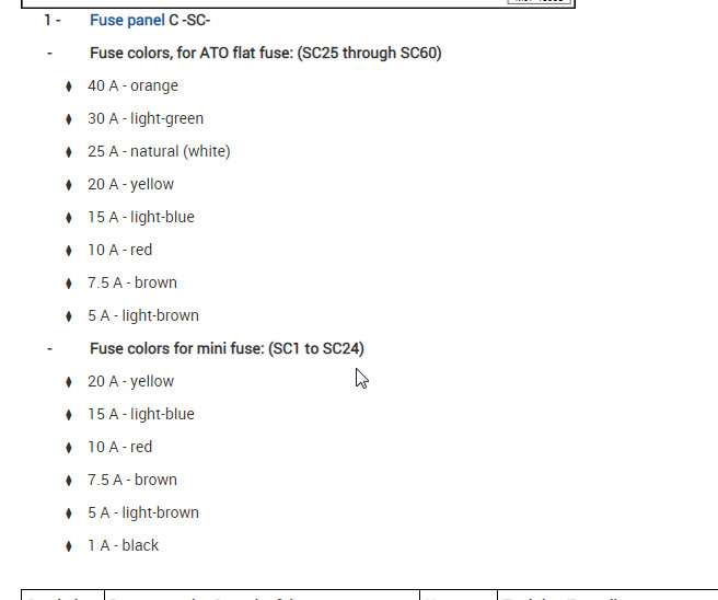

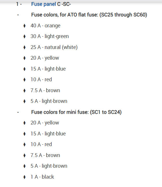

So that means 53 should be a light green fuse. Then 55 should be light blue.
Let us know if you need more info. Thanks
May 9, 2021 at 9:46 AM

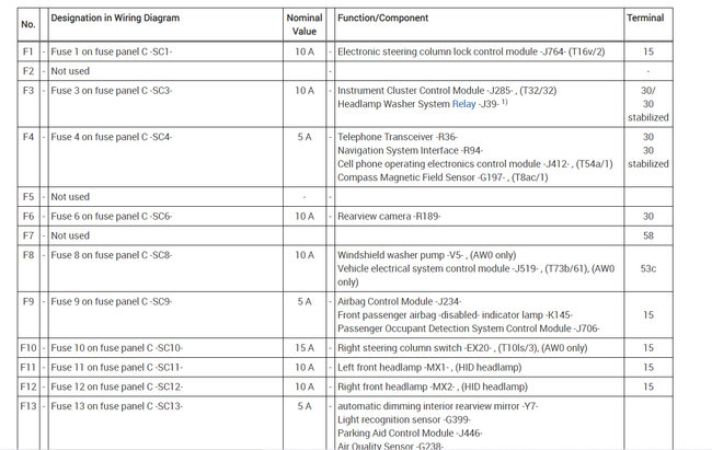

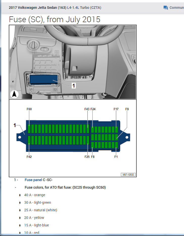

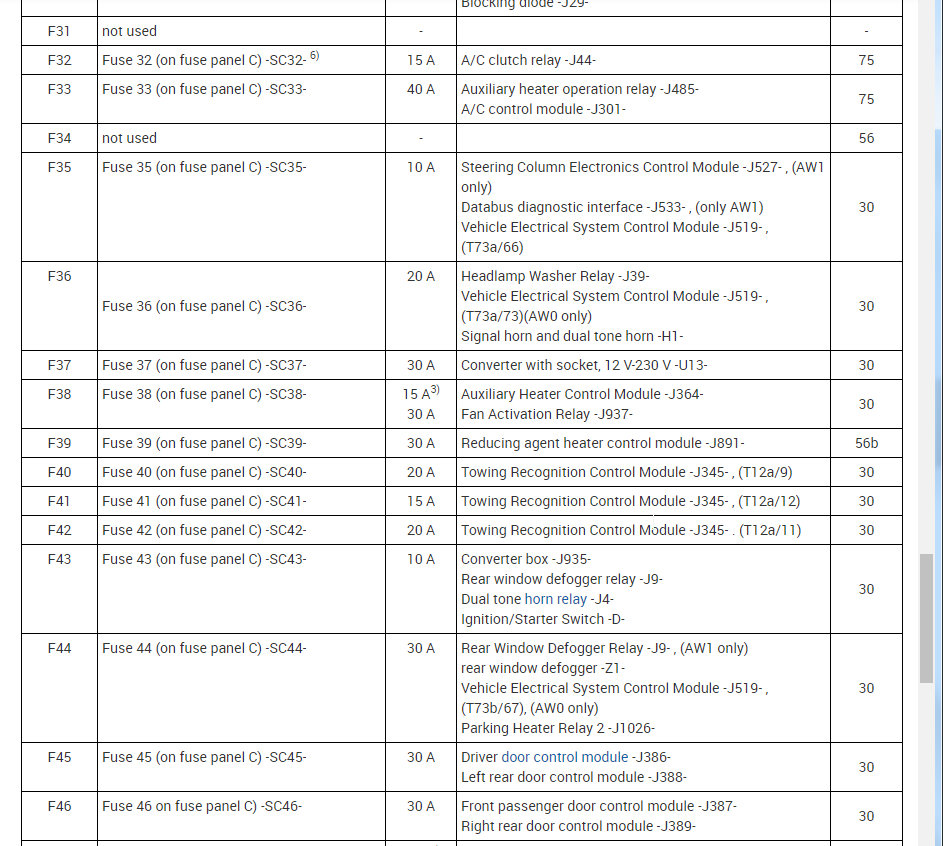

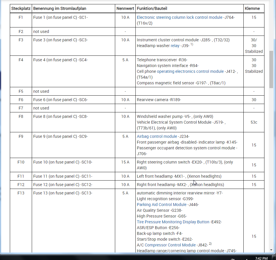

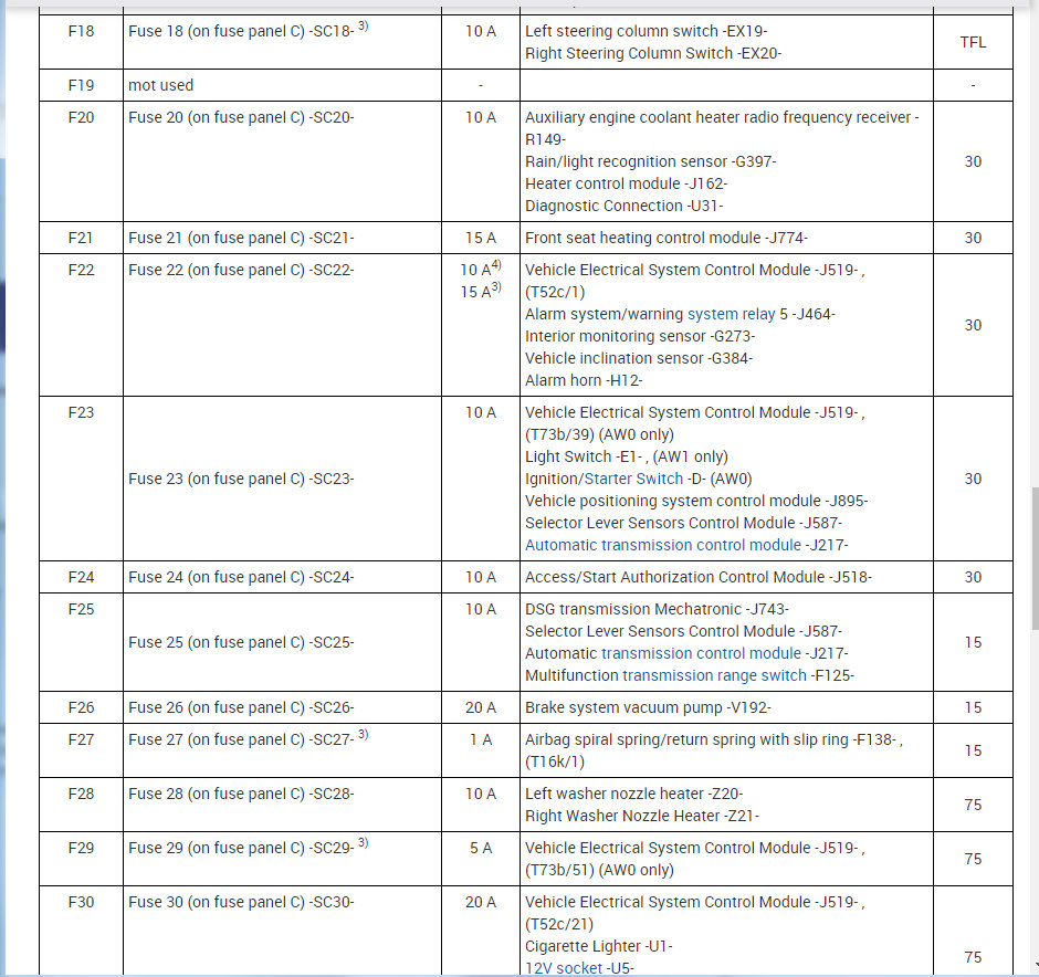

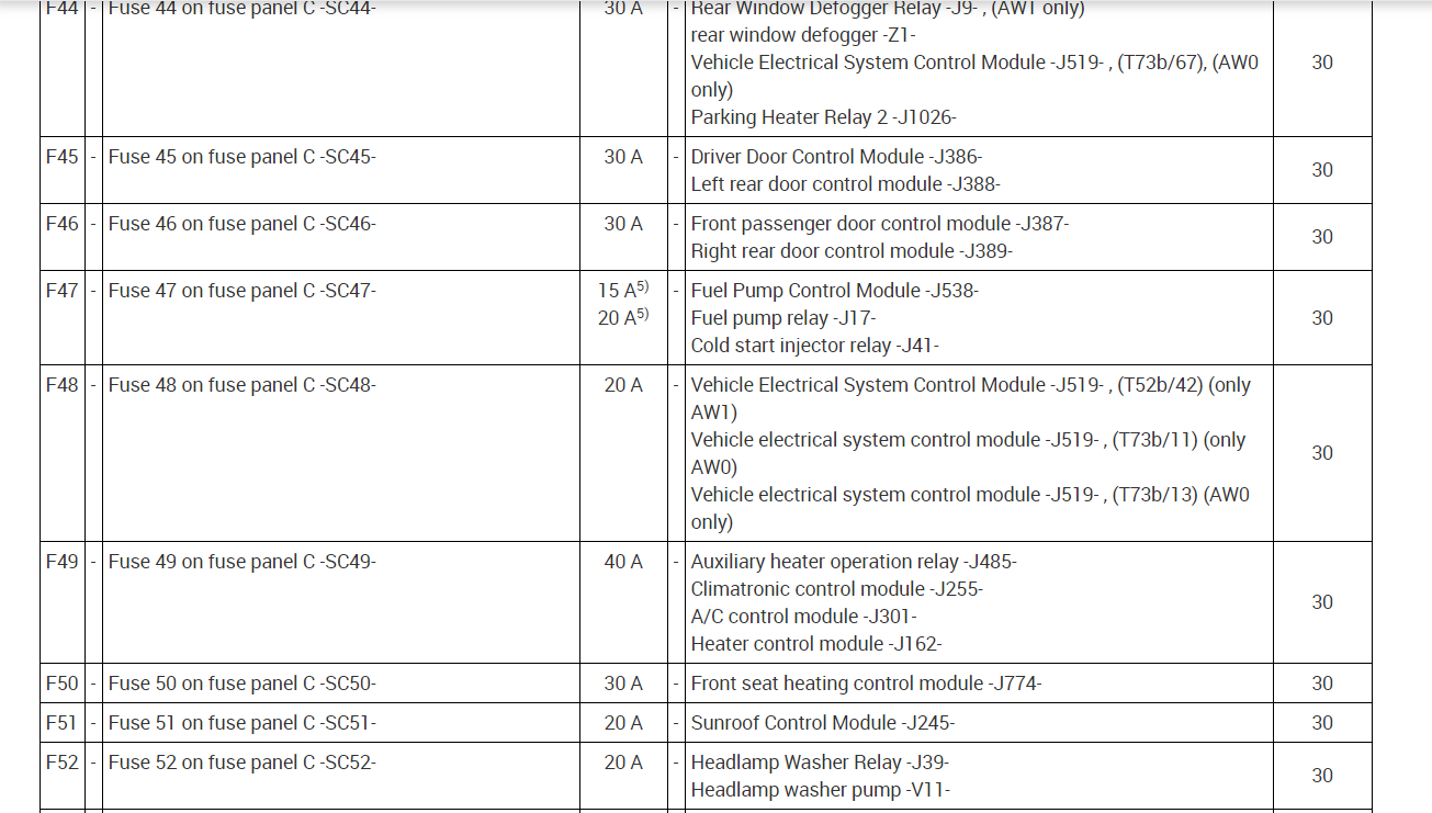

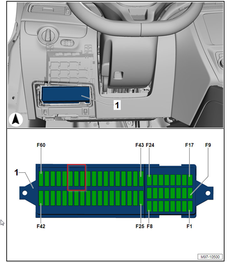

Good afternoon,
I attached the fuse box diagram and the function and amp rating of each fuse for you below.
VW2017WOLF
There isn’t a light blue one in 55, but I put the light green into 52. I think it was meant to go in 53 since 52 is for headlight washers which my car does not have. Would this be correct?
May 9, 2021 at 9:58 AM
Make sure the amp ratings are correct according to the diagrams we sent.
May 9, 2021 at 10:03 AM
VW2017WOLF
The 52 space calls for a 20A fuse, the fuse that I thought went in 52 is a 30A, but the 53 spot calls for a 30A so I’m thinking it must go there. 52 corresponds to headlamp washers which aren’t equipped on my car.
May 9, 2021 at 10:20 AM
Then most likely no fuse is needed. It may have only one terminal in the fuse box for the fuse.
May 9, 2021 at 10:33 AM
VW2017WOLF
I know the fuse I took out (30A or light green) came from one of the spaces between 52-54. Space 52 is for a 20A fuse that corresponds to the headlamp washers which I do not have in my car. Since 54 is not used, the 30A fuse would have to go into space 53 right? (Space 53 calls for a 30A)
May 9, 2021 at 11:24 AM
Correct.
May 9, 2021 at 12:21 PM
