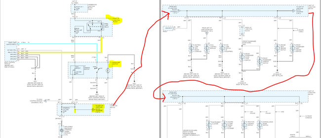

Dash lights stopped working then the taillights now none of the back lights work except the flashers. Replaced the rear park lp fuse twice, but it just sparks and blows. whats the easiest way to find the short?

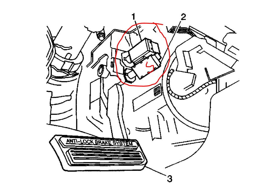

If it still blows the fuse even with the bulbs removed and there is no evidence of socket or wiring issues, disconnect the brake light switch under the dash. It is located at the top of the brake pedal, and try that.
I attached a pic below showing where the brake light switch is located.

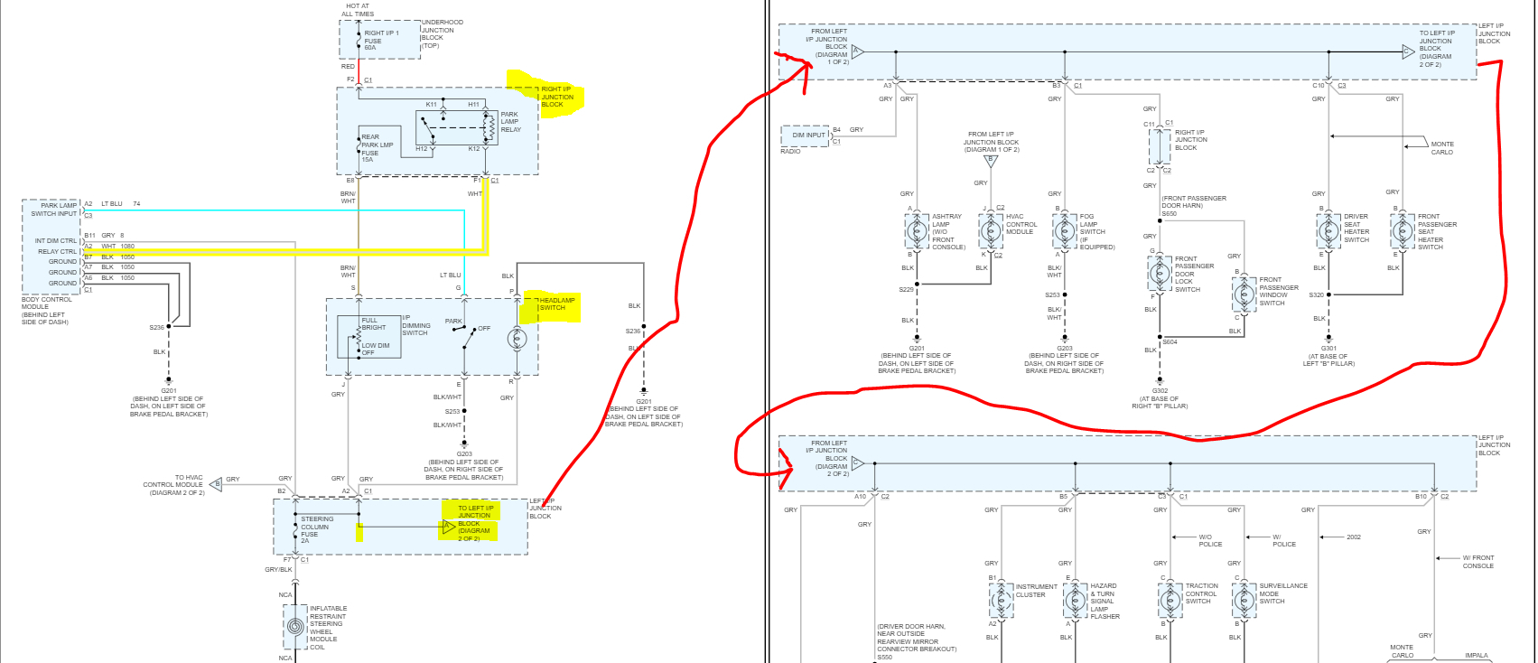

If none of that helps, I suspect you either have a bad parking light relay or the headlamp switch itself is bad. If you look at pic 2, I show power distribution to the parking lights, instrument panel and it all goes through the relay. If you disconnect the headlamp switch and it doesn't blow the fuse, there is a good chance it's the switch. If it still does, remove the relay and see what happens.
