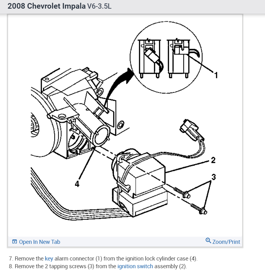

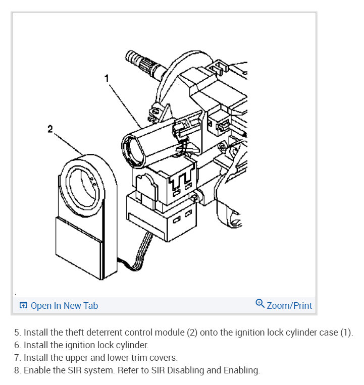

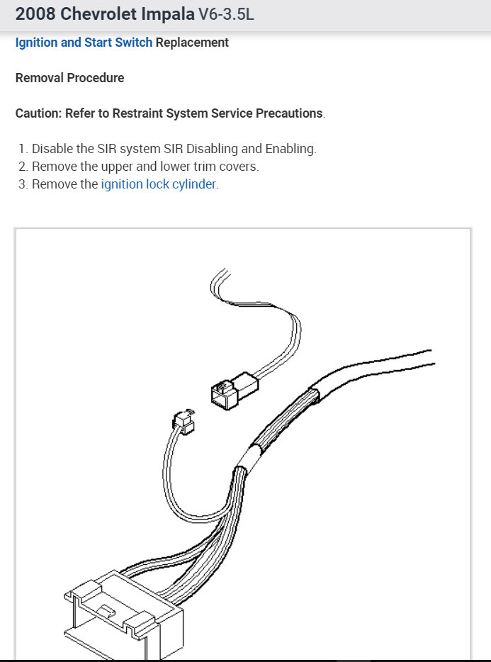

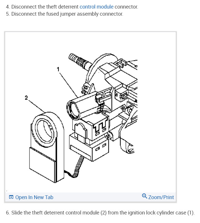

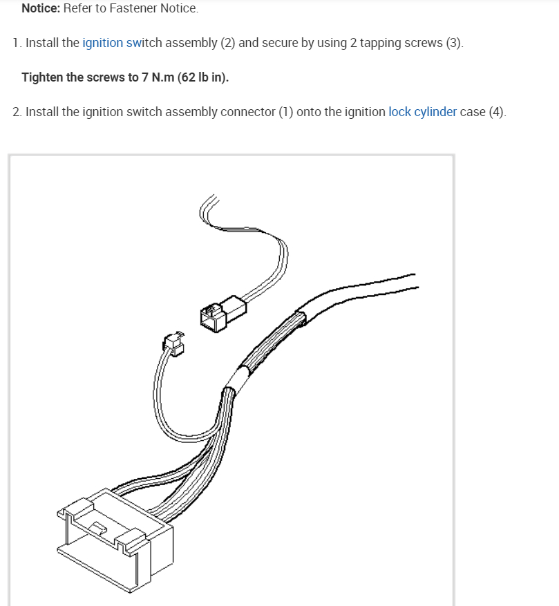

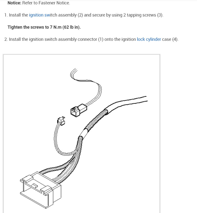

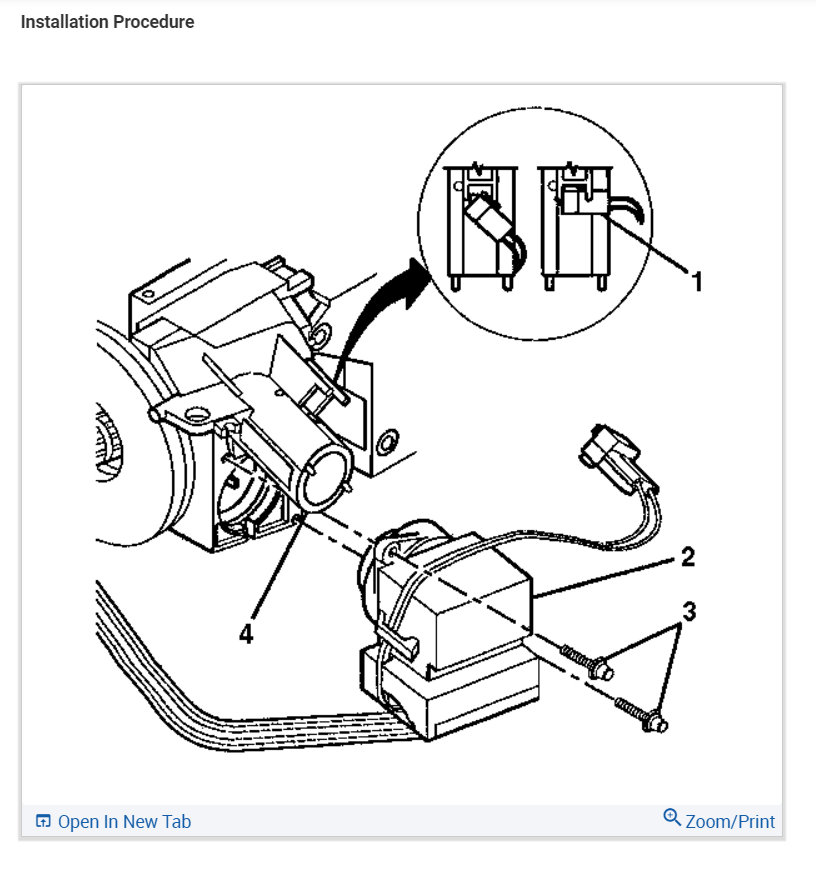

When I turn on the ignition the radio and dash board lights some times come on and some times they do not. The key is stiff and sometimes it will not start
Jun 13, 2017 at 4:45 AM
STEVE W.
  • 15,146 POSTS
Sounds like a failing ignition switch or cylinder. These were subject to a recall for the ignition switch so you might want to make sure that was completed. If not here are the instructions in the diagrams below to show you how to replace the ignition switch which should fix the problem. Check out the diagrams (Below). Please let us know what happens.
Jun 13, 2017 at 8:16 PM
LADAWN
  • 0 POST
Getting a new ignition switch from the dealer cost me $162.00 fixed it.

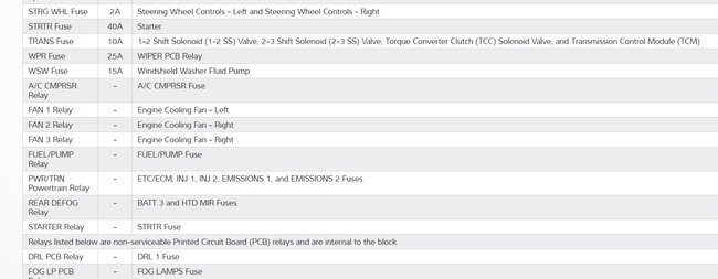

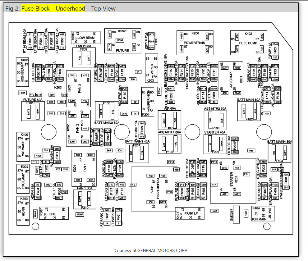

FRIDAY5PUD

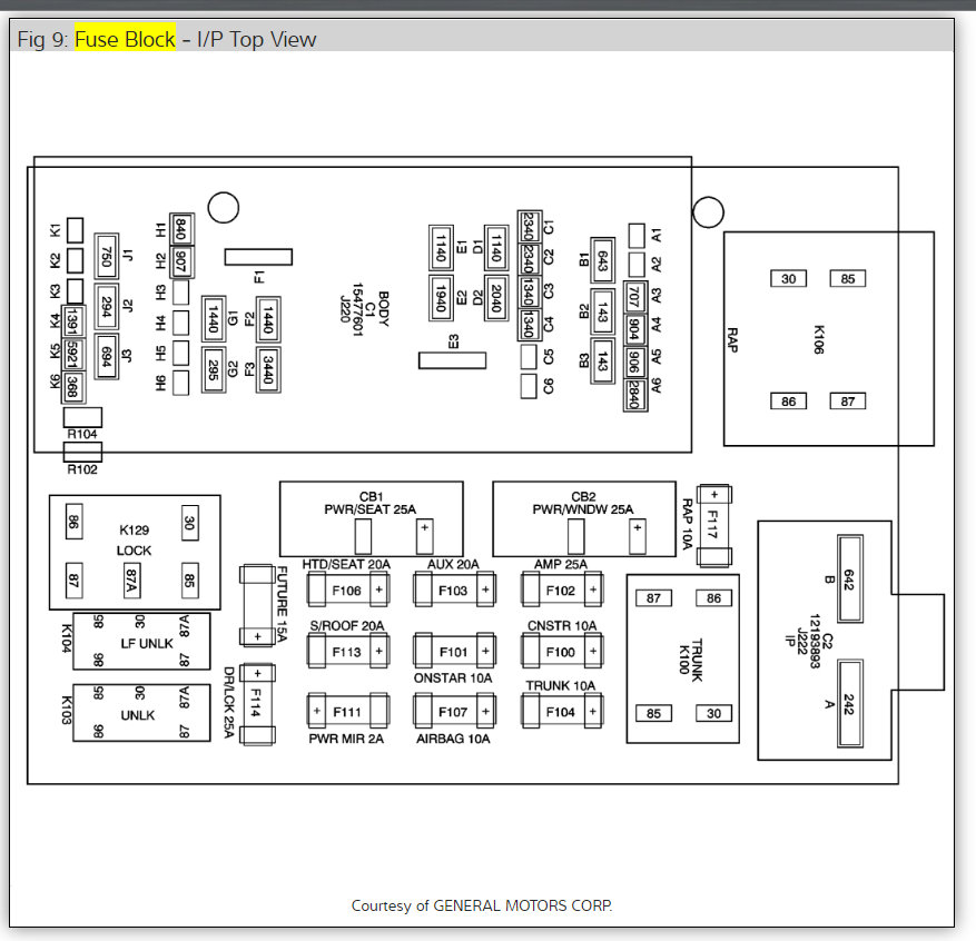

I am driving a rental car and I had no dash light come on this morning. There is no indication in the book as to what this means. Is there somewhere I can go on-line that would give me a list of what these warnings are and what to do about them? Thanks!
Aug 23, 2019 at 3:59 PM (Merged)

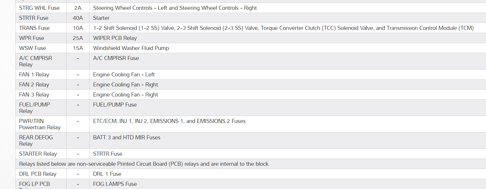

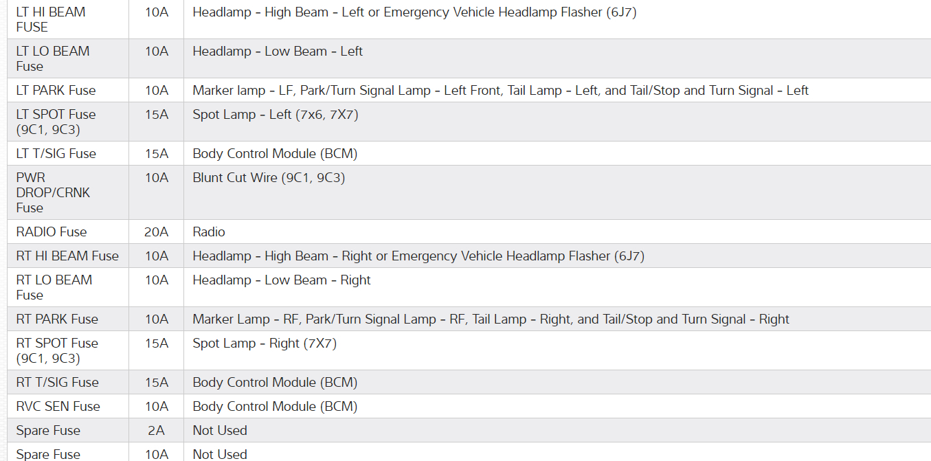

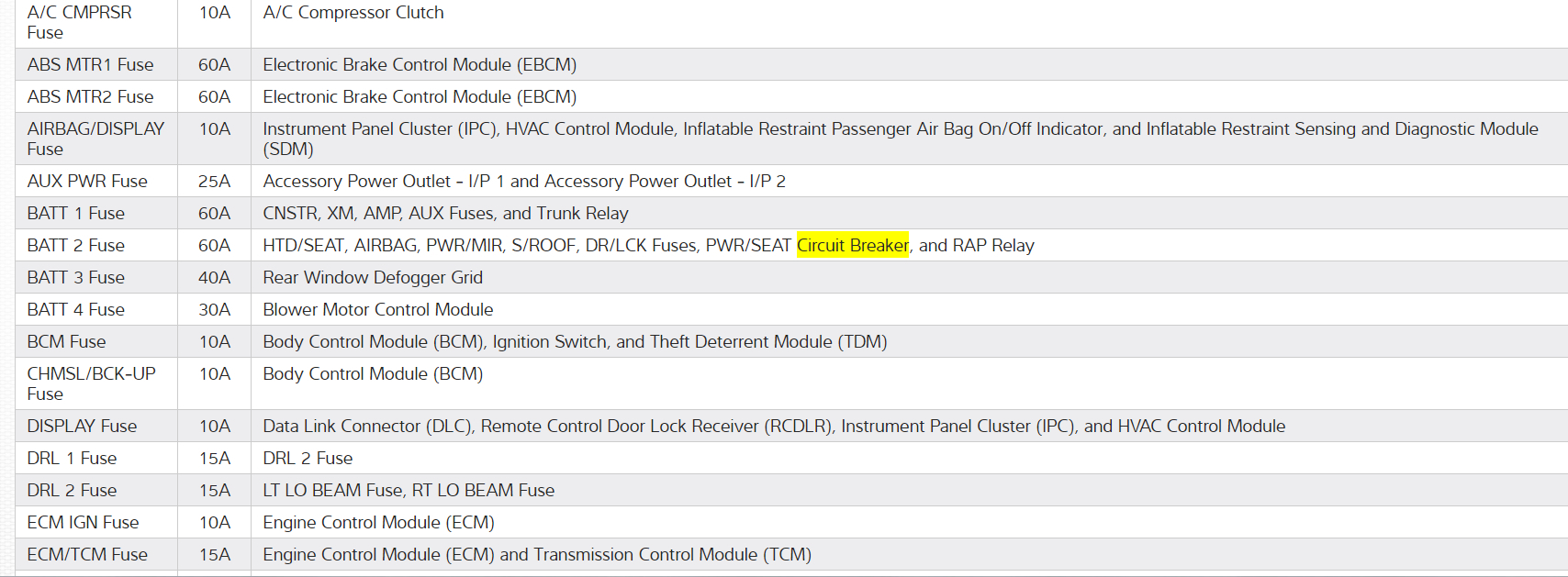

SERVICE WRITER
  • 9,123 POSTS

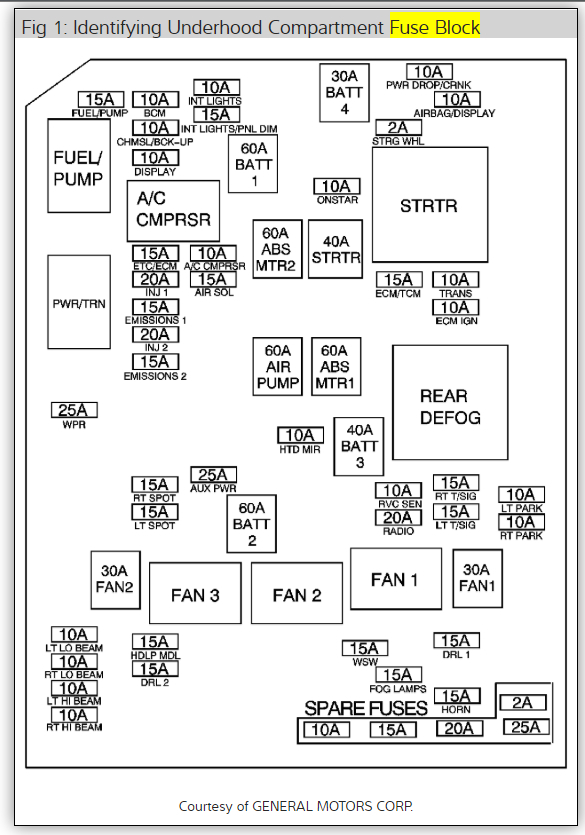

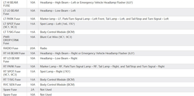

It sounds like a fuse is out here is a guide to help you test them with the fuse locations below.
Check out the diagrams (Below). Please let us know what you find. We are interested to see what it is.

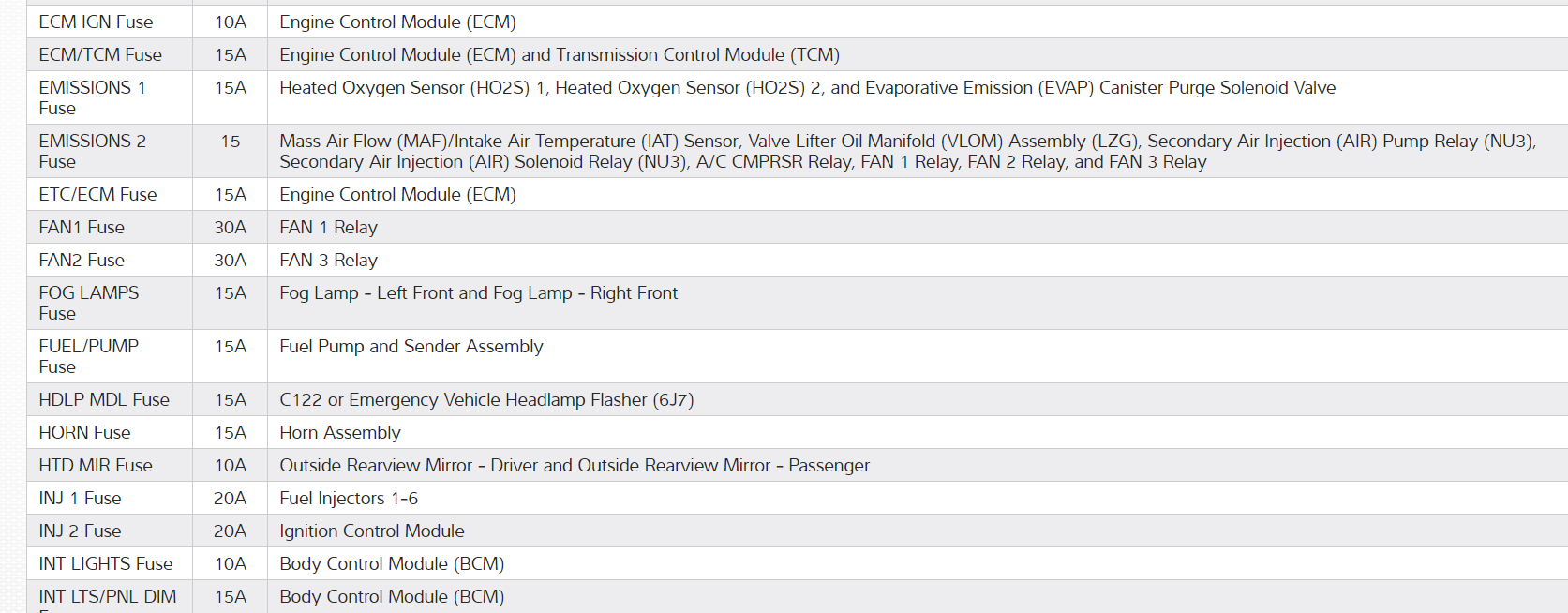

I asked the question about "dash lights in a chevy impala'03 LS", your repy was to check fuses and rhetsostat, I did all this and they still dont want to work. any more suggestions???
Aug 23, 2019 at 4:02 PM (Merged)
JDL
  • 16,098 POSTS

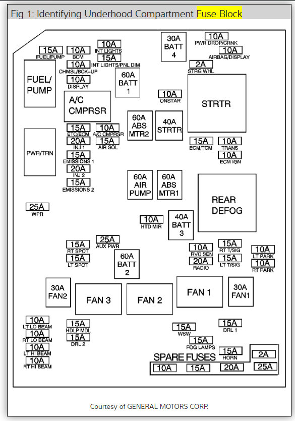

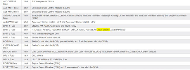

So the dimmer for your interior lites, has no effect? Any applicable fuse, did you check for voltage on the fuse circuit, using a voltage tester? Even if the fuse is good, if no voltage, the circuit is dead.

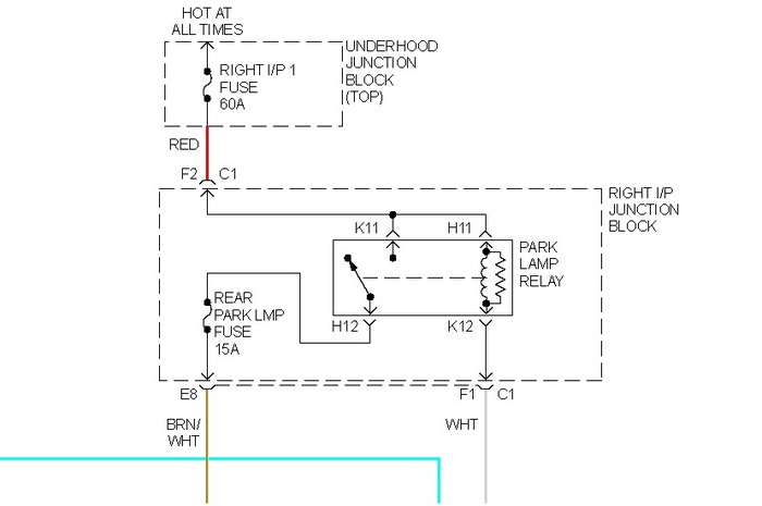

JDL
  • 16,098 POSTS

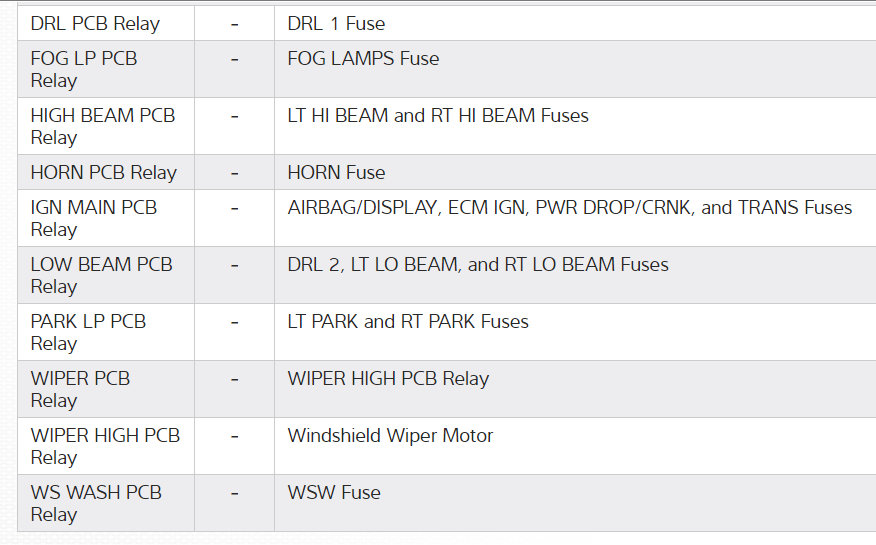

Here are a couple fuses to check. You see the park lamp relay, the squiggle line on the right side, that is ground for the relay. Grounded by the bcm. The bcm has to receive a sense signal from the headlamp switch, to ground the relay.
