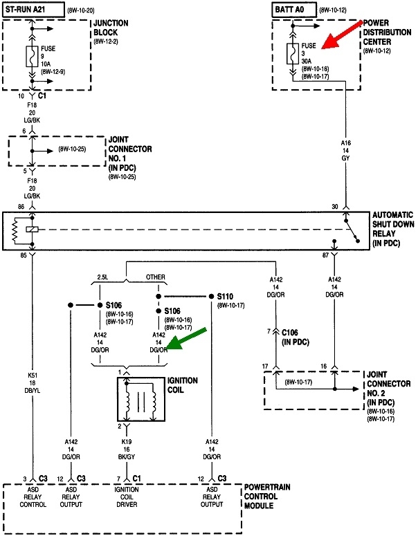

Won't start, no spark. changed plugs, wires, cap, rotor, cam sensor, crank sensor, map sensor, tp sensor, new starter, new coil, new battery, new ASD relay. switched various relays around. Wont start no spark??? Really need help. No power at coil.

Your last sentence is the key. You should be checking on the dark green/orange wire at the ignition coil or at any of the injectors, but this should be done with a test light, not with a digital voltmeter. Voltmeters don't respond fast enough. The next item of importance is if you were testing at the coil with the ignition switch on, there won't be any voltage there unless a helper is cranking the engine. 12 volts will only be there for one second when you turn on the ignition switch, then it will go back to 0 volts. Most voltmeters won't catch that because it occurs too quickly.
With the test light on the dark green/orange wire, watch what happens when a helper turns the ignition switch on. It should light up full brightness, then turn off. If it does, that tells us the automatic shutdown, (ASD), relay is working, the Engine Computer has control of it, and fuse # 3 is okay.
Next, that 12 volts at the coil must come back during engine rotation, (cranking or running). If it does not, we have to look at the signals from the crankshaft position sensor and the camshaft position sensor. The place to start with this is by reading and recording any diagnostic fault codes. Chrysler made doing that yourself much easier than any other manufacturer. Cycle the ignition switch from "off" to "run" three times within five seconds without cranking the engine, leave it in "run", then watch the odometer readout to see the fault codes. You can go here:

Recheck the voltage at the ignition coil, and read the diagnostic fault codes, and tell me what you find.

So I put a test light on the coil plug in an had someone else try start it the test light lit up, but no start. Then I checked spark isn't any. as for codes there isn't any either switching key on an off or hooking up a code reader.

Originally you said there was no 12 volts to the ignition coil. Now you're saying the test light turns on at the same test point. Is that just for that initial one second or all the while the engine is cranking?
If the test light turns on steady while cranking the engine, the better suspect is a dead fuel pump. You may be able to hear its hum for that one second when you turn on the ignition switch. If you can't hear it, try banging on the bottom of the gas tank while your helper is cranking the engine. That will often get a Chrysler fuel pump started. When that works, that is not the fix. The pump must be replaced due to worn brushes in the motor. Check the fuel pressure too. Even when the crankshaft or camshaft position sensor signals are missing, the pump still runs for that initial one second. That is enough to bring fuel pressure up to normal. If you need it, here's an article about testing fuel pumps:
