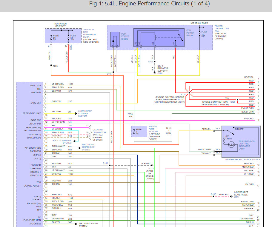

I took a (cheapo) oscilloscope and back probed on cylinder 5 harness with it connected to the cylinder 5 coil pack. 12V at one side (engine running), and the other side showed activity but it was more like spasms than a "pulse" like you might expect. I looked at the same on cylinder 1 coil pack and got a fairly clear waveform more like you would expect to see.
But that's where I am now stuck. I don't have wiring diagrams or other information handy to know where the wires trace back through the loom. I don't know if there is any point in which the wires from the PCM to the coil packs for cylinders 5, 7, and 8 might be near one another or feed off a shared ground, etc. Is there a bulkhead connector I should check? Where is the PCM located and how is it removed?

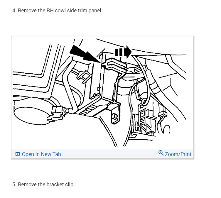

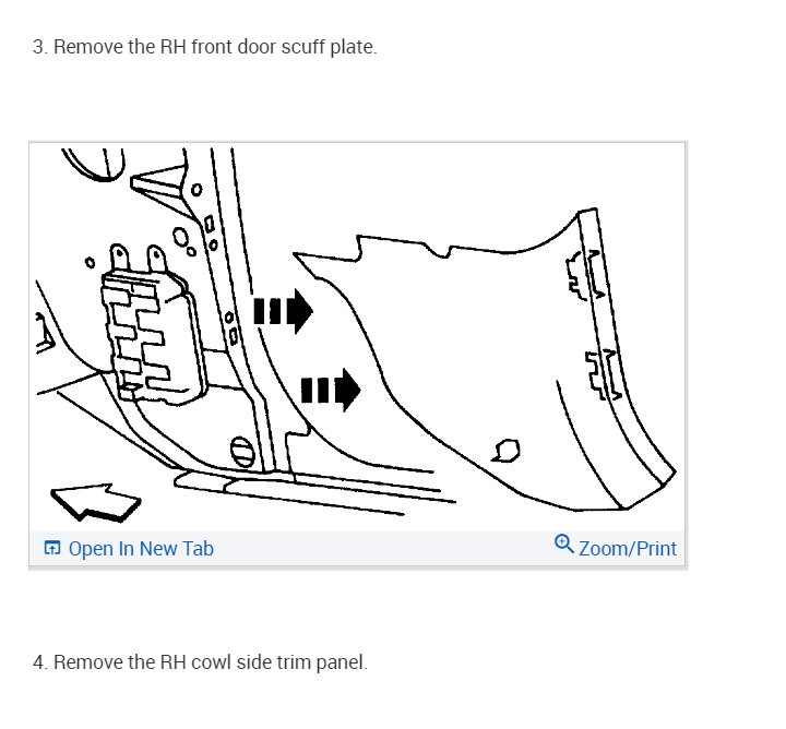

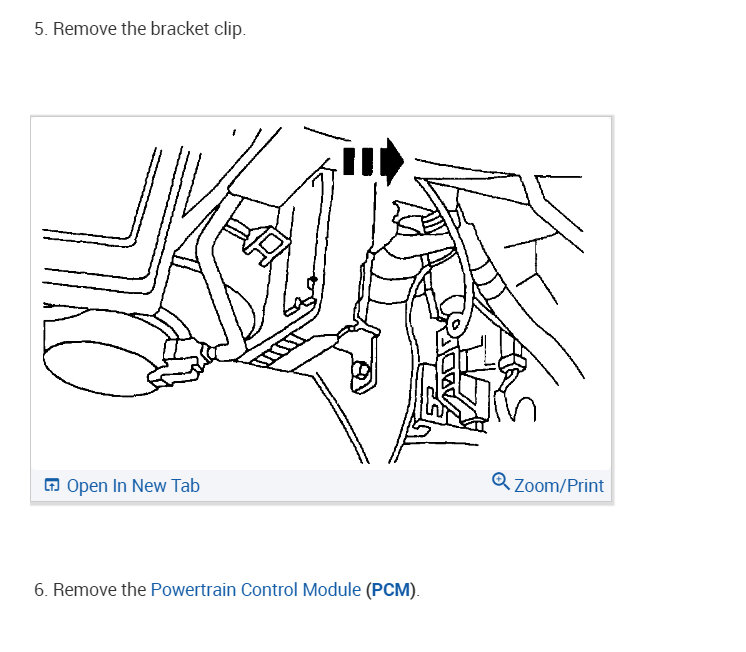

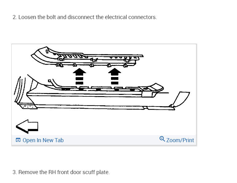

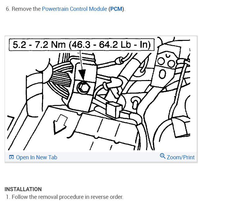

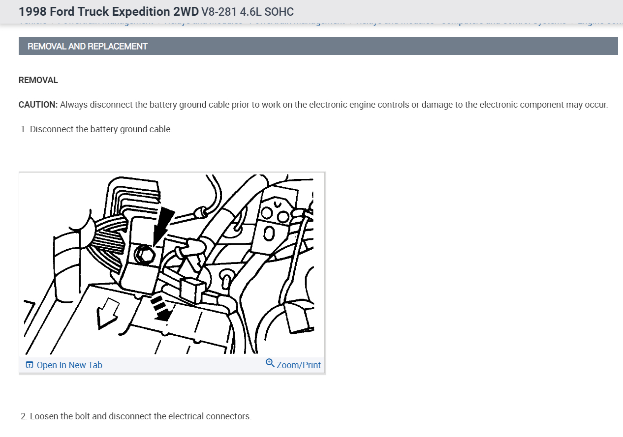

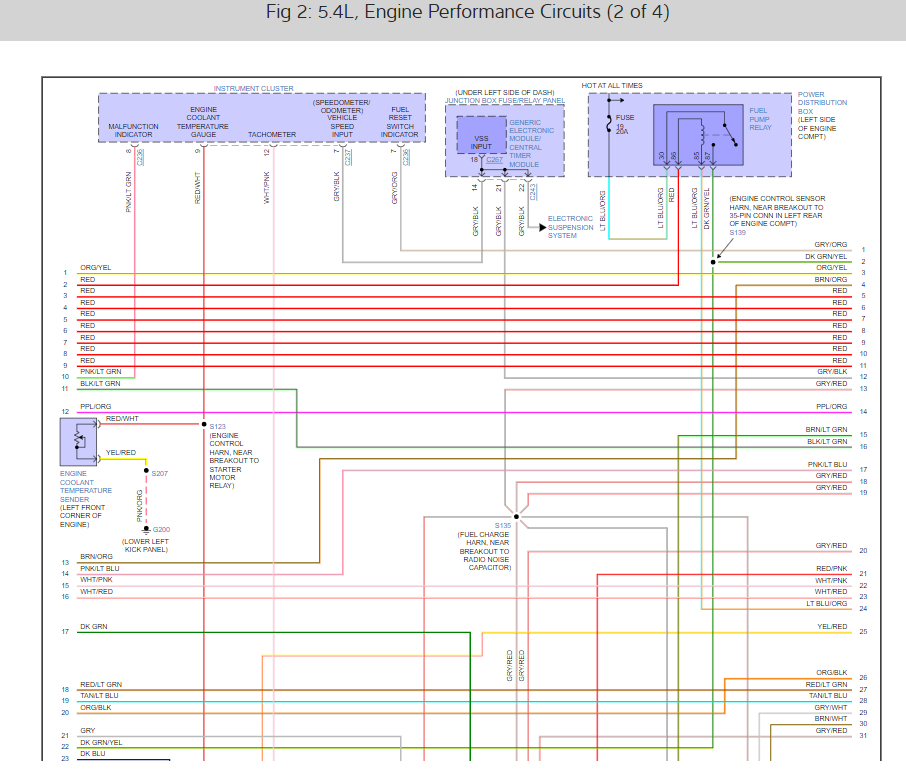

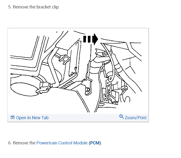

Yep, we should get it running so you can get top dollar for it, it sounds like the PCM has failed but I have found the wiring diagrams so you can check it out.
Here is a guide to help you check the wiring and connections:
Here is how to change out the PCM in case you need it as well. BTW the PCM is plug and play, no programming is needed. Check out the images (below). Please let us know what you find. We are interested to see what it is.

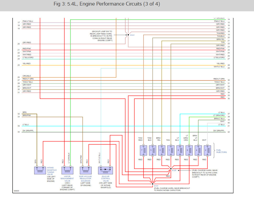

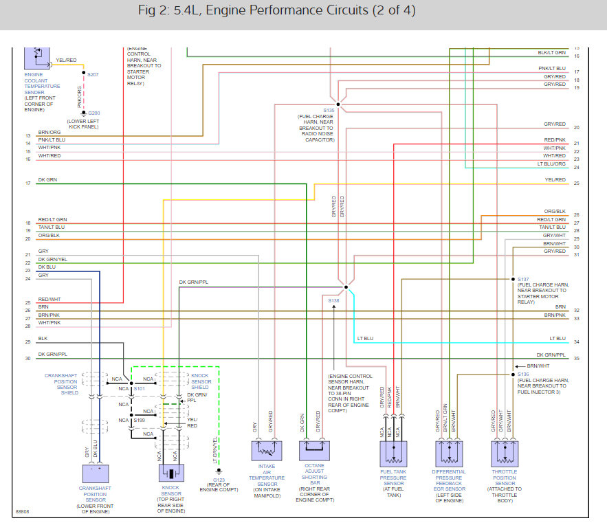

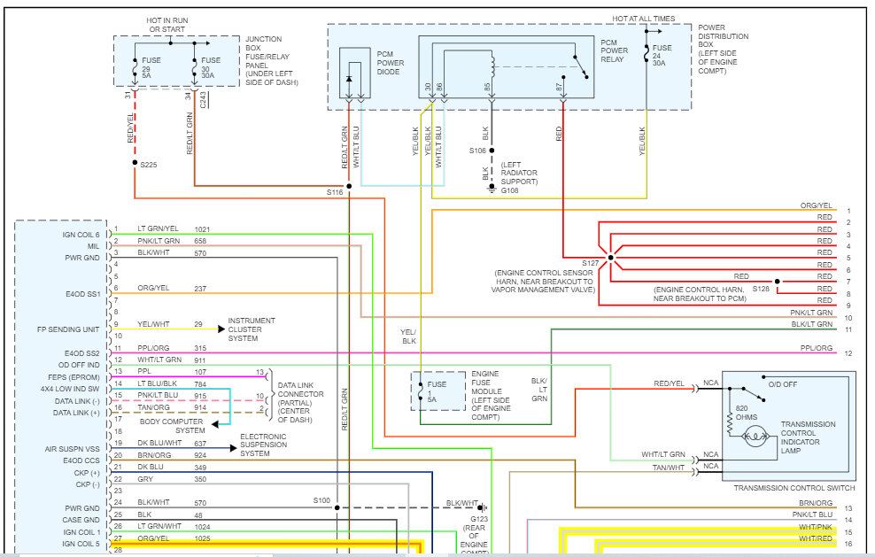

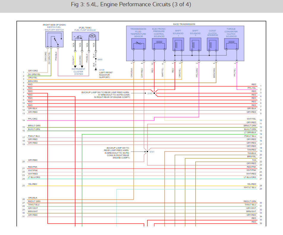

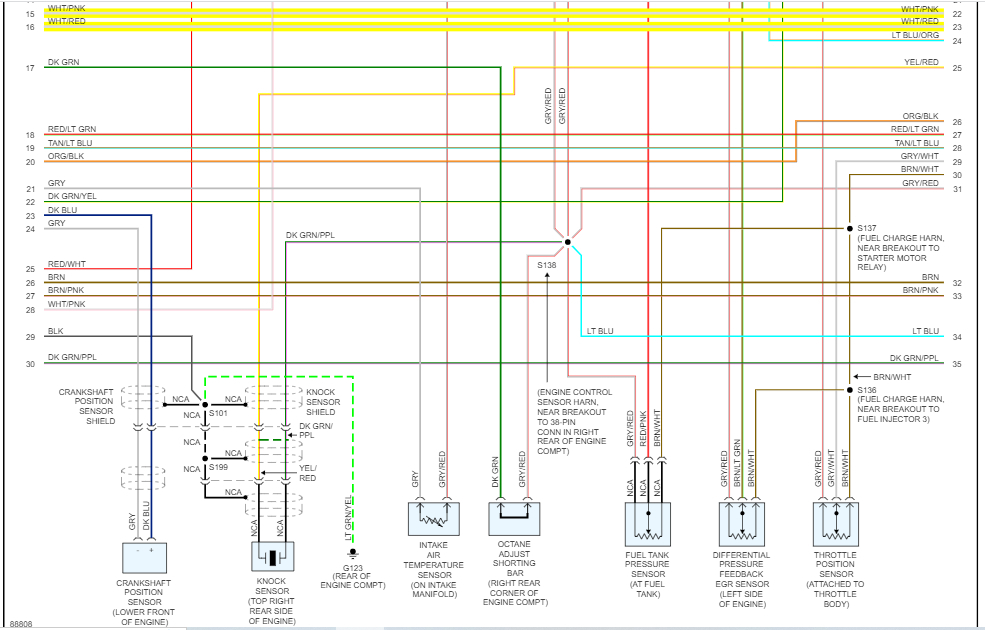

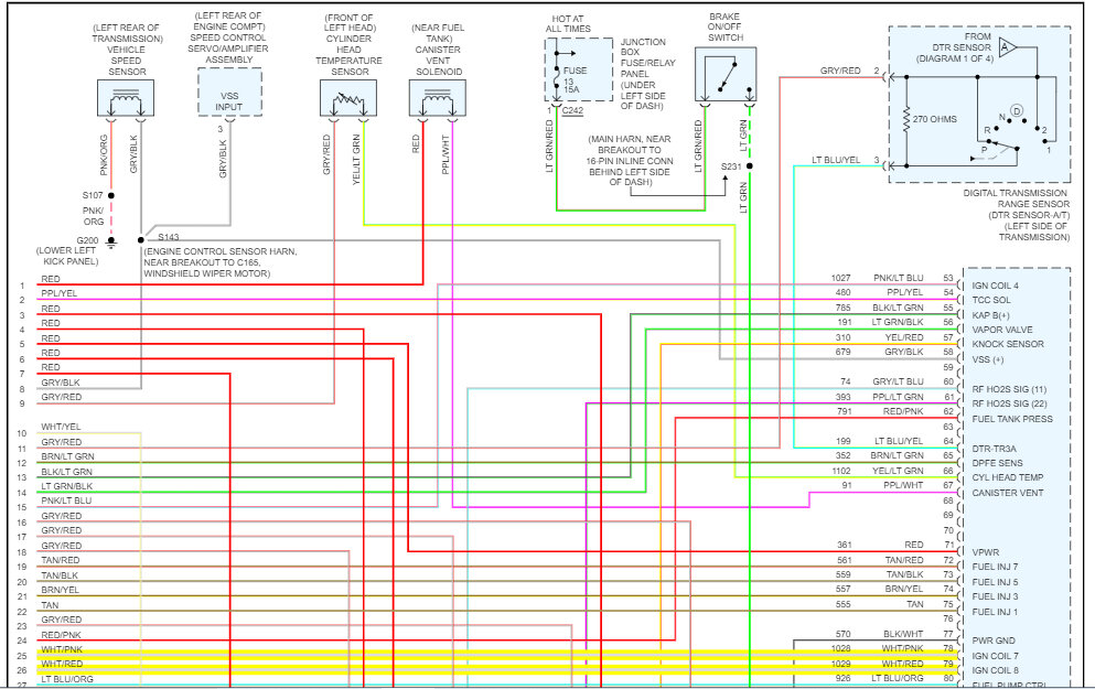

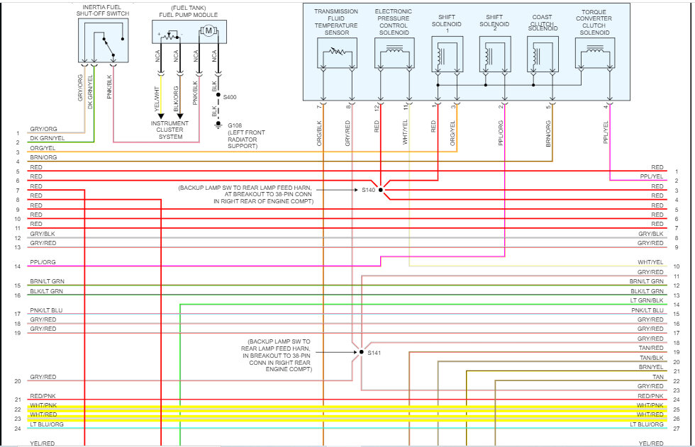

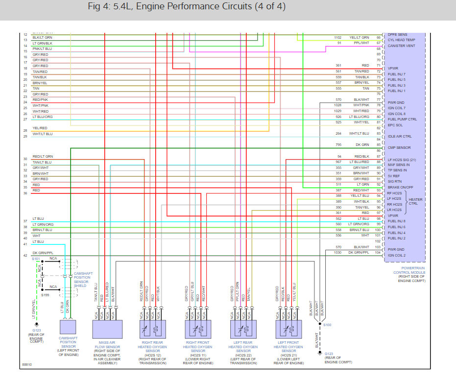

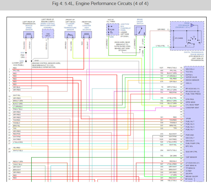

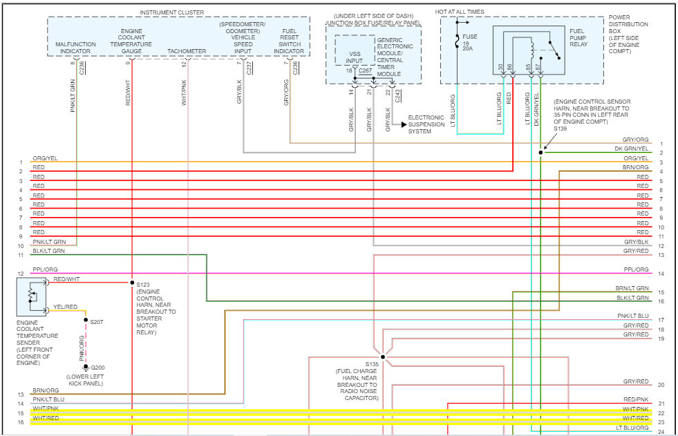

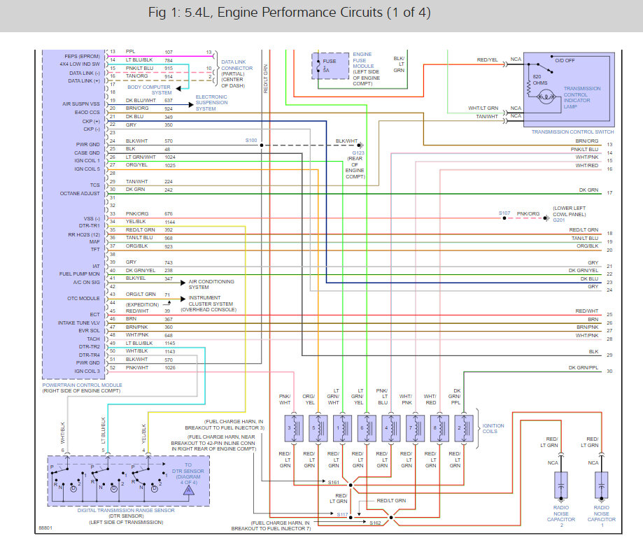

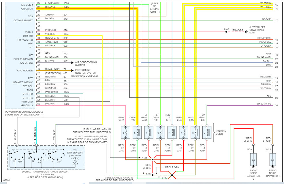

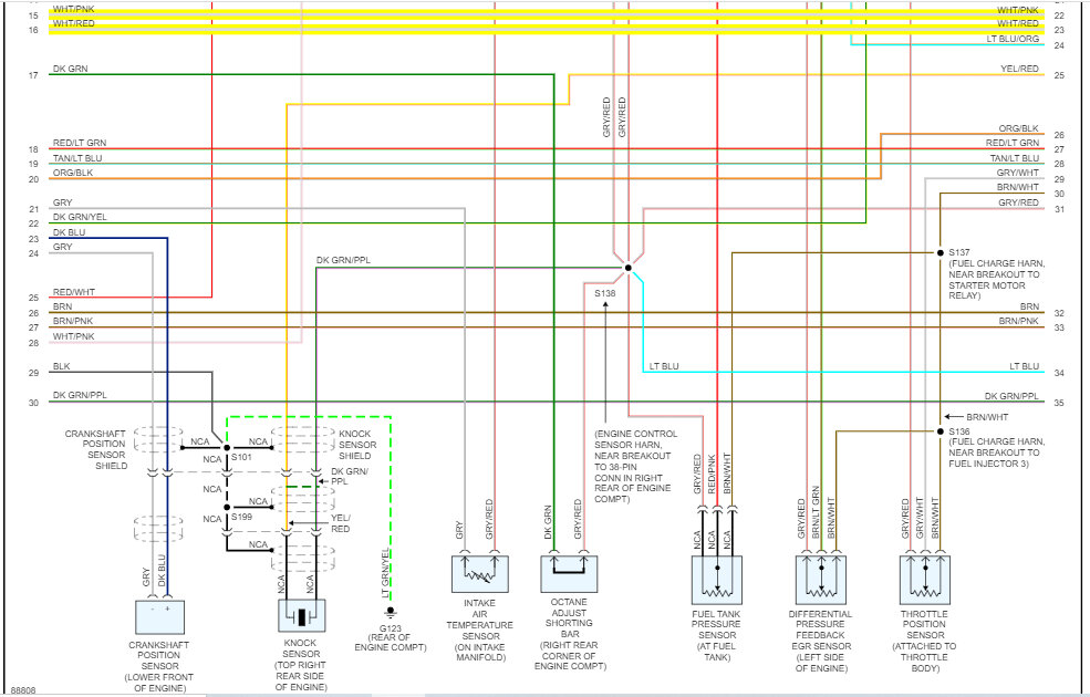

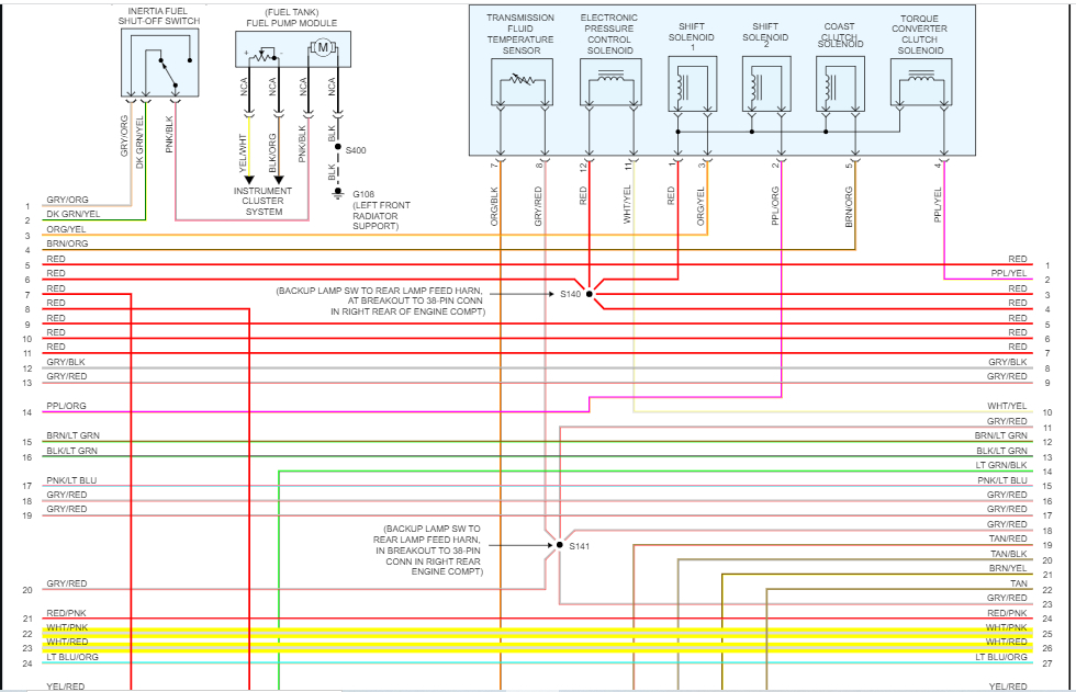

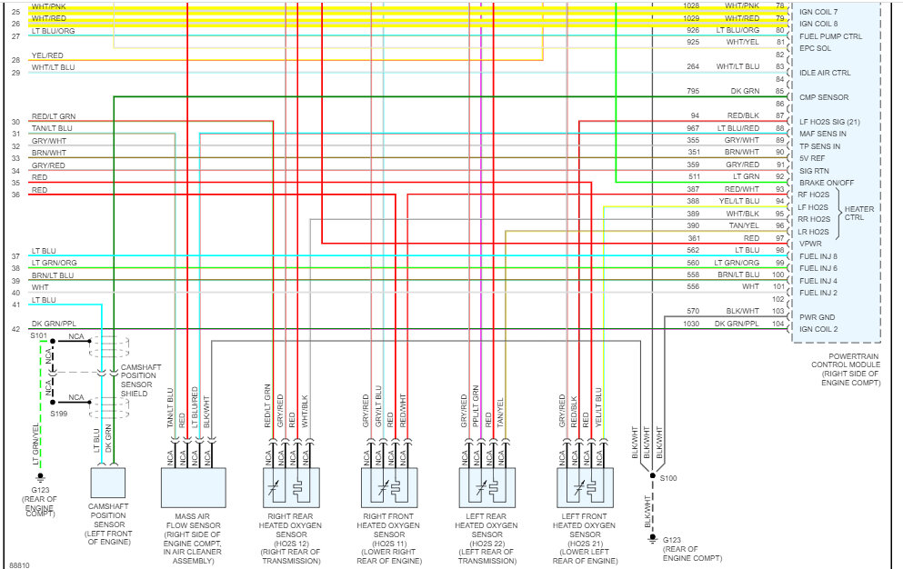

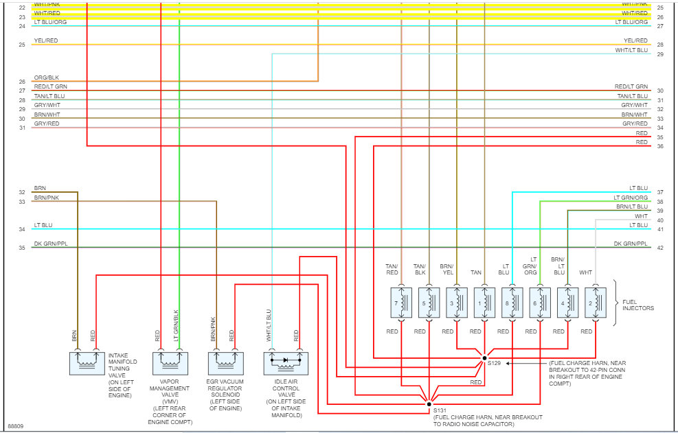

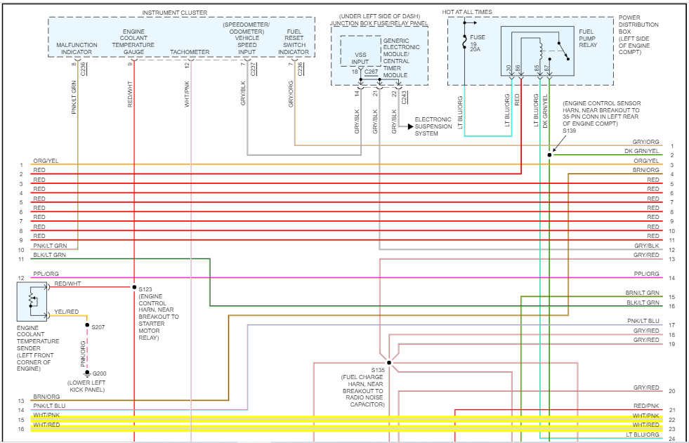

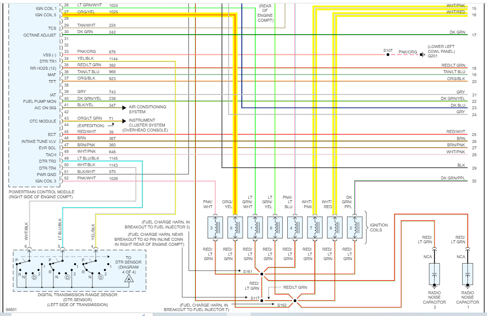

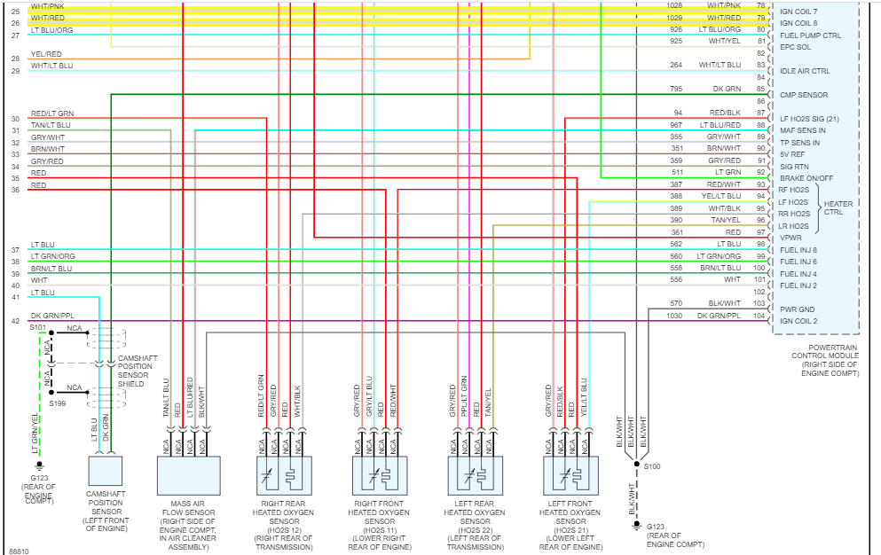

The ignition coils receive power from the same location. However, each coil has a separate ground path provided by the PCM.
I attached the entire powertrain wiring schematic below for you. I highlighted the ground wires for the affected coils. Since the vehicle sat unused for a year, I have a feeling a mouse got at the wiring.
Take a look through the schematic and let me know if it helps.
Take care and let me know what you find,

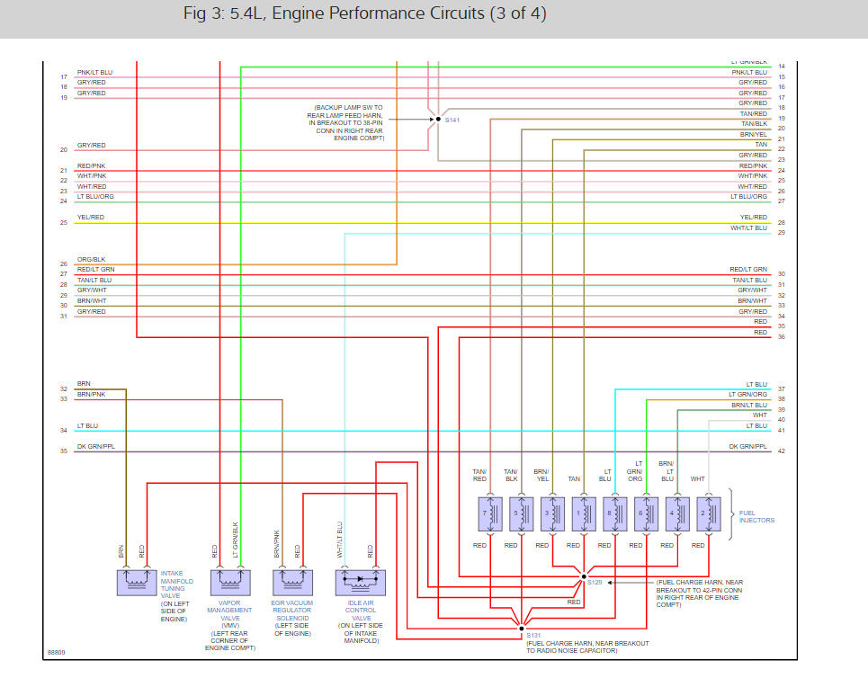

See pics below. Note: The schematic is 4 pages long. I had to cut each page in half to make it readable for you. I did overlap them so you can follow from one to the next. With that in mind, in order, every two pics below equals one page from the manual.
