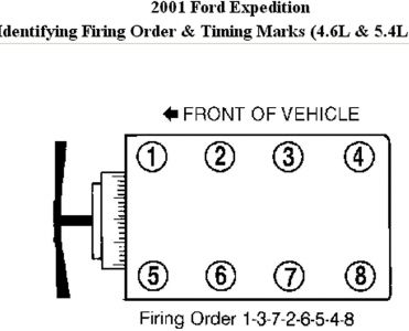

I know that my #7 Spark plug is not firing. How do I know which Spark Plug is #7?

My suggestion is to swap the #7 plug and the # 5 plug.
And swap the #7 wire and the # 6 wire to see if your misfire move to help nail down the problem.
