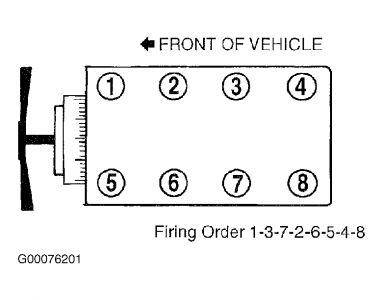

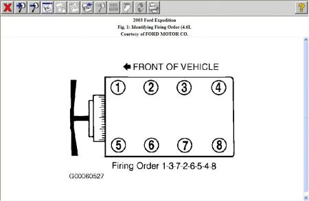

JOEJAN
V8 four wheel drive automatic 211,097 miles.
What is the firing order for my SUV?

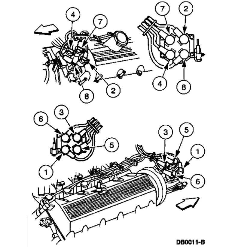

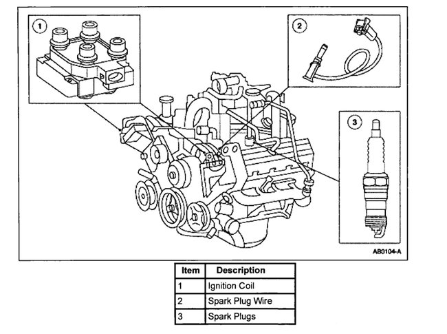

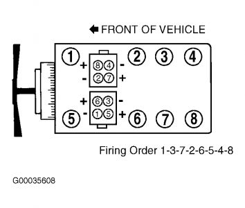

YOBEGAY
I was wondering how are the coils placed in the engine by numbers? Where are they placed (1,2,3,4,5,6,7,and 8) What number is on passanger side and what numbers are on driver side. If you could let me know. I'm getting confused on it. Thanks.

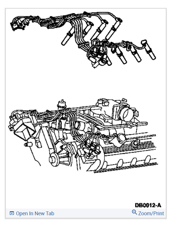

RICHARDWARD
the car has had it's plugs and wires changed but car is still misfiring is the firing order is correct ?

DAVE H
  • 13,384 POSTS
Here is the engine firing order so you can check it please look at the diagrams below as well
Firing Order 1-3-7-2-6-5-4-8
The RH (Passenger's) side .................... Cylinders 1, 2, 3, and 4
The LH (Driver's side) .................... Cylinders 5, 6, 7 and 8
