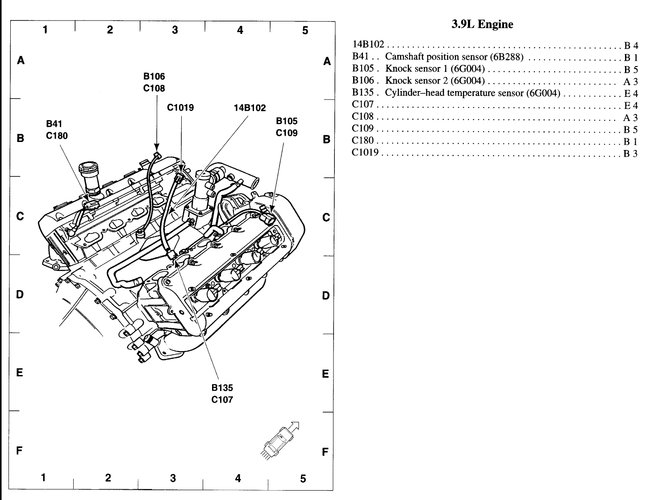

is this sensor under the intake manifold (plenum)? If so is there anyway I can move the sensor to a different location?
Oct 4, 2017 at 1:01 PM
STEVE W.
  • 15,345 POSTS
Yes the sensor is under the intake. It is item B135. No you cannot re-locate it somewhere else and have it actually work properly.
