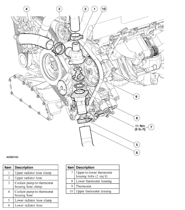

If thermostat does not open then engine will begin to overheat and heater will not blow warm air correctly. Here is a guide to help walk you through the steps of the thermostat replacement with instructions and the thermostat location in the diagrams below for your car.

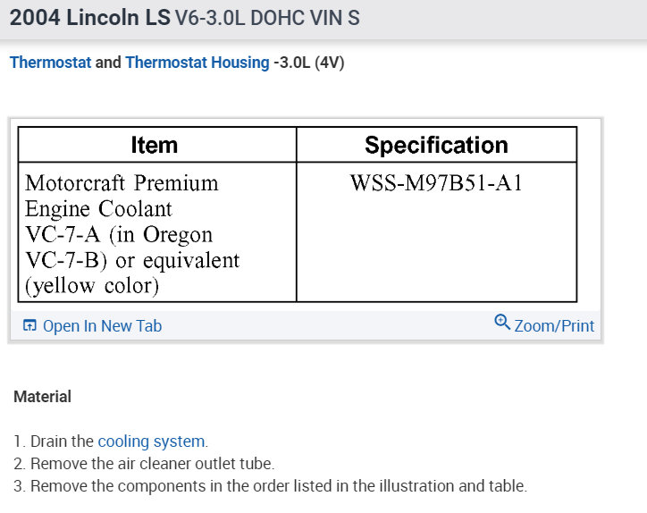

Remove the air cleaner outlet tube.
Drain the cooling system.
Disconnect and position the lower radiator hose out of the way.
Remove the bolts and the thermostat housing.
Remove the thermostat and the O-ring.
To install:
NOTE
Clean all the sealing surfaces and inspect the O-ring seals thoroughly.
Replace the thermostat and the O-ring.
Install the bolts and the thermostat housing.
Connect the lower radiator hose.
+2

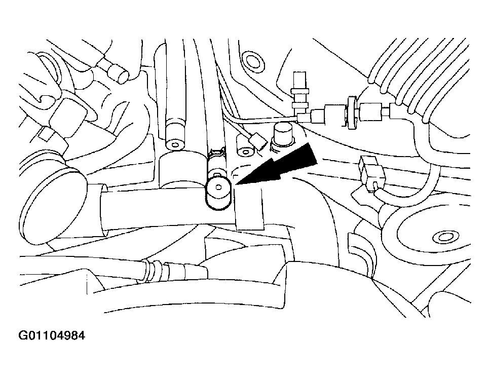

My heater wasn't working while I was driving, it only heated up and blew hot air when the car was idoling. So, someone told me it was my thermostat when it did that. So I replaced the thermostat and now the car doesn't blow hot air at all. What could the problem be if it blew hot air before we replaced the thermostat only when the car was idoling and not driving. But now it doesn't blow hot air when idoling or driving. Hope you can help me, thank you so much.

Was air bleed valve open during filling?
Tuesday, August 20th, 2019 AT 12:46 PM (Merged)
HPEEL24
Im not sure, im not the one that put it on. But someone did say maybe I need to burp it, whatever that means. Does that sound right to you?
+1
DOCFIXIT
  • 18,828 POSTS
Air must be removed open valve cap off fill till coolant comes out valve
+1
