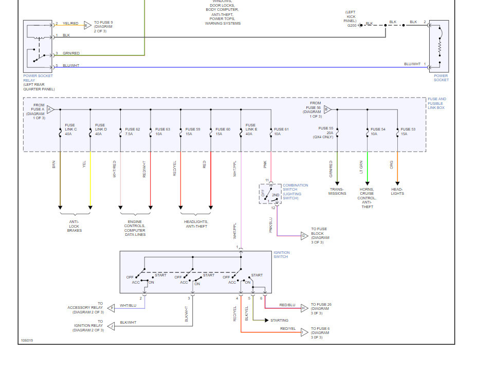

okay, my boyfriend broke the key off in the ignition of my vehicle listed above SE model. it was running just fine start every time with the broken key still in the ignition and then my dad went and took a pic to pick up the key piece and got it stuck. now it won't start in the meantime a friend of mine. I cut all the wires to the ignition and the starter in hook the two starter wires together with the ignition wire to put a toggle switch in a push button. help I don't have a spare key and I don't have the other piece of the key and I have no job and the security alarm system is programmed to the computer of the vehicle. I just want to drive my car please help me.

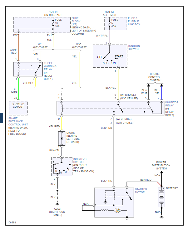

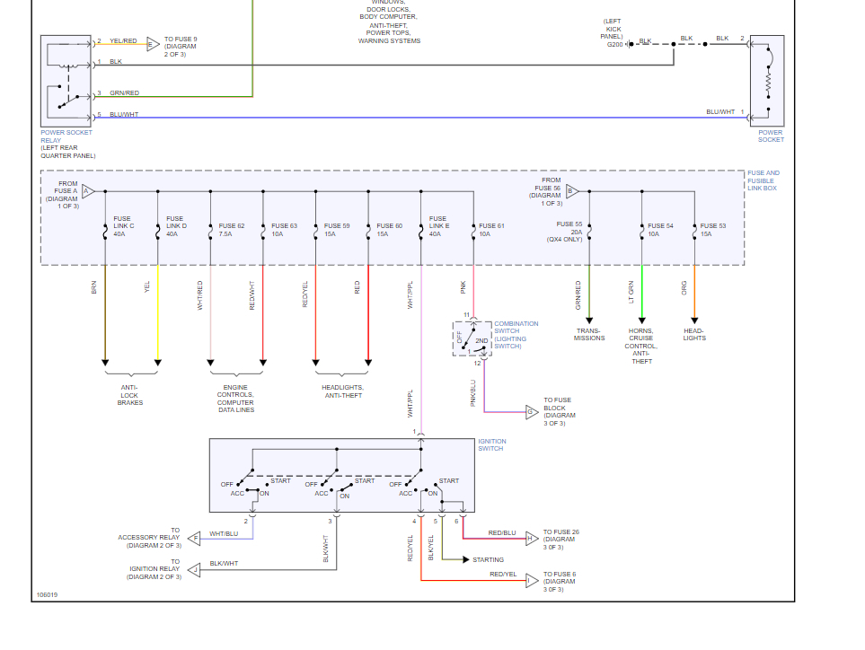

You will need to get a new lock and cylinder from the dealer with your VIN here are the ignition switch wiring diagrams so you can reinstall it correctly and instructions on how to replace the ignition lock.
STEERING LOCK & IGNITION SWITCH
Removal
Remove steering wheel if necessary for access. See STEERING WHEEL . Remove upper and lower steering column covers. Disconnect ignition switch harness connectors. If shear bolt studs are accessible, use a hacksaw to cut a slot into exposed studs. Using a screwdriver, remove studs.
If shear bolt studs are recessed or hard to reach, use a hammer and center punch to unscrew shear bolts. If unsuccessful, drill a hole in the shear bolts and remove with a screw extractor. Remove steering lock and ignition switch.
Installation
Install ignition switch. Install new shear bolts. Finger-tighten shear bolts. Ensure proper operation of steering lock and ignition switch. Tighten shear bolts until heads break off. To complete installation, reverse removal procedure.
