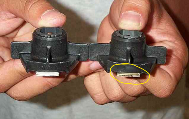

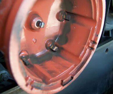

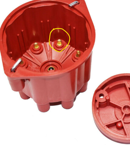

How does the distributor look? I would pull it off and look at the contacts inside on the cap and rotor. I have added images for both good and bad for you.
You won't only be looking at whether is it dirty but look for pits in them as well.

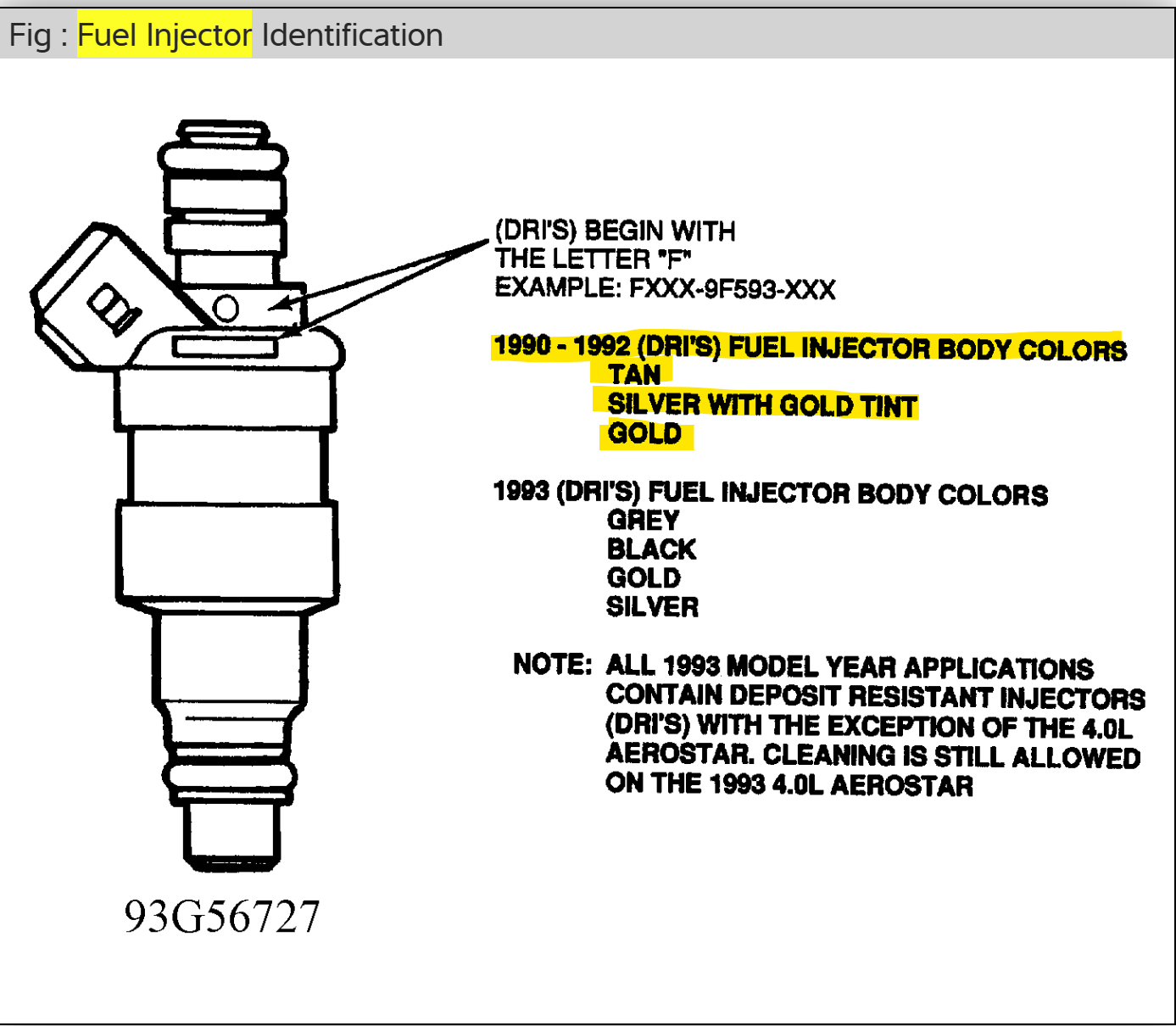

This condition has a lot of possibilities. Especially considering the vehicles age. Timing can be one of them. Fuel injectors would make sense because it ran after you sprayed the starting fluid. Dirty valves are another as well as ignition system issues.

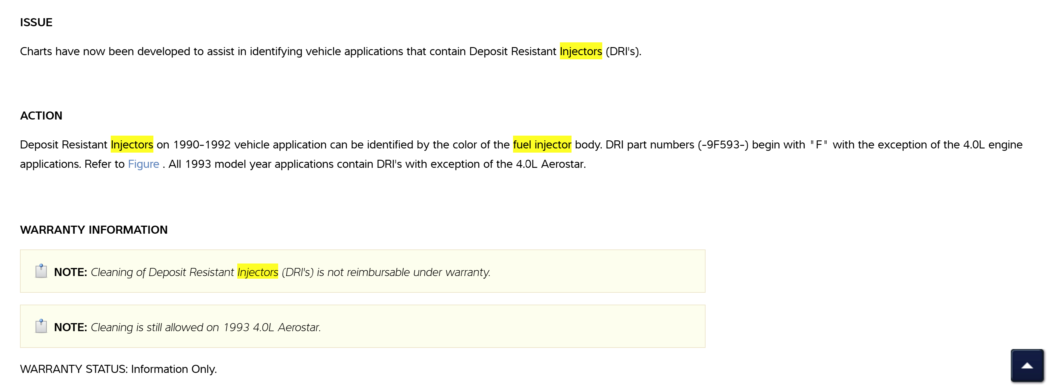

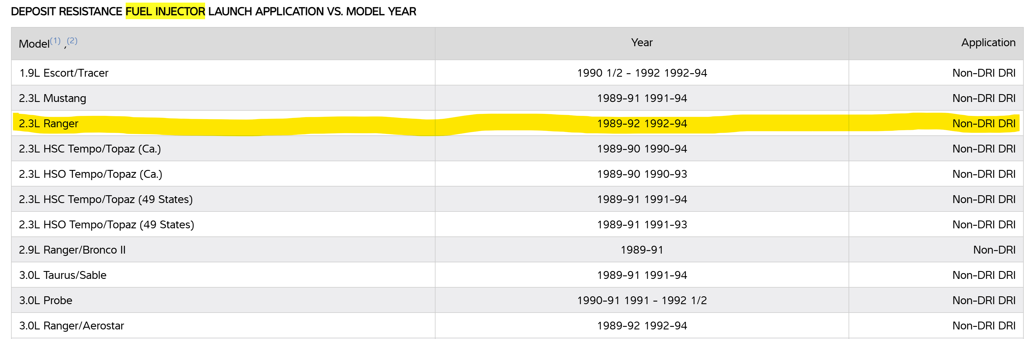

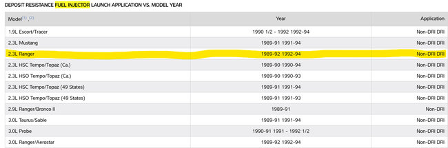

There is a Technical Service Bulletin or TSB on two different injectors. Some were Deposit Resistant Injector's or DRI's. Most Ford models had one or the other, including the 1992 Ford Ranger 2.3L. So, it is possible the injectors are gummed up because they aren't the DRI version.
However, they may have been replaced so I am going to add this bulletin for you so you can try to identify them since they will have a specific color if they are the DRI version.
To clean them you could try a bottle of Lucas Octane Booster. The lower grade fuel isn't made the same way it used to be. This can gum up injectors causing issues. The Octane booster will make the low-grade fuel burn better and clean the injectors at the same time.
I would try this and see if it changes things. You will have to spray some starting fluid and hit the gas to keep it running for a while. But for $12 a bottle it is worth trying.

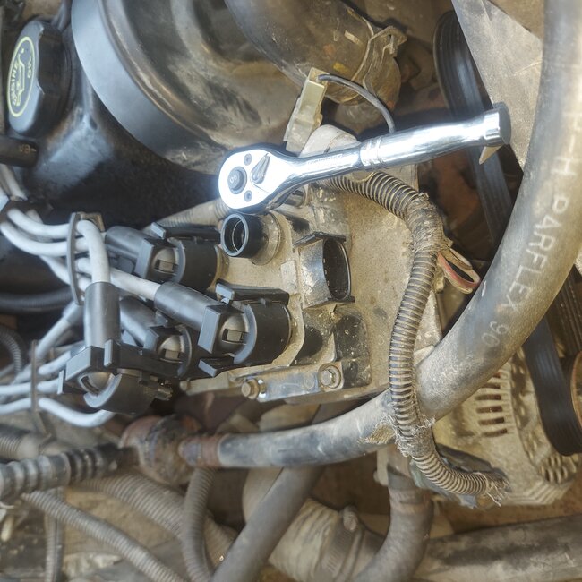

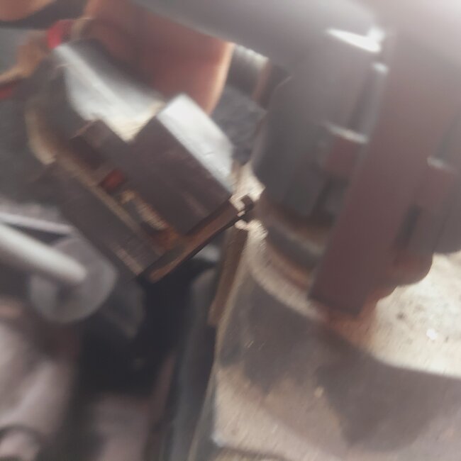

This truck does not have a distributor it has an electronic one and the coils are a closed thing.
Sep 11, 2023 at 8:47 AM
BRENDON S
  • 653 POSTS
Hello LI VORTXZ IL,
Ah. I see. Sorry when you are not there physically, you really on the service information. Unfortunately, it isn't always 100% accurate.

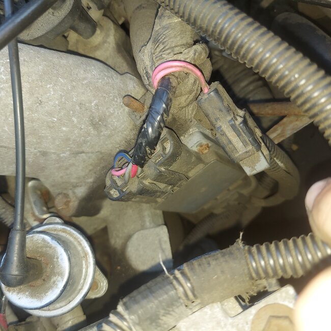

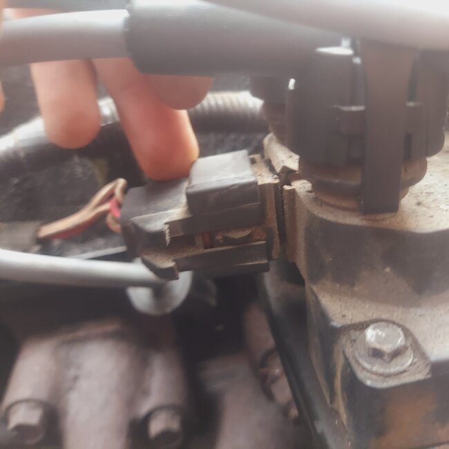

Thank you for the pictures.
Wires look new, did you just replace those?
It also looks like the are 8 wires. Maybe I am seeing something else. When you asked the question, you said it was a 2.3L. Could you verify your engine size for me?
Anything else replaced, besides the Mass Air Flow and Air Filter you already mentioned?
Do you have a spark tester? (see image)
If you do, I would see what you are getting for spark at each plug and see what you are getting. Just to rule it out.
Usually auto parts stores will have one in stock. You will need a friend to turn it over while you watch it though.

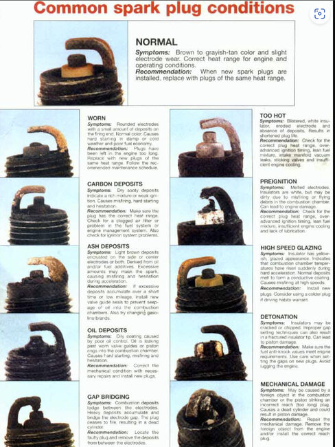

If that seems fine, I would pull the plugs out and see what they look like. I don't know if you replaced them or not.
I have attached a diagram showing common plug issues. See if any of them match. The spark plug can tell us a lot about how it is running.

Yeah, that's the first thing I tried my obd1 is getting no single.
Sep 11, 2023 at 10:03 AM
LI VORTXZ IL
  • 6 POSTS
I'm pretty sure that's broken it's to the coil pack.
