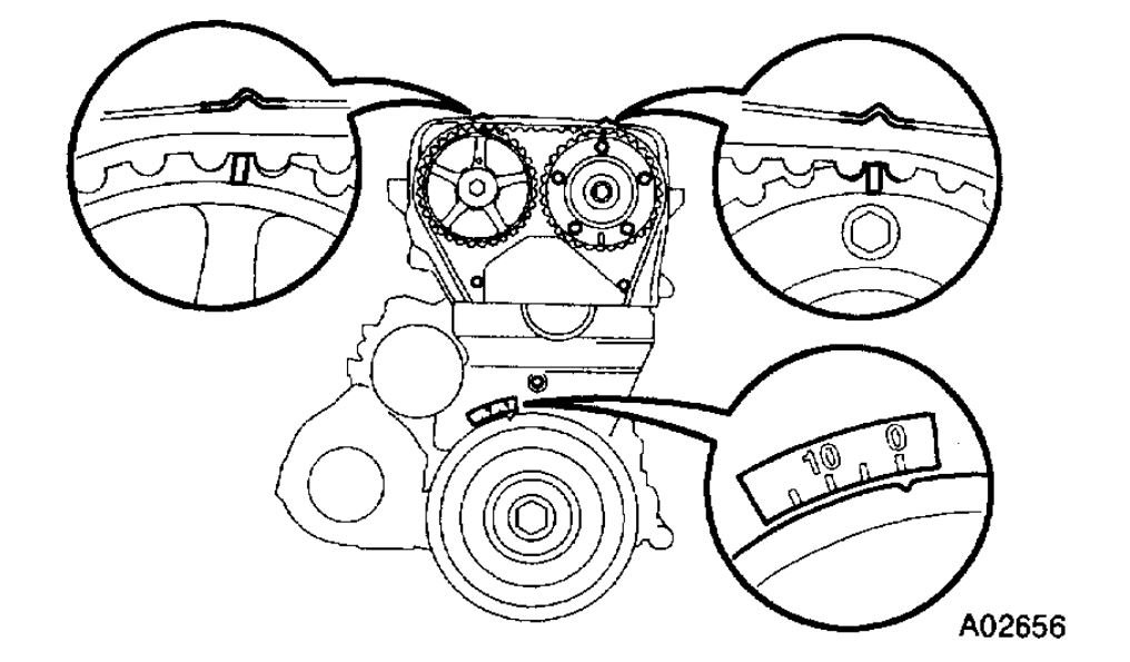

I have the car listed above 2jz-ge with vvdi. The water pump was replaced recently. Somehow the crankshaft was rotated and now can't get it back to TDC when I hand crank it. It seems to only go 180 degrees. Help is appreciated, thank you.
Sunday, May 3rd, 2020 AT 12:59 AM
12 Replies
  • 52,797 POSTS
Good morning,
Did you rotate the engine and it stopped turning?
Did you crank the engine at any time? I am worried that the timing being out, you may have damaged the valves and you have a valve hitting a piston.
https://www.2carpros.com/articles/how-a-timing-belt-works

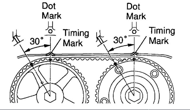

I attached the diagram of the marks and how they should be set.
See if that is where the timing line up.

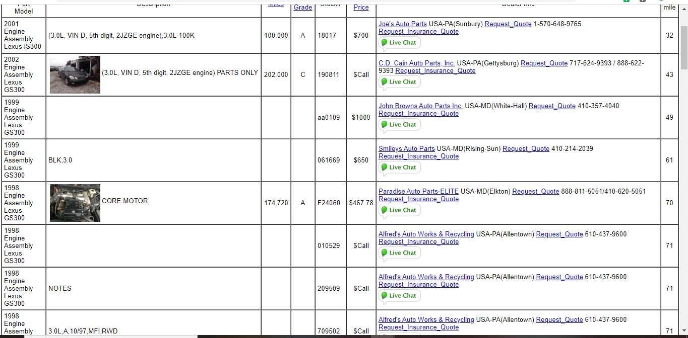

It was cranked, and I also came to the conclusion that valve is bent. I just wanted to run it by an expert. In your opinion, would you replace the cylinder block or try to fix the valves?
Sunday, May 3rd, 2020 AT 5:31 AM
  • 52,797 POSTS
The heads would have to be removed and inspected. At the same time, they need to look for piston damage. If there is, then you are talking a total overhaul.
My suggestion is to replace the engine with a good used motor. That would save you money fro both ends.
You can go to a site www. Car-part. Com and enter your information and there will be dozens listed from yards in your area.
I attached one page for you but I found over 400 available for you to view.
