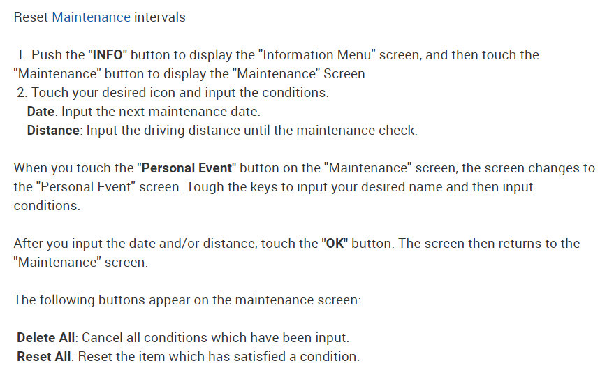

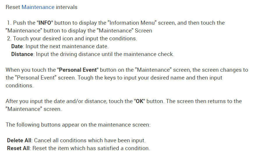

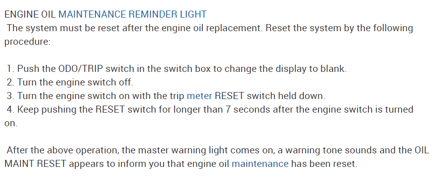

i just had the oil changed 300 miles ago and the service oil soon light is now on all the time.

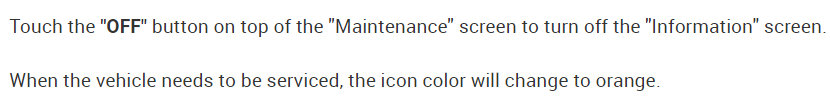

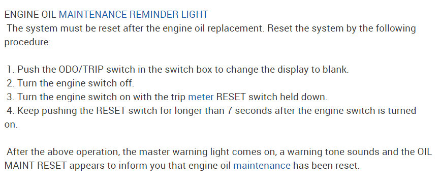

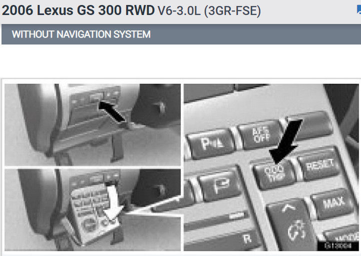

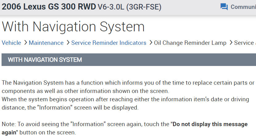

Hello, I'm Danny.
I've attached the information below you've requested. The pictures below include both with or without the navigation function on your car. I included both. Hope this helps and thanks for using 2CarPros.
