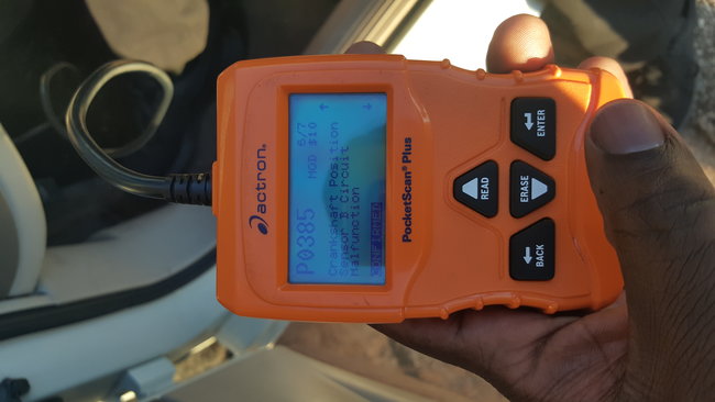

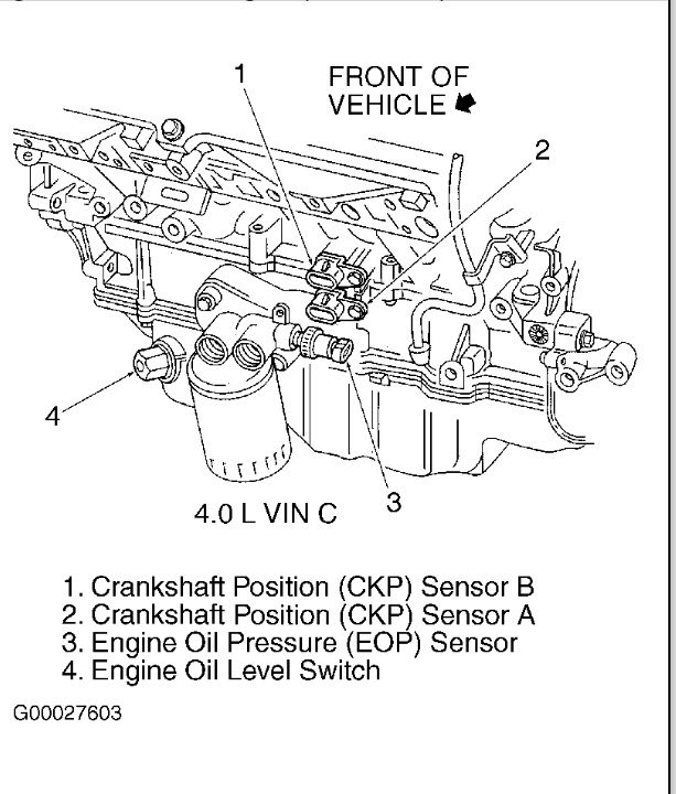

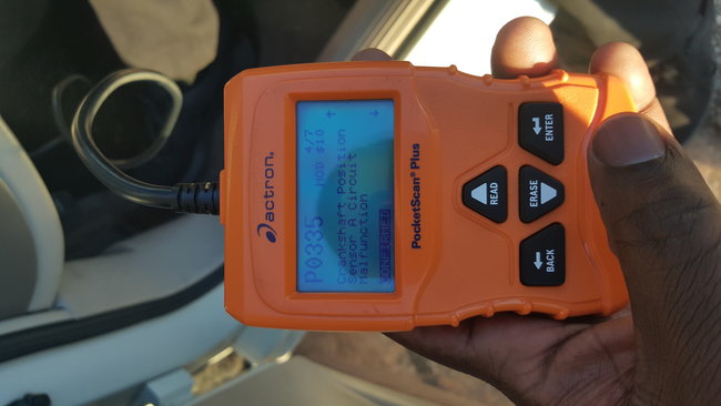

scn for codes at auto parts they do for free, get code and get back to us. you didn't send engine size so pic is for 4.0l 3.5l is above starter.if code is 335 or 336 then it's crank sensor.
Jan 14, 2017 at 11:30 PM
TRAVB
Hey! Engine size is a 3.5l and here are pics from the check engine. Got both these codes.
Jan 24, 2017 at 6:29 AM
HMAC300
  • 48,601 POSTS

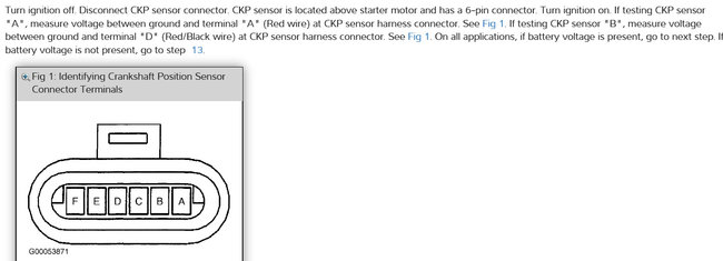

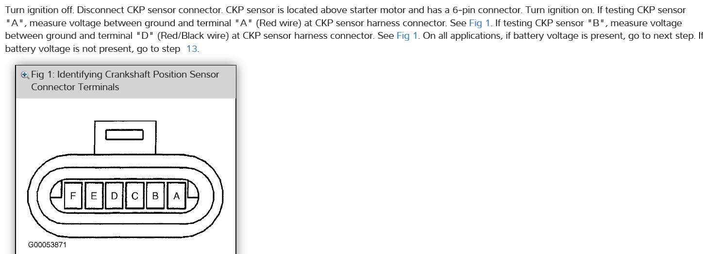

well one of the codes is crank sensor 385 is also crank sensor see pic on how to see if it's bad which it probably is.
Jan 24, 2017 at 7:10 AM
TRAVB
Ok. Thanks. Now how do I measure the voltage that's stated in the pic?
Jan 24, 2017 at 7:13 AM
HMAC300
  • 48,601 POSTS
just like it says turn key on andmeasure at the points it mentions in pic one lead to ground other to a or what ever one you are checking on harness
