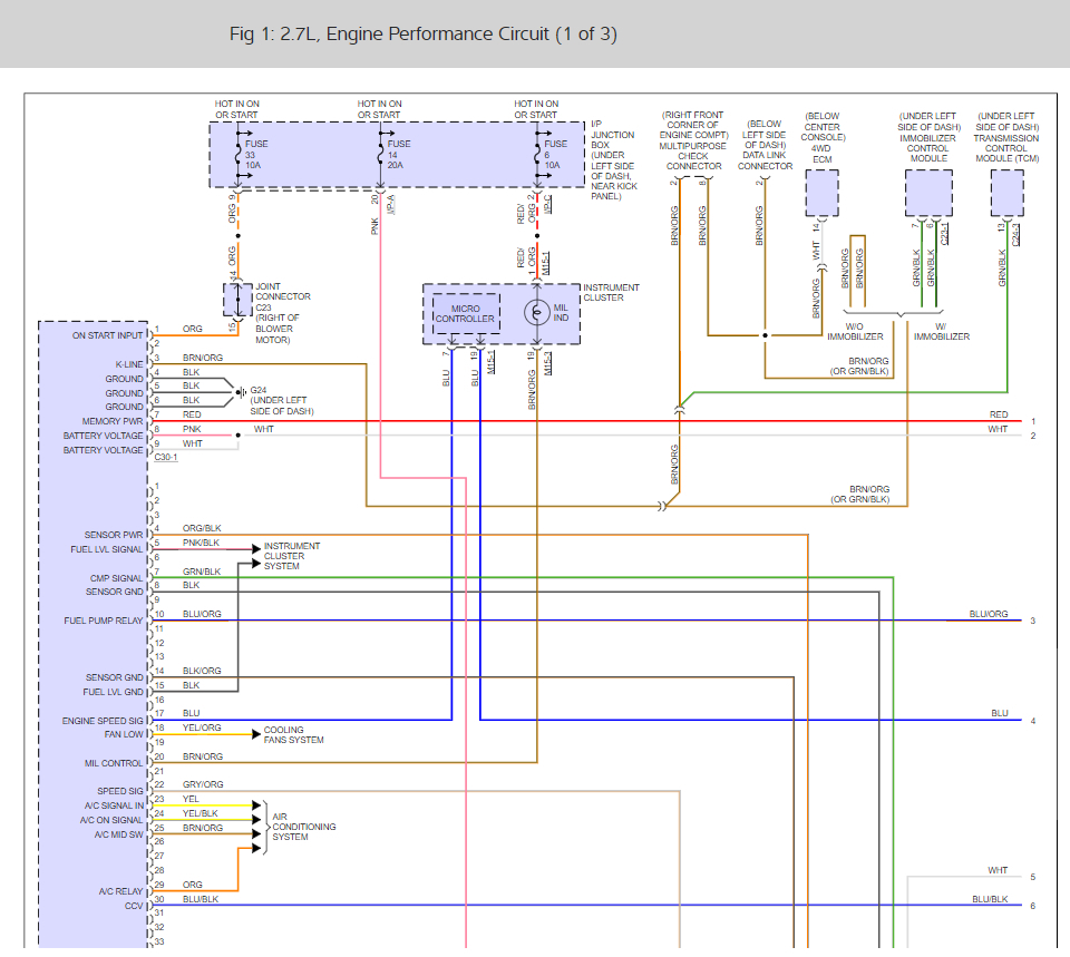

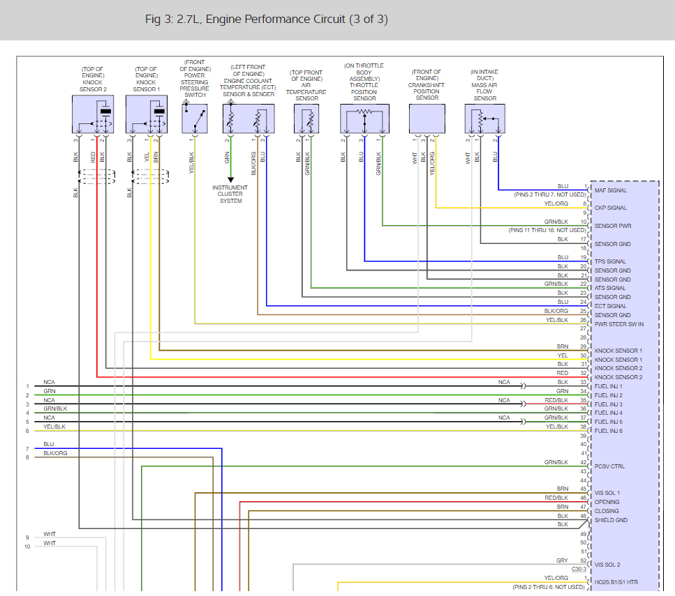

Condition: Vehicle was running fine. I stopped to check mail after thirty kilometer trip (left it running) and noticed a slight rough idle. Drove vehicle half kilometer backed into driveway, shut down. Attempted to remote start five days later, vehicle cranked fine but would not start. Further attempts failed.
I attempted to start in warmer and dryer weather with the same results.
Security/remote start system has been problematic in the past but has never caused a no-start condition. Remote was installed by Hyundai in 2007 to 2008. Suspect factory security inhibitor?

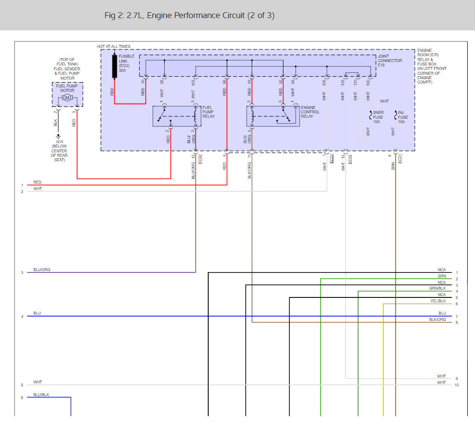

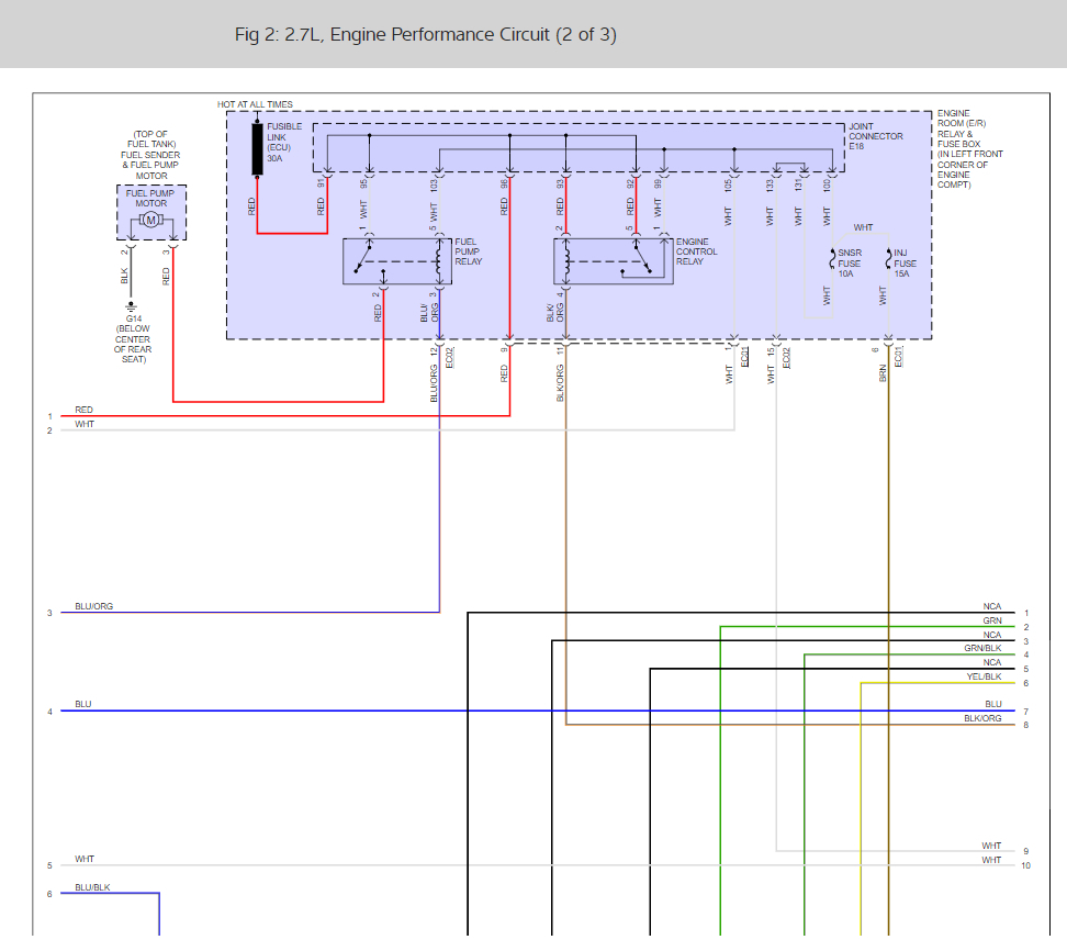

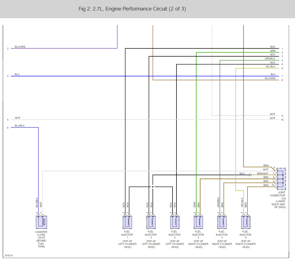

1) Fuel pump will intermittently purge with key in on no start position. Will not purge while cranking engine. By passed relay which activated pump delivering fuel to injector rail. Replaced fuel pump relay with equivalent with same results.
2) Spark, no.
3) Injector pulse, no.
4) Check hood switch, okay.

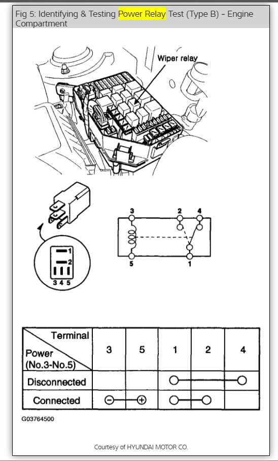

5) Check fuses and relays, okay (under hood and in cab).

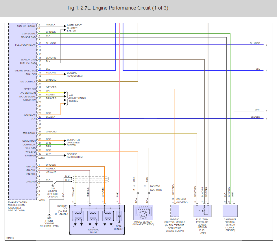

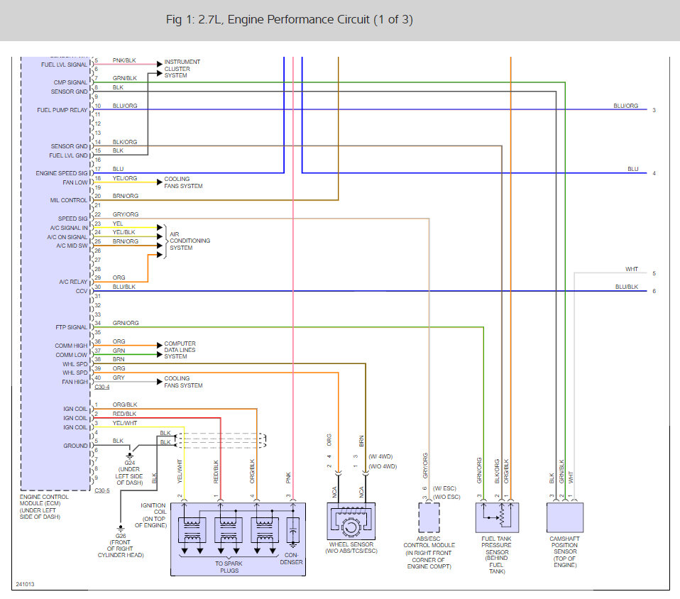

6) Replaced CPS (three prong harness engine side prong one Ground good, prong two or center five volts and prong three no volts).
7) Injector wire harness engine side, 4.3 volts K on EO, .63 volts on other. Not switching.
Have tried every security reset on the web.

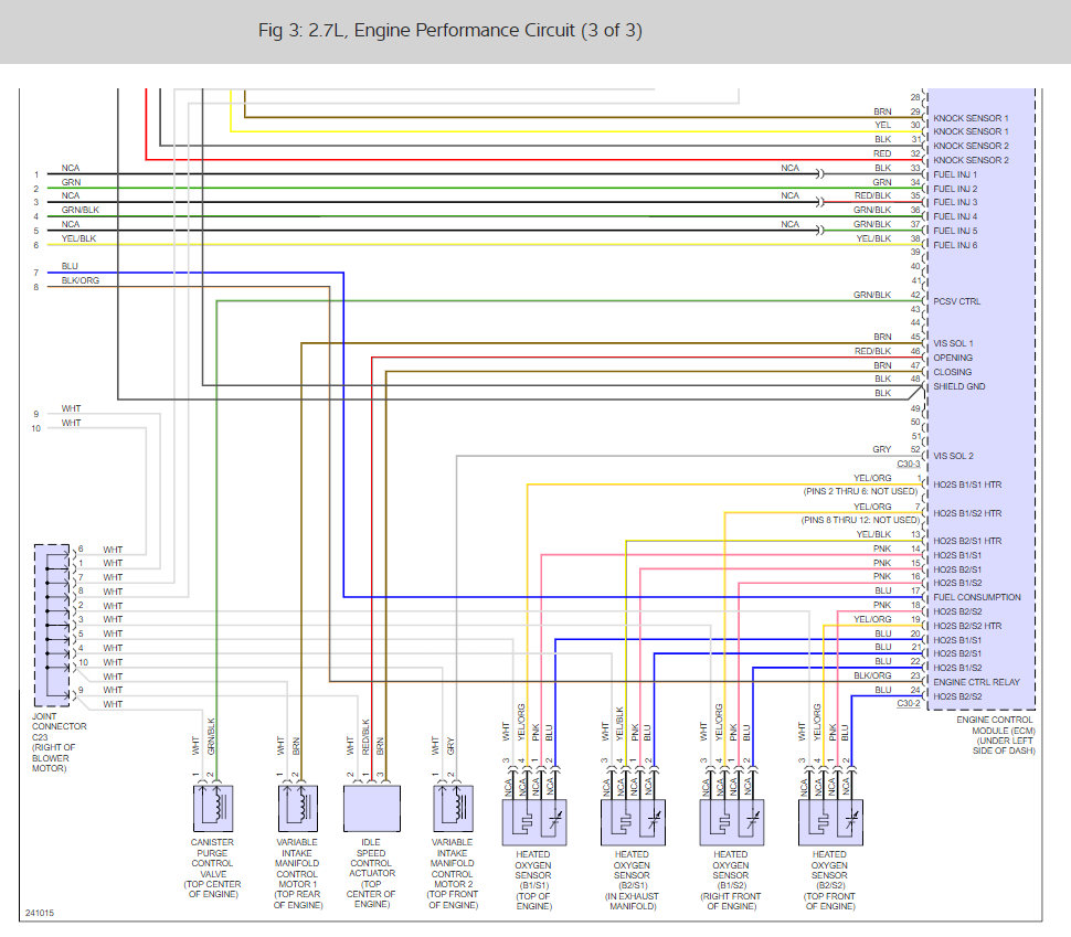

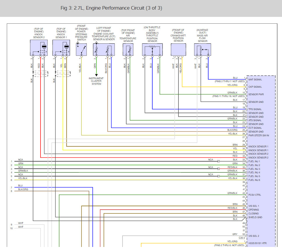

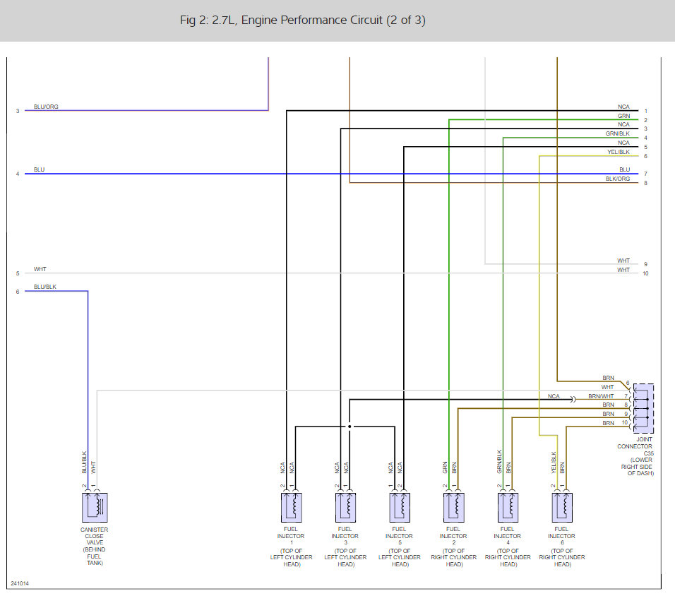

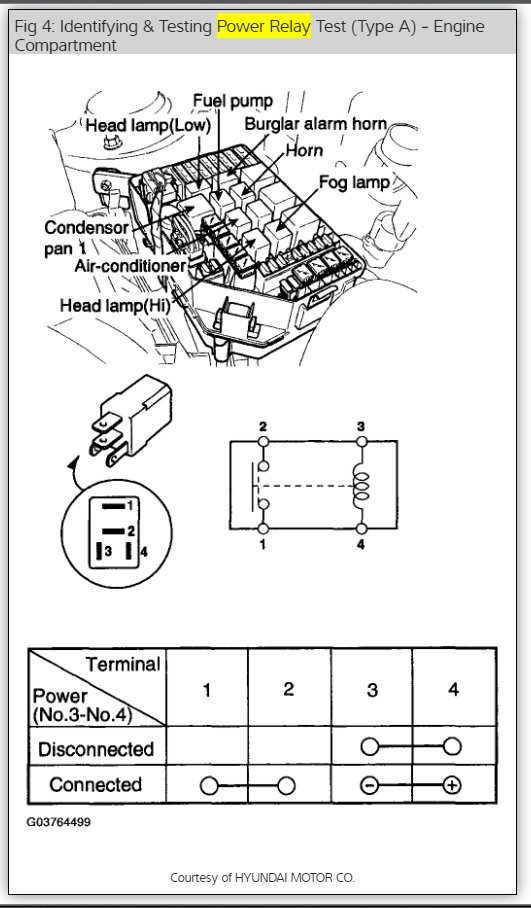

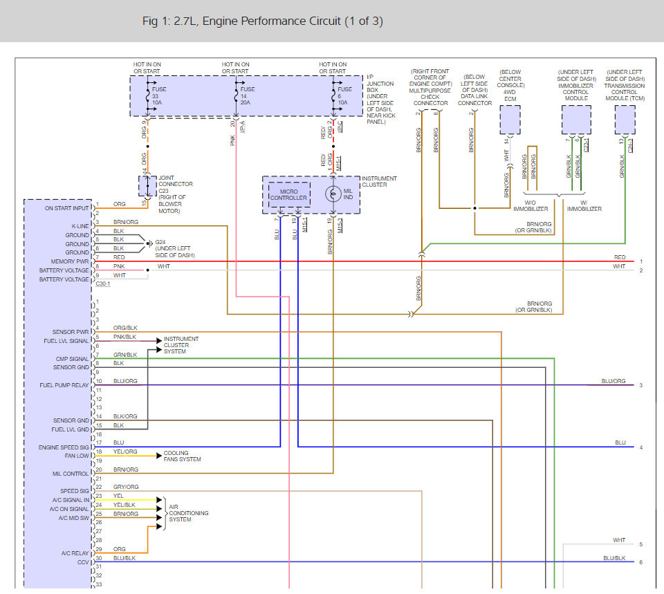

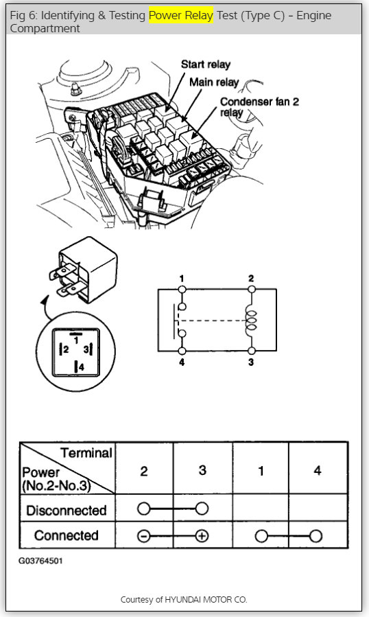

When you are cranking the engine over is the security light flashing? If not it sounds like the engine control module is not powered up. I know you said you checked the relays and fuses but I would double check them especially the main relay. The injector supply voltage should be 12 volts not 4.3 so I am thinks we are missing a voltage supply to the module or the PCM is bad.
Here are some guides and diagrams to help you do some testing.
and
(Diagrams Below)
Please let us know what you find. I'm interested to see what it is.

Hello Ken its Ken. Thanks for getting back. As long as I have owned this enigma of a vehicle I have never seen a security light of any kind. I took your advice & rechecked to no avail. I forget to mention that the MIL Lt illuminates KO, no codes with CTC scanner and checking main power wire from relay to/at ECU has 12V. I'm not feeling too good about that ECU, but I am not a believer in throwing parts at something till it's fixed. Thank you for the schematics. After leaving DND free tech info is hard to come by. I will send an update on the outcome.
