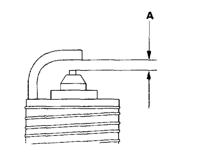

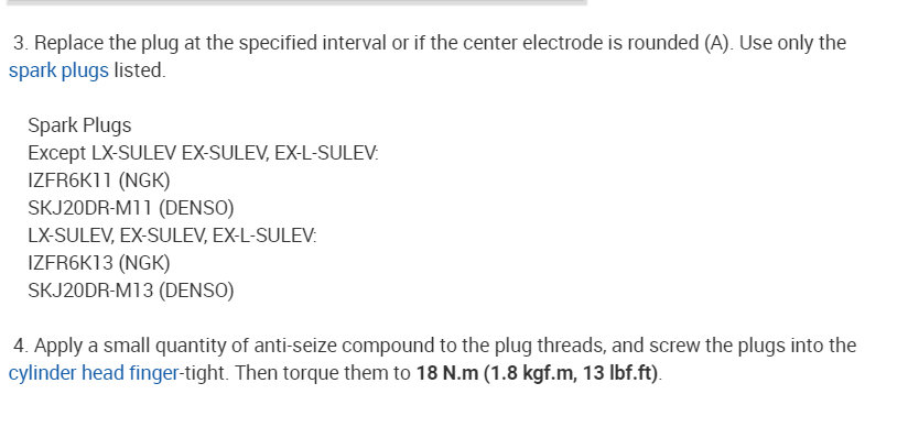

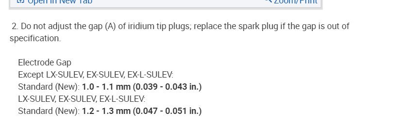

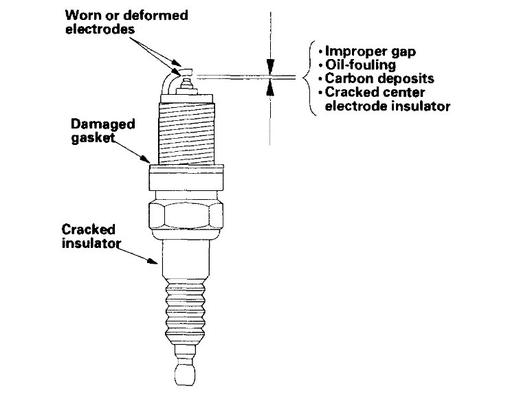

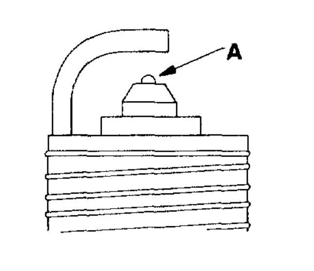

Car just started becoming hard to start meaning it would turn over for a length of time and I would have to repeat the starting procedure several times before it would start now wont start at all. Checked for fuel pressure its good checked for spark and it is very weak. This is after I changed the CPS. It actually tries to start when I let off the key almost like a security issue, but there is no key flashing once it turns over and there are no codes. Although it did have a random misfire code last weak and I did nothing to correct it because the code was cleared unintentionally and it never reset a check engine light. I checked relays. I am out of bullets can anyone help'
Sunday, May 19th, 2019 AT 1:45 PM
17 Replies
SCGRANTURISMO
  • 4,897 POSTS

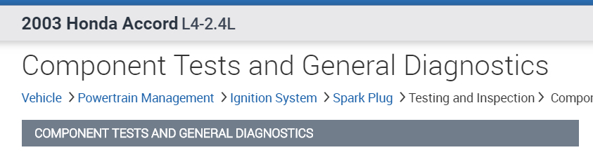

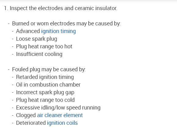

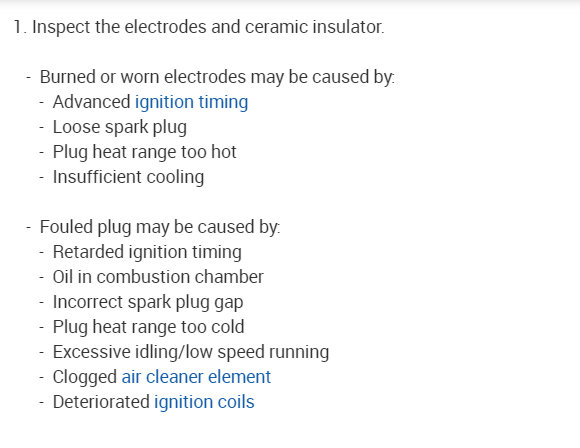

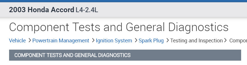

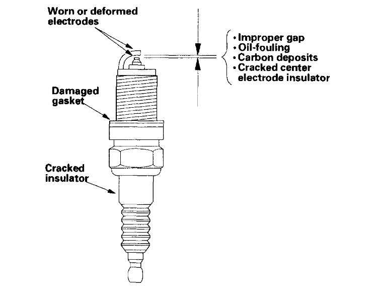

This could be a problem with the Coil On Plug (COP)(s) or the spark plug themselves. Your vehicle's Power-train Control Module (PCM) controls the coils by taking away the ground from them inducing the windings in the coil to release the electricity stored in them. So a weak spark can only come from either the coils or the spark plugs. So let's start with the spark plugs. In the diagrams down below I have included the factory guide for inspecting your vehicle's spark plugs.
When you turn the key to the on position without cranking the engine over can you hear the fuel pump run in the tank for 5 seconds?
Please go through this guide and get back to us with what you are able to find out. Check out the diagrams (Below). Please let us know what you find. We are interested to see what it is.
