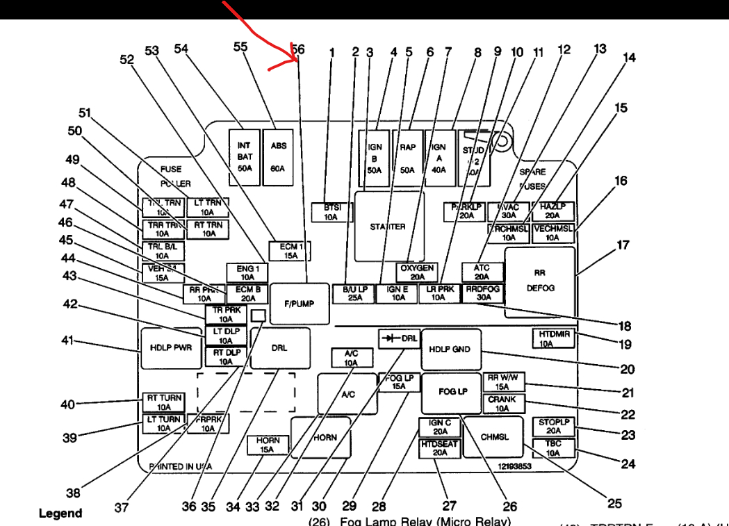

Turn the car off went back maybe 30 minutes later try to start it, it wouldn't start. could not hear the fuel pump kicking on. So, I replaced the fuel pump, checked all the fuses and the relays and they were fine. still won't start. I still can't hear the fuel pump kicking on. don't know if there's a shut-off switch because no one seems to do that.

It sounds like the fuel pump relay went out, here is the location so you can swap it out. Also, I have included a guide to go over.
https://www.2carpros.com/articles/car-not-running-advanced
Check out the images (below). Please let us know how it goes.
