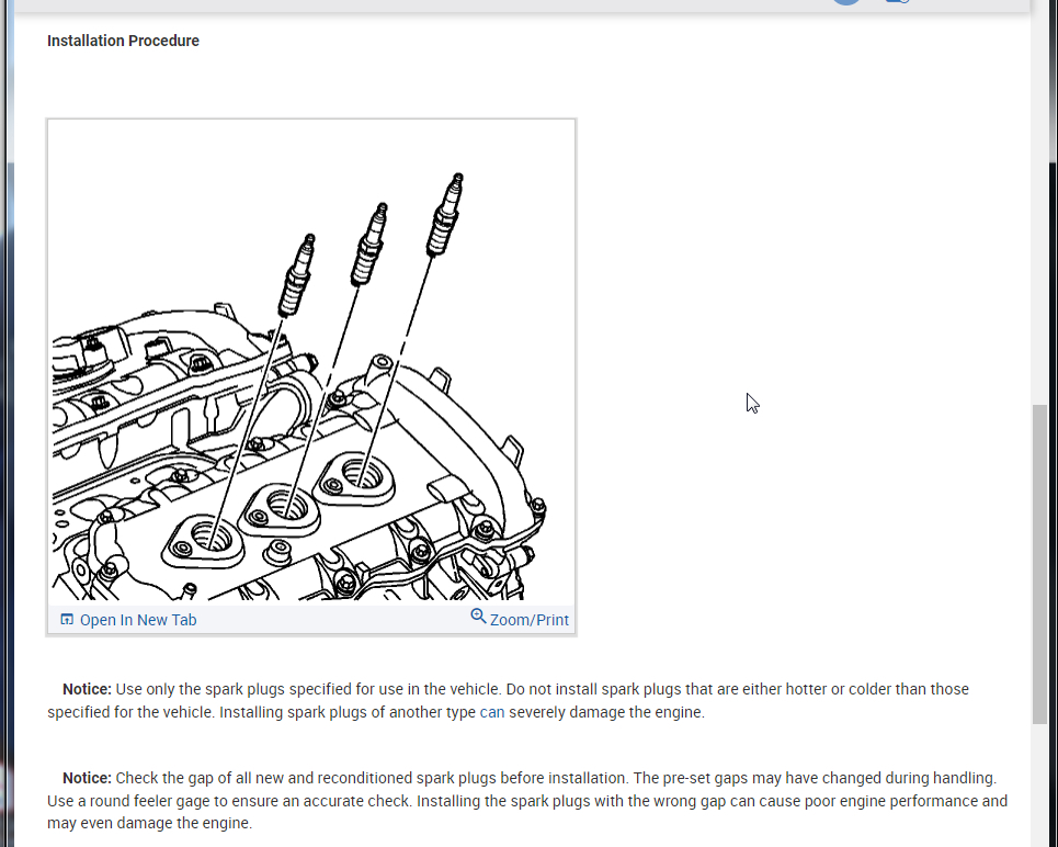

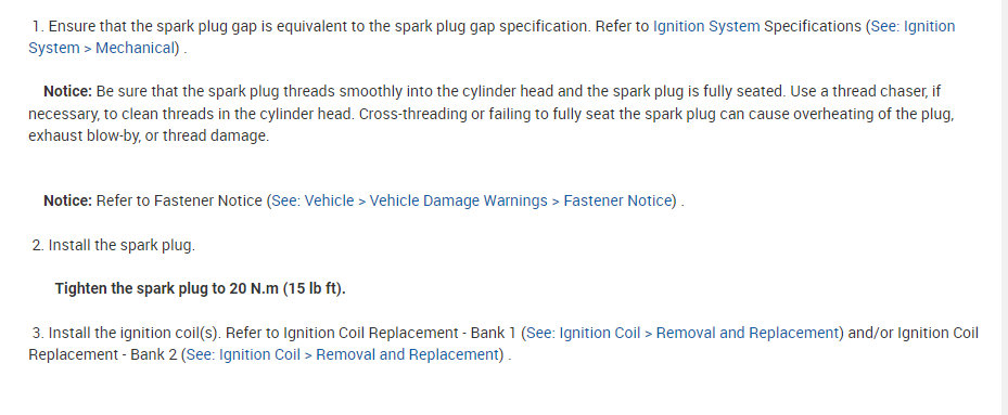

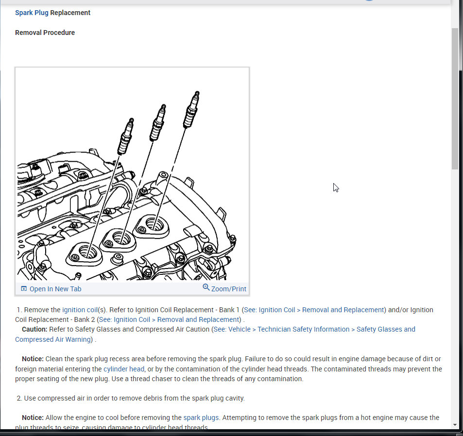

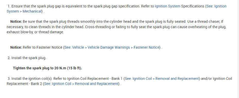

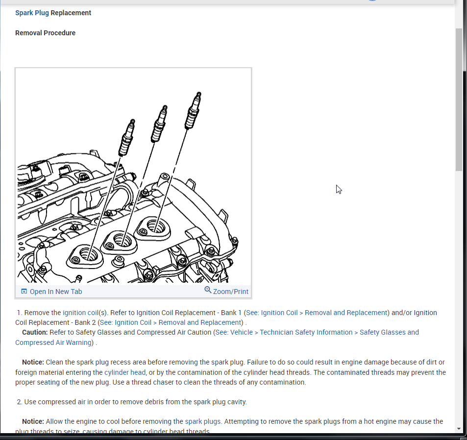

Next we need to pull a spark plug out and make sure it is not fouled. If you had a no start issue and the crank was the issue then it may have soaked the plugs and they are now failed due to fuel soak. So you may have fixed the issue but still have a no start because your plugs are fouled.
I would suggest changing the plugs and retesting. Here is a guide that will help with this. Plus I attached the info below on how to change them.
https://www.2carpros.com/articles/how-to-change-spark-plugs
Let me know if you have questions.
