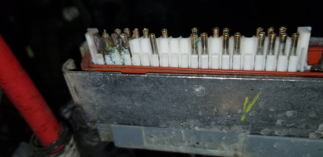

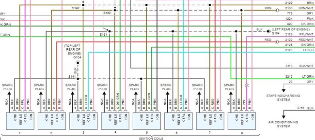

Several days ago the truck would not start. I checked the fuel pressure with tester and pump showed no PSI. I removed and replaced fuel pump with sending unit and I got PSI back. Shows between 55-60 PSI on pressure tester. After installing turned truck on and vehicle ran for two minutes and shut off as if power was cut off. I started truck back on and truck ran for about two more minutes and just cut off. Radio was still on so I know that I still had ACC. I still have the fuel pressure tester connected to fuel rail and it still shows fuel pressure is there. So I know it's not the fuel pump cutting off. I removed a connector going to fuel injector and checked for voltage while cranking up and it read 4.86 volts to almost 5 volts while cranking. I figured it was a bad crankshaft position sensor so I removed and replaced it and attempted to start the truck but it still only cranks but no start. The part states that I have to relearn it. I figured that the truck would of started after changing the crankshaft position sensor. Does the truck have to turn on in order to perform relearn procedure? I'm stumped and don't know which direction to go from here, any advice would be highly appreciated. Thanks

If pressure is good and you have an injector pulse, I need you to check for spark to the plugs. Here is a quick link:
To answer your question related to relearn, yes. The engine needs to run.

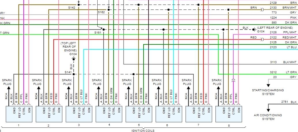

Now, if you find there is no spark, I think I know what is wrong. All of the coil packs have a common ground. The ground wire is black and is part of the wiring harness on the intake for the coil packs. The ground location is on the top left rear of the engine block. See the schematic I attached:
Locate the ground and check it's condition. Don't be surprised if the connector falls apart when you move it. Also, although the ground may be bad, it can still show continuity when checking. However, the ground can no longer take the current needed to fire the coils.
If you find the wire is good at its mount on the engine, work backwards from that point. If none of the cylinders are firing, it may be broken between the mount and the first coil pack splice.

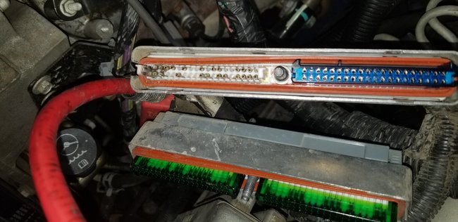

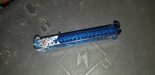

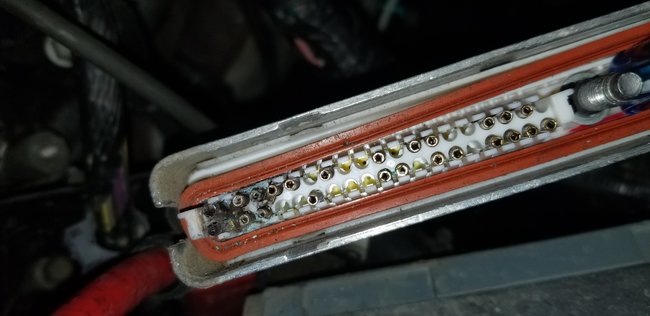

Thank you guys, I checked out those areas you recommended and all checked out good. I just gave up and took truck to dealership and had them check the vehicle and they found wires corroded in PCM due to water. When they removed wires going to computer they also found pin broken from PCM. I'm currently waiting for the repair to be done. I'll keep you posted of the outcome. They told me that when you get codes for knock sensors you need to replace them right away because more than likely they have water due to their location. They sit under the intake and absorb moisture and water. Total repair is close to $5,000.00. New PCM, new harness. I believe they said 18 hours of labor and around $2,000.00 in parts. I'll let you guys know the outcome. Thanks

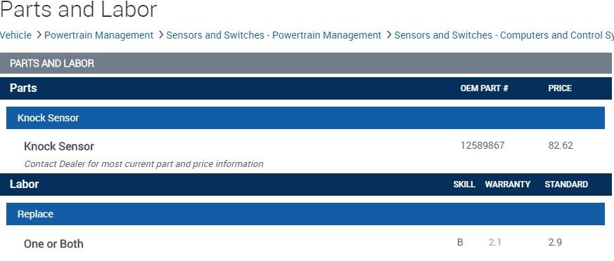

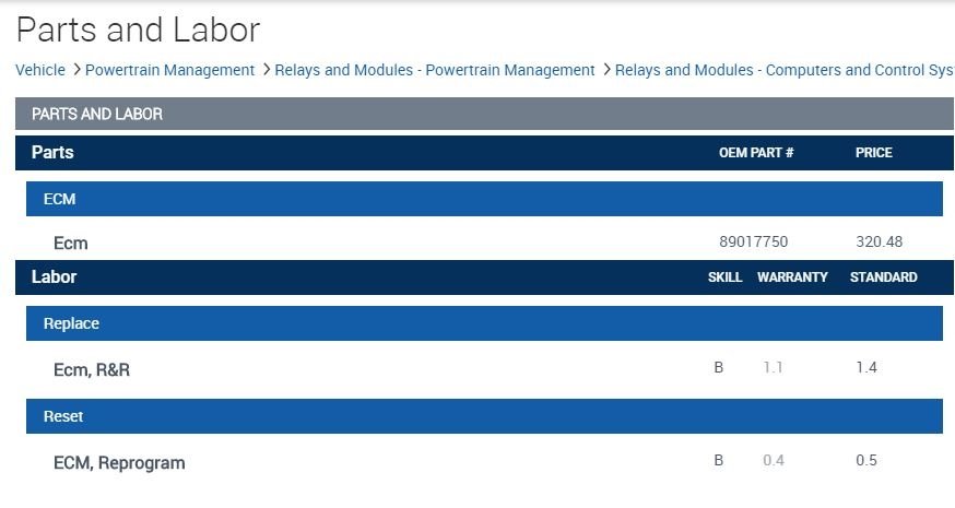

Wow. That's a lot. I'm not sure where you are located, so I have no idea of the labor costs. However, around here, I can't imagine it being more than $1,500.00.
I attached the flat rate hours for you to review and which also includes prices for the parts. Take a look at them and let me know if there is something I missed. I realize I didn't include a harness and labor to replace it, but.
