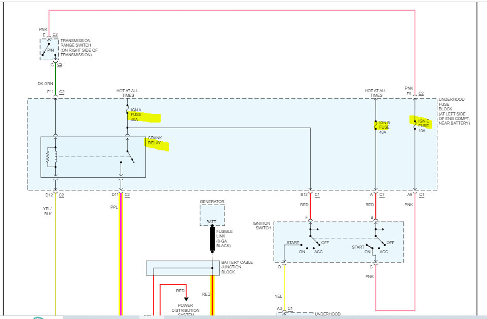

Hello everyone I have a 2003 H2 hummer it wont start, I did replace the starter still doesn't start and the battery cable is getting hot. when I try to start the car it makes a clack noise "clack clack" in the starter, but the engine wont turn. can any one help me with this problem they is no dealer here in the Congo to help me with this car I'm on my own. The only work we ever done on this car was the fuel injections. after that everything start going wrong with the car.

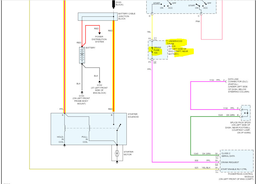

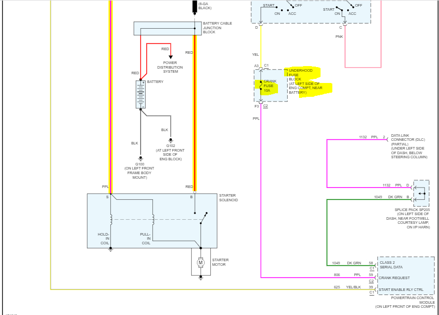

I attached the wiring schematic below, so you have a reference. (see pics 1 and 2) Note: There are 4 different fuses that will need to be checked and the starter relay. All are located in the under-hood fuse box.

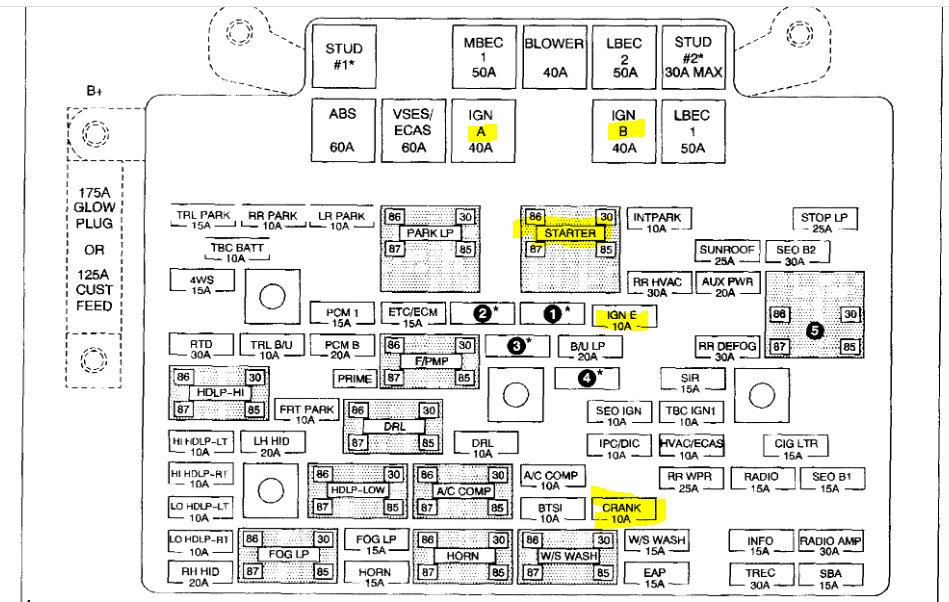

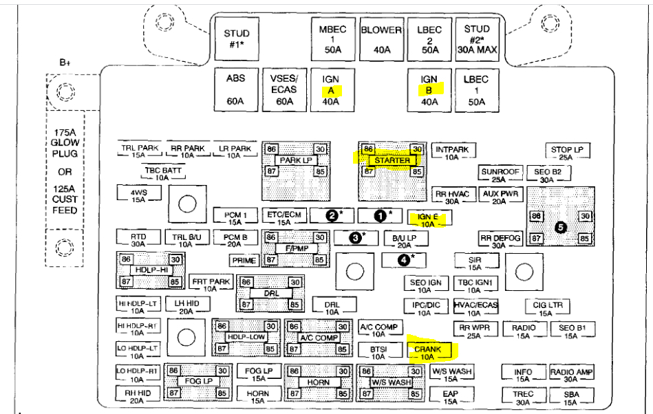

First, check ign fuses A, B, E, and the crank fuse. See pic three below for locations. In addition to checking them, confirm there is power to and from them.
Note: Ign E fuse will only have power when the key is in the start or run positions. The crank fuse will only have power with the key in the start position. So, you will need a helper to test them.
If they all test good, we need to check the relay. If there is a different one in the fuse box having the same part number, switch them to see if it makes a difference. If there isn't one, here is a link that explains how to test the relay and circuit.
Do this and let me know what you find.
