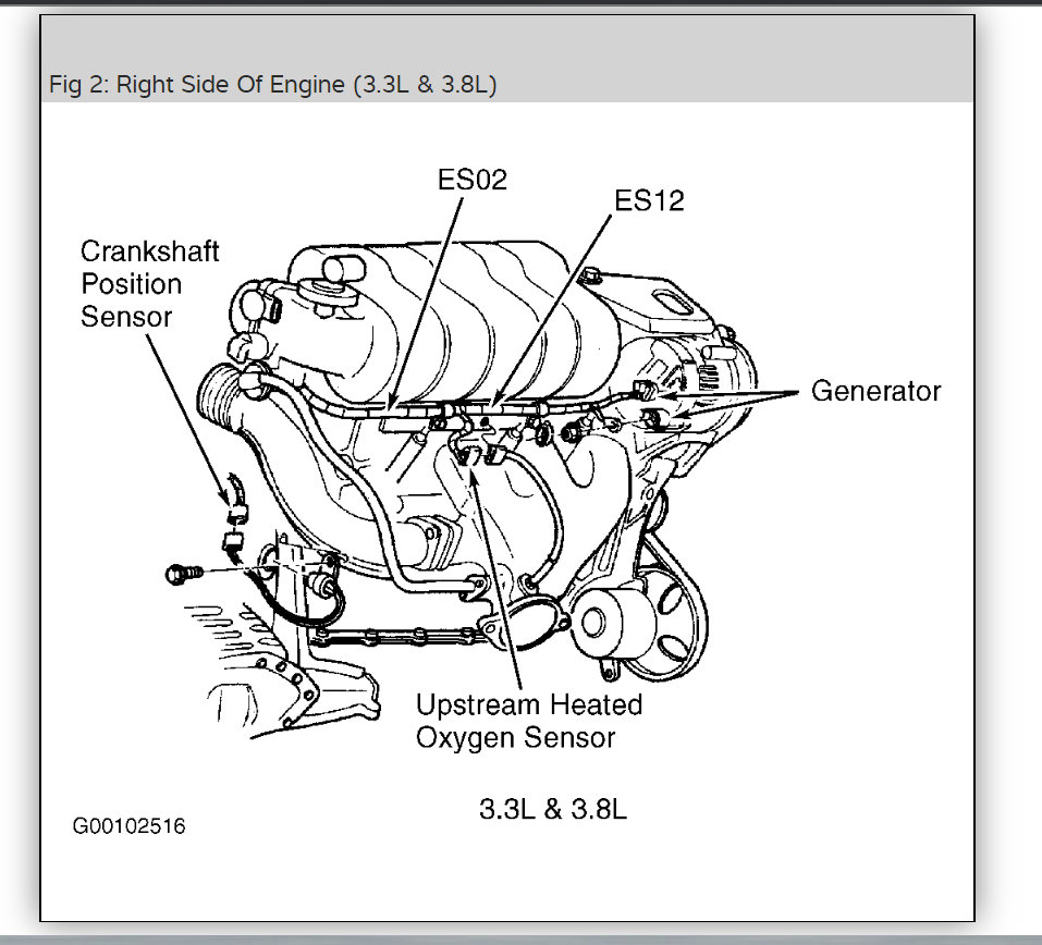

Cranks, no spark at plugs, no power at coil pack. Was running until it had run out of fuel. Now has fuel with 50psi at fuel bar and compression; still no spark. Tried a different coil pack but no change. Other activity on vehicle was changing a clock-spring due to horn going off even with nobody near vehicle!

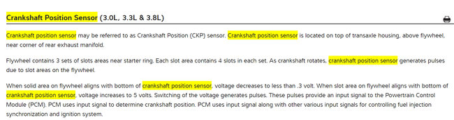

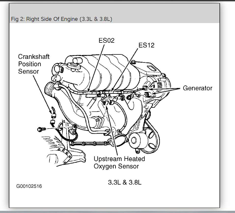

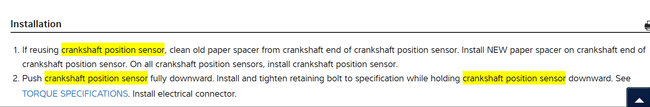

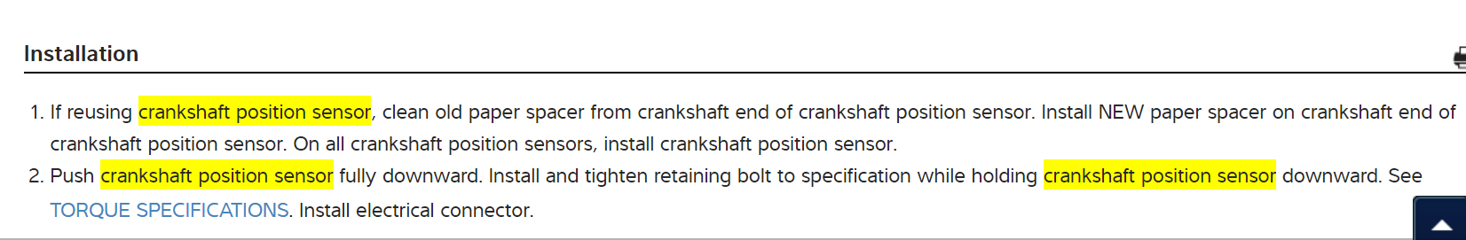

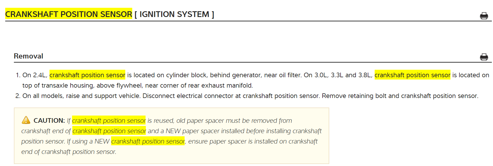

This could be a problem with your vehicle's Crankshaft Position Sensor (CKP). Your vehicle's Power-train Control Module (PCM) or "computer" uses the signal from the CKP to signal the fuel injectors and the spark plugs when to fire. Without this signal your vehicle will not start. In the diagrams down below I have included a description of your vehicle's CKP and instructions for the removal and installation of it. Please go through these guides and get back to us with how everything turns out.
Thanks,
Alex
