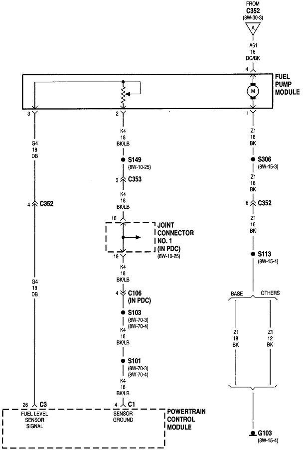

The truck hasn't started sense. it just cranks. I noticed fuel pump wasn't coming on so I bought a new pump .it also won't kick on.
I ran the new pump directly to the battery it comes on... but truck still wouldn't start...I tested the wire harness on the fuel pump with multimeter and only one prong was getting power and that is only 1.9 v.

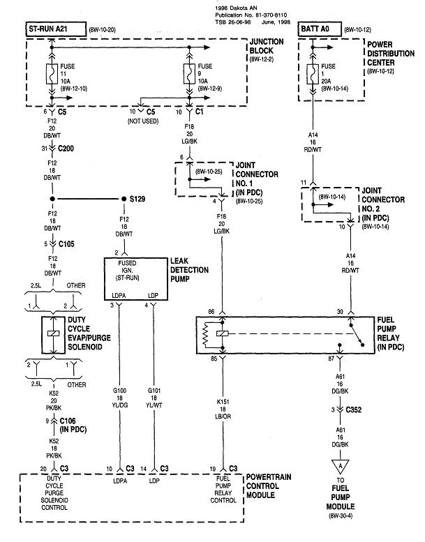

The first thing to be aware of is the fuel pump relay only gets turned on at two different times. The first is for one second right after you turn on the ignition switch. You may be able to hear the hum of the pump at that time. After that initial one second, the pump is turned off. That one-second burst is to insure fuel pressure is up for starting in case it bled down over days or weeks. If you put a fuel pressure gauge on the test port, you should find around 40 psi or more.
Next, the Engine Computer turns the fuel pump relay back on any time it sees engine rotation, (cranking or running). It knows that by the signal pulses it receives from the crankshaft position sensor and the camshaft position sensor.

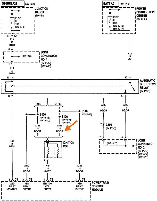

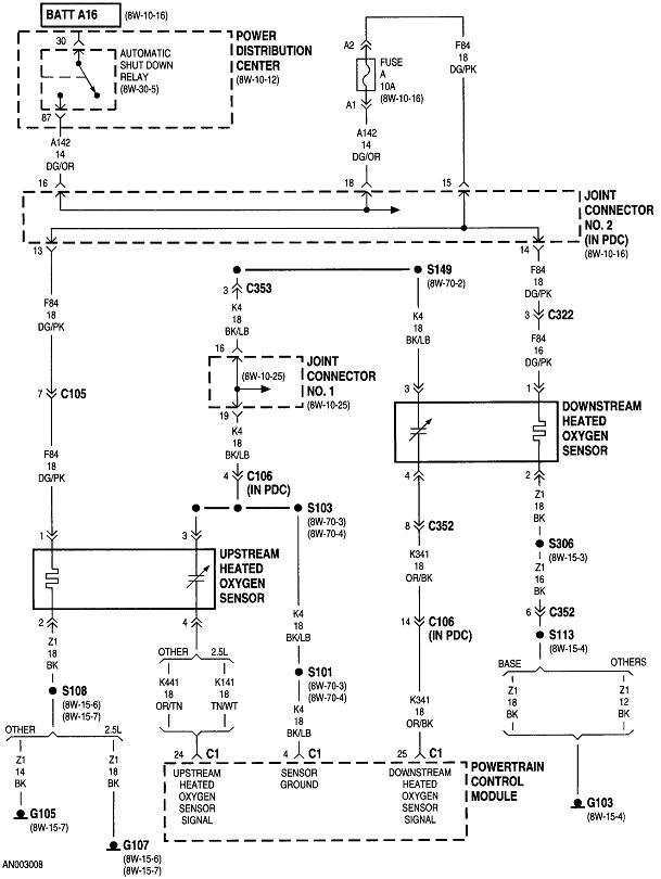

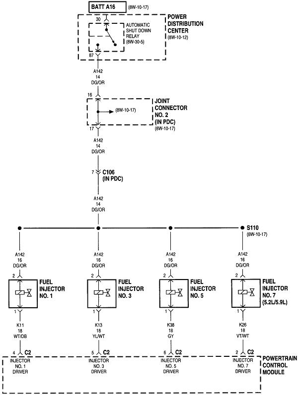

The Engine Computer also turns on the automatic shutdown, (ASD) relay at the same time it turns on the fuel pump relay. The ASD relay feeds the ignition coil(s), injectors, alternator field, oxygen sensor heaters, and a few other circuits. This circuit is the easiest one to use to check the operation of the cam and crank sensors. A test light works best for this next test. Digital voltmeters usually don't respond fast enough. For the benefit of others researching this topic who may need it, here's links to some articles on how to use a test light and voltmeter:
Both tools can be found at Harbor Freight Tools, Walmart, or any hardware store. Test lights cost around three or four dollars. The little red voltmeter from Harbor Freight Tools only costs $7.00 and works perfectly fine.

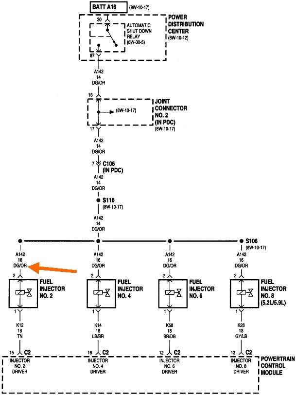

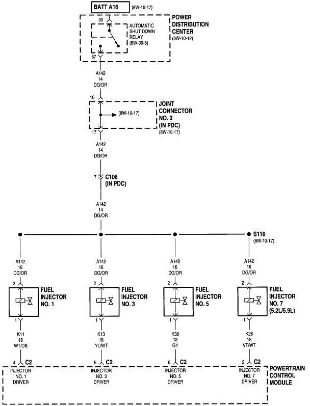

To check the operation of the ASD circuit, you can go to any of a number of places fed by that relay. The easiest may be the positive terminal on the ignition coil. You can also go to any injector and back-probe through the connector on the wire that is the same color at each of them. On most models that will be a dark green / orange wire. The orange arrow in the third diagram is pointing to that wire.
Don't worry if you don't know how to read these diagrams. I'm posting them in case we need them later. Connect your test light to that wire at the ignition coil or any injector. Have a helper run the ignition switch for you so you can watch the test light. You will see it light up for one second when the ignition switch is turned on. What's important is whether it turns back on when your helper starts cranking the engine.

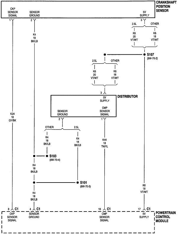

You already replaced the camshaft position sensor in the distributor, but that is only one part of the circuit. The best way to see if one of these circuits isn't generating its signal pulses is to view live data on a scanner. My Chrysler DRB3, for example, lists each sensor with a "No" or "Present" to show if the computer is seeing those signals. The one that stays on "No" during cranking is the circuit that has to be diagnosed.

Thank you very much for your detailed response but still can't figure it out .my automatic shutdown relay clicks when I turn the key on, I have a brand-new coil and it's getting power I put a light on an injector and got nothing I put a light spark plug to wire while my brother cranked and got nothing. like I think I said I get no pressure

You're confusing the issue with the other tests you're doing. For now, what is important is knowing what the ASD relay is doing. Don't worry about spark or fuel pressure yet. I think I'd prefer you go to an injector for this test. Back-probe the dark green / orange wire with the test light. Watch what it does when your helper turns the ignition switch to "run". The test light will turn on full brightness for about one second, then turn off. If that occurs, it proves the ASD relay, and its circuitry is okay and the Engine Computer has control of that relay. That eliminates well over half of the circuitry as possible suspects. After waiting a few more seconds, have your helper turn the ignition switch the one more click to the "crank" position. One of two things is going to happen. The test light will be on steady and full brightness, or it will remain off. If it flashes erratically, treat that as it's staying off.
In the less-likely event the test light turns on during cranking, which means signals are showing up from the crankshaft position sensor and the camshaft position sensor. The Engine Computer knows by those signals the engine is rotating, so it turns the ASD relay on and powers up the ignition col, injectors, and fuel pump. If the engine doesn't run, it's due to a loss of spark or a loss of fuel pressure, but not both.
More commonly, the test light will be off during cranking. The ignition coil, injectors, and fuel pump will be dead at that time. This is where we have to look at those cam and crank sensors. There's only three ways to determine which sensor isn't sending its signal to the Engine Computer. One is by finding a diagnostic fault code, but that didn't pan out here. If there was a code set, it got erased by disconnecting the battery. There isn't anything to "reset" by doing that. That thinking started with the very troublesome GM Engine Computers in the late '80s to mid '90s. And remember, even if you hadn't disconnected the battery, it takes some time for the computer to detect these missing signals, so there may not be a fault code set related to them even when one isn't working.
