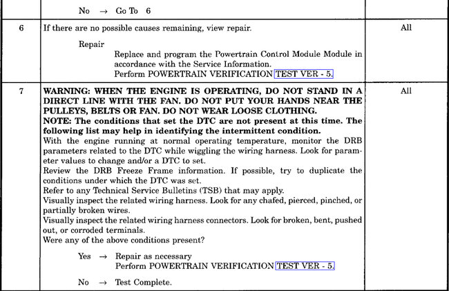

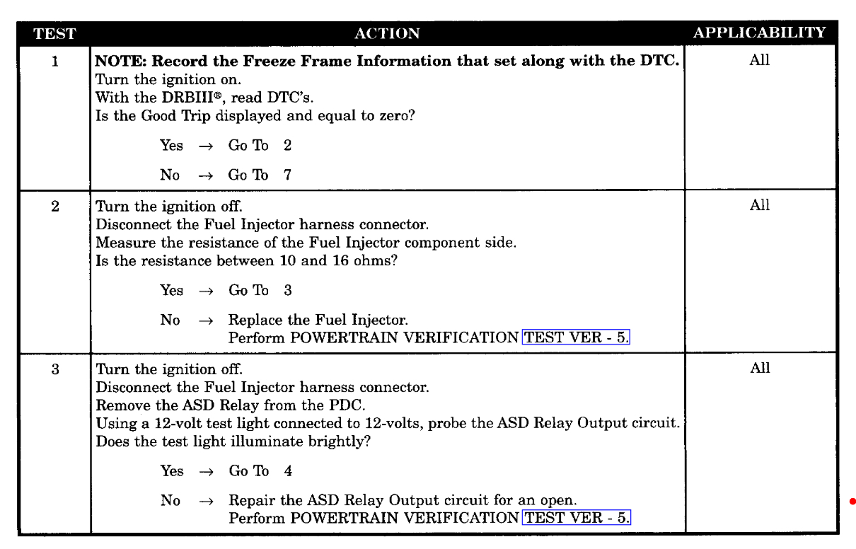

Hello and thanks for the response. The situation has changed a bit since my post. I got the van started and running but now out of nowhere I'm getting error codes p0202, p0204, p0205 injector circuit open for 2, 4 and 5. So the car runs really weak. Had no problems like that out of the van before only after we finally got it started after 16 days setting and replacing the programmed PCM. I've heard caravans are known for having shorts or melted harness but that's about all I know. Any insights PR guidance would be incredibly appreciated.

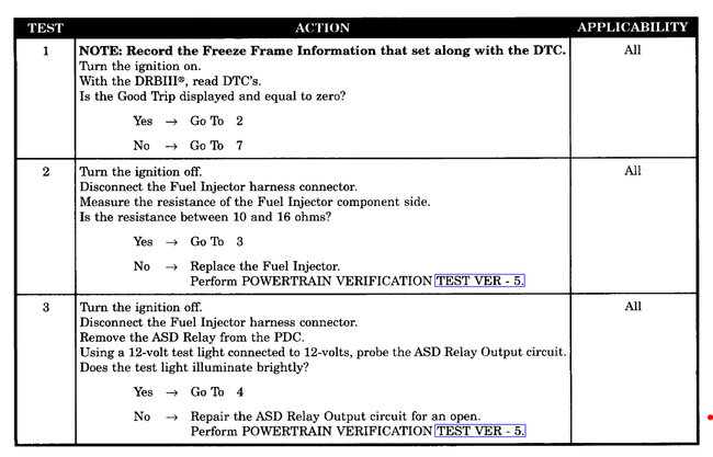

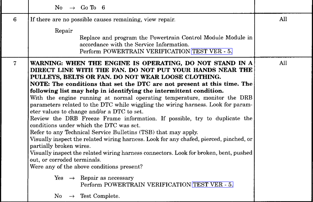

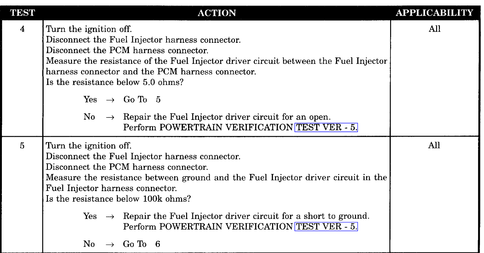

You are correct about the codes. It can be an open or a short. The thing is, it can also be a bad PCM, which you already replaced. Since every one of these codes contains the same possibility and it wasn't an issue prior, I suspect it is at the PCM harness. I am going to provide directions for the P0202. It is basically the same test for each of the codes just different wires are tested. Either something happened at the PCM connector (pushed in or bent pin, or you got a bad PCM. Here is a list of possible causes. When you see them you'll understand why I feel it is PCM or harness related. The others usually don't just go bad all at once especially 3 injectors at the same time.
Possible causes:
- ASD relay output circuit open
- Intermittent condition
- Fuel injector
- Fuel injector driver circuit open
- Fuel injector driver circuit shorted to ground
- PCM
The attached pics are a diagnostic flow chart for the P0202. Others are the nearly the same. If you determine the issue for this, you will have most likely found the problem for all three.
Take a look through the flow chart and let me know if it helps.
