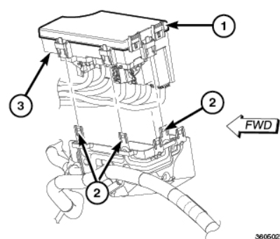

Only when my key is in on position it keeps the pump running continuously and won’t.
Oct 25, 2026 at 2:42 PM
  • 55,808 POSTS
Yep, this is common when the TIPM goes out. I would try to get a used one from ebay and swap it out. Here is the location. Disconnect the battery first.
Oct 26, 2026 at 9:29 AM

Not really, it is a circuit board set up inside the TIPM, you can try opening it up to see if anything is burnt.
Oct 27, 2026 at 8:05 AM
