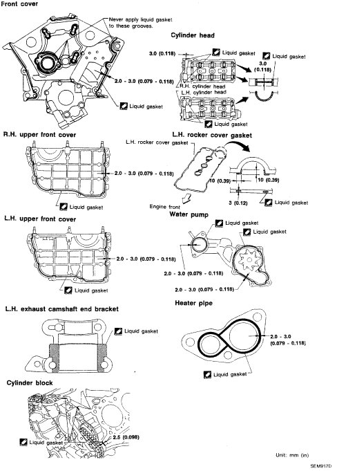

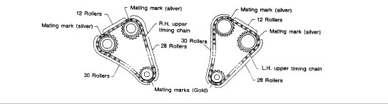

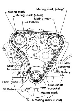

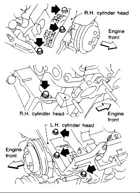

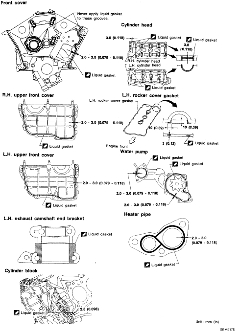

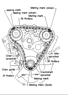

My car is the SE model. It will not start. It has gas and fire. What is the best way to check the timing with out pulling down the motor? Also, the motor is a 3.0 dohc.
Jun 12, 2018 at 2:04 AM
  • 110,248 POSTS
If you are concerned about timing, honestly the best way is to check the timing chain, but that would require removal of the timing chain covers and inspection. However, if you want, you could do a compression test. If the timing is off, the compression will most likely be low. Here are general directions for checking compression:
If you find that one of the three timing chains could be an issue, here are directions for removal and replacement. They are quite extensive, but can be done in the vehicle. The first twenty four pictures correlate with removal of the chains and water pump which I would recommend you do at the same time.

Here are the directions for replacement. The remaining pictures correlate with these directions.

Position lower timing chain on R.H. idler sprocket by aligning the mating mark on the R.H. idler sprocket with the silver mating mark on the lower timing chain.
Install L.H. idler sprocket with lower timing chain.
Line up mating marks on lower timing chain with mating marks on L.H. idler sprocket and crankshaft sprocket.
Install chain guide and chain tensioner.
Position upper timing chains on idler sprockets by aligning the mating marks on the idler sprockets with the gold mating marks on the upper timing chains.

Before installing front cover, remove all traces of liquid gasket from mating surface and grooves using a scraper and then completely clean any oil stains.
Also remove traces of liquid gasket from mating surface of cylinder block.
Apply a continuous bead of liquid gasket to mating surface of front cover.
Use Genuine Liquid Gasket or equivalent.
Wipe off excessive liquid gasket.

Before installing water pump, remove all traces of liquid gasket from mating surface and groove using a scraper.
Also remove traces of liquid gasket from mating surface of front cover and water pipe.
Apply a continuous bead of liquid gasket to mating surface of water pump.

Install cylinder heads with new gaskets.
Before installing cylinder head gaskets, apply a continuous bead of liquid gasket to mating surface of cylinder block.
Be sure to install washers between bolts and cylinder head.
Do not rotate crankshaft and camshaft separately, or valves will strike piston heads.
Tightening procedure:
Tighten all bolts to 39 Nm (4.0 kg-m, 29 ft-lb) .
Bolts of A type: Turn A bolts 65 to 70 degrees clockwise with Tool or suitable angle wrench.
Bolts of B type: Turn B bolts 70 to 75 degrees clockwise with Tool or suitable angle wrench. If angle wrench is not available, tighten all bolts to 123 Nm (12.5 kg-m, 90 ft-lb)
Loosen all bolts completely.
Tighten all bolts to 34 to 44 Nm (3.5 to 4.5 kg-m, 25 to 33 ft-lb) .
If angle wrench Is not available, tighten all bolts to 118 to 127 Nm (12.0 to 13.0 kg-m, 87 to 94 ft-lb).

Before installing L.H. exhaust camshaft end bracket, remove all traces of liquid gasket from mating surface, and then completely clean any oil stains.
Also remove traces of liquid gasket from mating surface of cylinder head.
Apply a continuous bead of liquid gasket to mating surface of L.H. exhaust camshaft end bracket.

Line up mating marks on R.H. upper timing chain with mating marks on R.H. V.T.C. assembly and R.H. camshaft sprocket.

Line up mating marks on L.H. upper timing chain with mating marks on L.H. V.T.C. assembly and L.H. camshaft sprocket.

Before installing R.H. and L.H. upper front covers, remove all traces of liquid gasket from mating surface and groove using a scraper, and completely clean any oil stains.
Apply a continuous bead of liquid gasket to mating surface of R.H. and L.H. upper front covers.
Install R.H and L.H. upper chain guides.
Install R.H. and L.H. rocker covers.
Before installing rocker covers, remove all traces of liquid gasket from mating surface of rocker cover to cylinder head, and then completely clean any oil stains.
Apply a continuous bead of liquid gasket to mating surface of rocker cover gaskets and cylinder heads.
