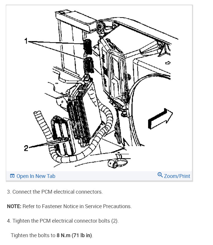

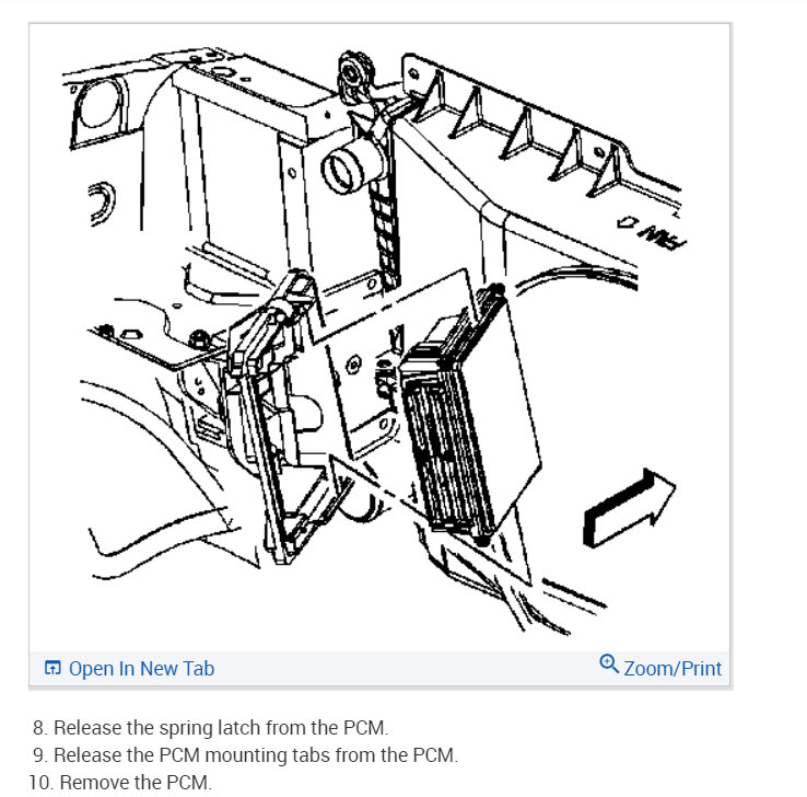

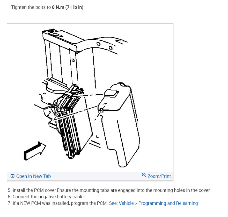

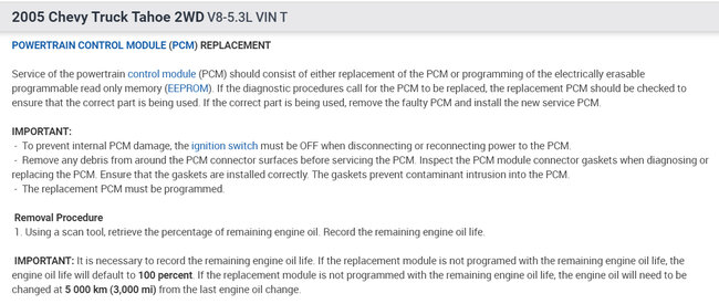

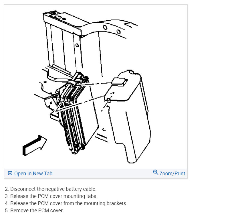

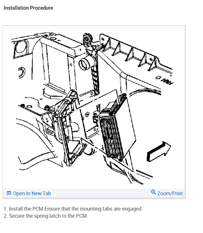

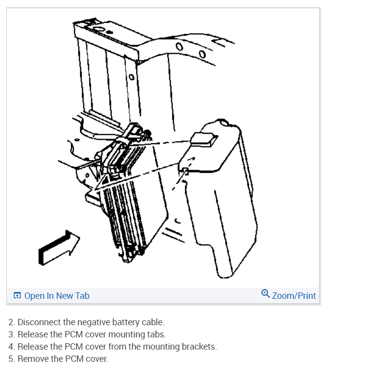

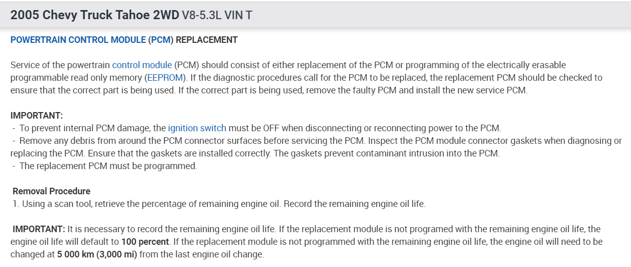

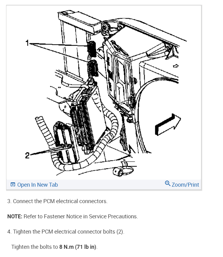

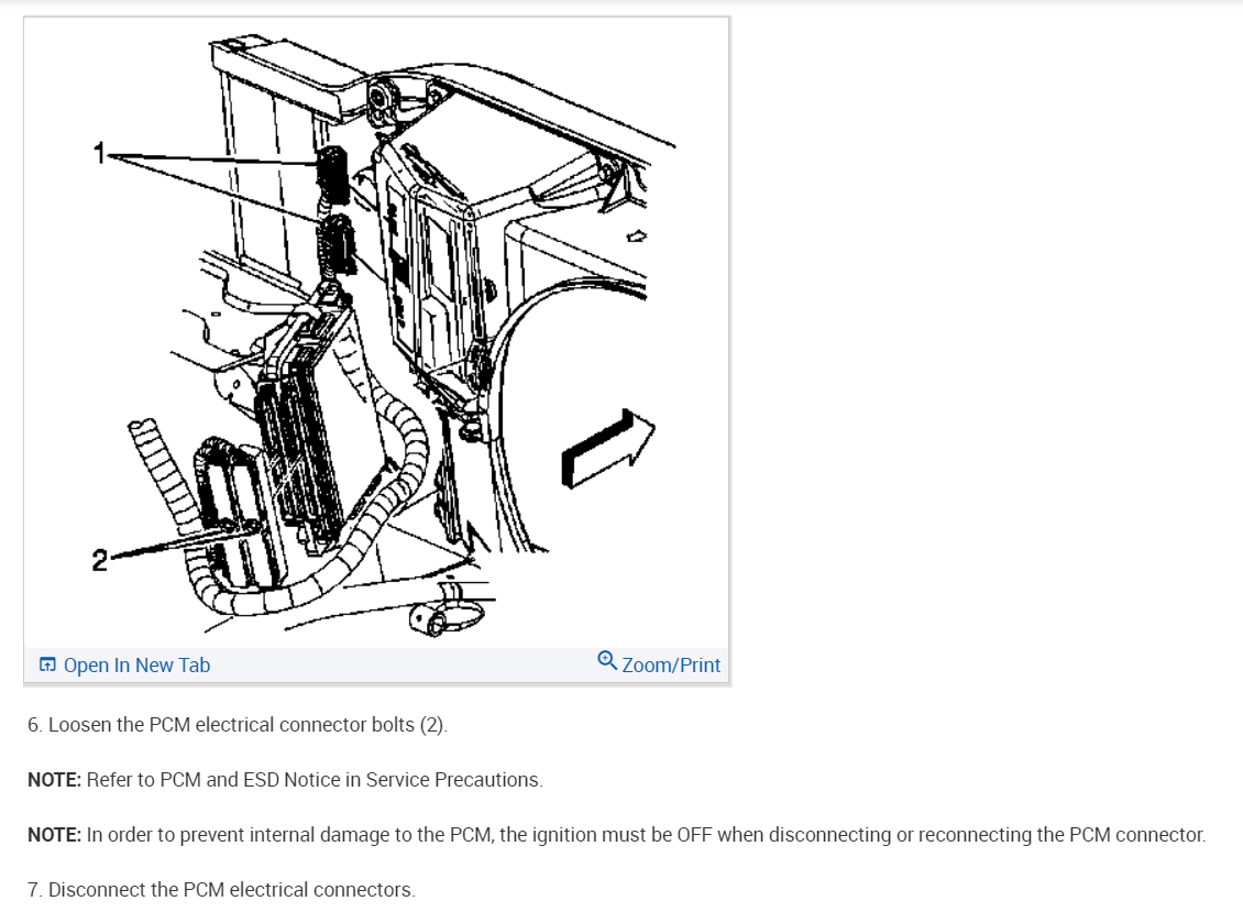

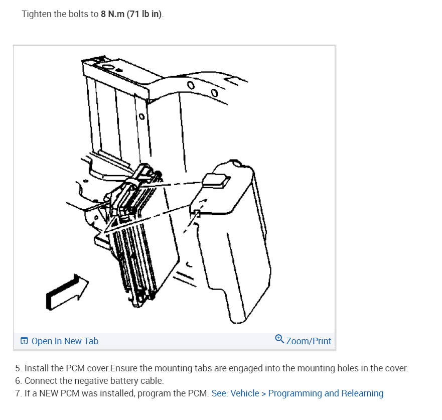

Here is how to change out the PCM in the images below. You can get a rebuilt unit by searching Google or eBay. Check out the images (below). Please let us know what happens.
