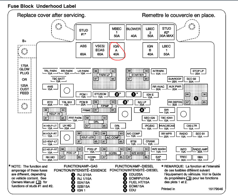

Cranks no start no spark to the plugs
ERIC KING2
  • 2003 CHEVROLET SILVERADO
  • 5.3L
  • V8
  • 2WD
  • 153,000 MILES
Engine turns over but will not start. I can hear the fuel pump prime, but do not have spark to plugs.
Friday, December 16th, 2016 AT 6:37 PM
SQM
  • 6,383 POSTS

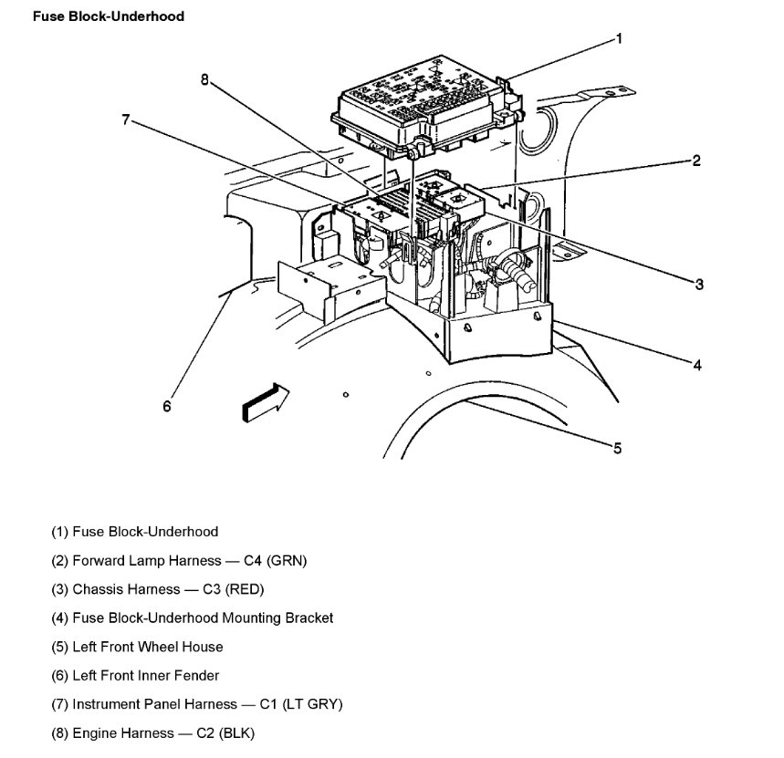

A no spark will happen for a faulty ignition control module.
It can even happen due to a bad crank sensor.
There is also a ignition relay for this vehicle that can trigger no spark as well.
First item need to be checked is the ignition relay under the hood fuse block (see diagram).
If the relay is good check the control module.
