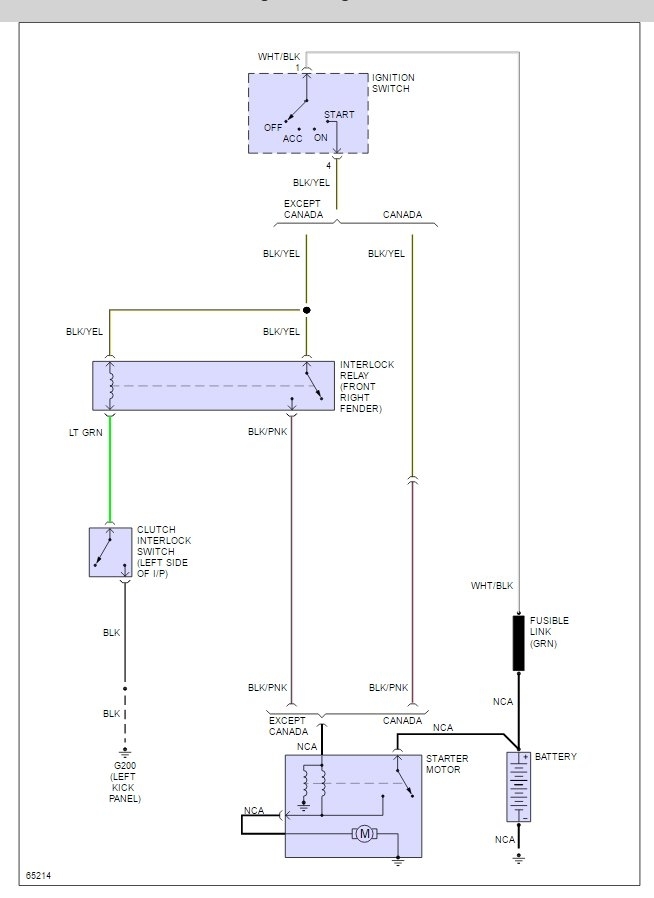

Okay, so i got battery charged and did a lot of code fixes. i changed coil cap and button on distributor getting fire now. no fuel it is not fuel pump tested pressure and have well within specs fuel pressure. i am leaning more on electrical issue was reading a post about bad ground at ignition switch. so i decided pay sixteen bucks why not so i replaced apon switching out, i noticed some one rigged a wire on the green and black wire. it is the one that is only hot when key is turned to engage the starter. so i chased the wire to the starter solenoid it turns over fine, but i am now getting no fuel out of the injectors. Are these two components connected? if so how do i go about testing this out? i have a multi-meter and test light to work with so be easy on me. lol, thanks in advance.

Hey JOSEPH,
There is an interlock relay that goes bad in those car, here is a guide and a diagram that will help you get the problem fixed.
and
Run some tests and get back to us so we can continue helping you.
Best, Ken

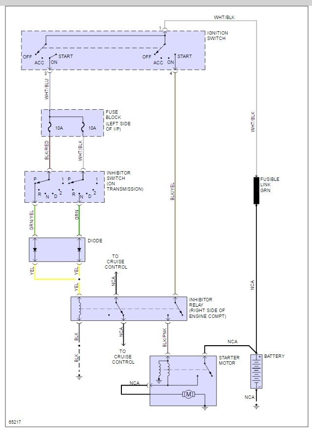

Is that only for nissans with standards cause i have an automatic transmission

Hey Joe,
My bad, here you go.
Let me know who ti goes.
